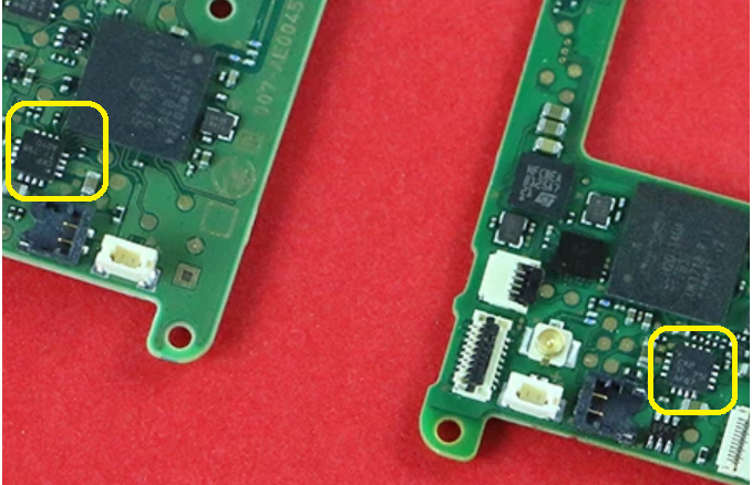

Hello! I'm having trouble with the motion controll on one of my joycon... I've tried to update, clean and restart the joycon but with no change... can I use this program to check the issue? anybody knows a tutorial to see if I can replace de gyroscope? Thanks!! :)
I don't think is a easy task, the gyroscope is a very tiny chip on the joy-con MainBoard:
