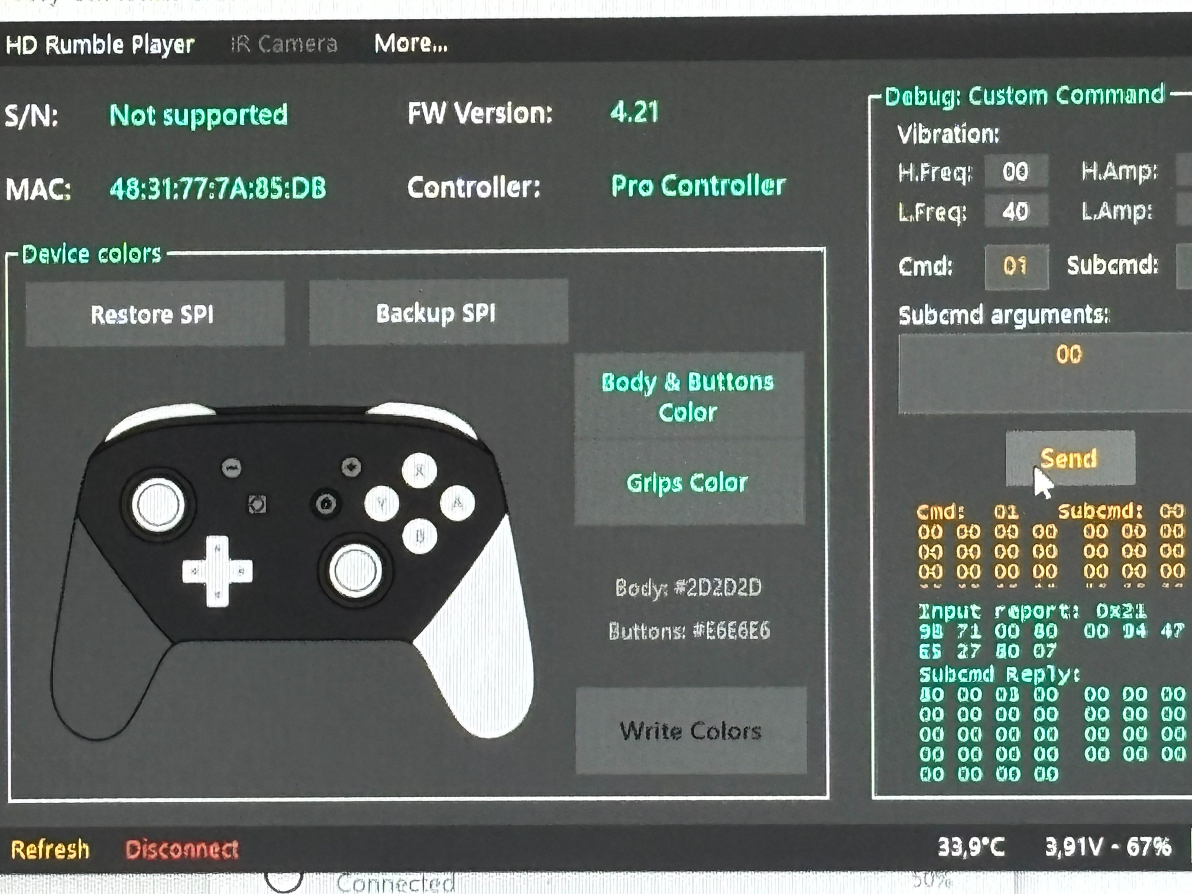

Hi all, bought a Tears of the Kingdom Pro Controller secondhand for €27.50 and spent a few hours running through authenticity checks. Here’s everything I found:

• Serial shows “Not supported” in jc-toolkit AND blank in Switch system menu (System > Serial Information) — this is the main concern

SPI dump is attached. Can anyone check whether the dump looks like genuine Nintendo factory output, and specifically whether the serial address is zeroed out or contains something?

Being able to update the firmware and use the Amiibo NFC reader almost certainly makes this a genuine controller.
Those are things that the fake controller were not able to do.
This information suggests that the serial number can be blank :
https://github.com/dekuNukem/Nintendo_Switch_Reverse_Engineering/blob/master/spi_flash_notes.md
The value of x6000 of you SPI dump is xFF so that would indicate that it has no serial number.
Note that other pro controllers also show 'Not Supported' :
https://github.com/CTCaer/jc_toolkit/issues/28
So maybe Pro controllers do not have a serial number.
These special version Pro Controllers do suffer more from drift and other issues than regular Pro controllers.
A lot of people were complaining with some users mentioning they were experiencing drift right out of the box.
