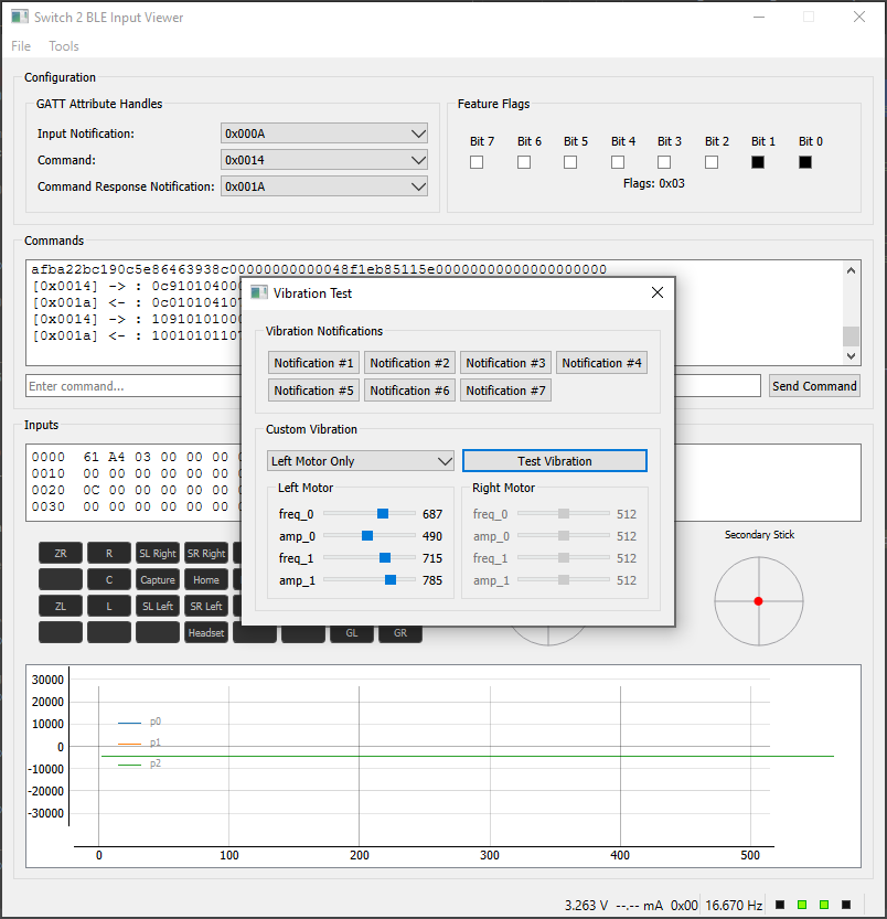

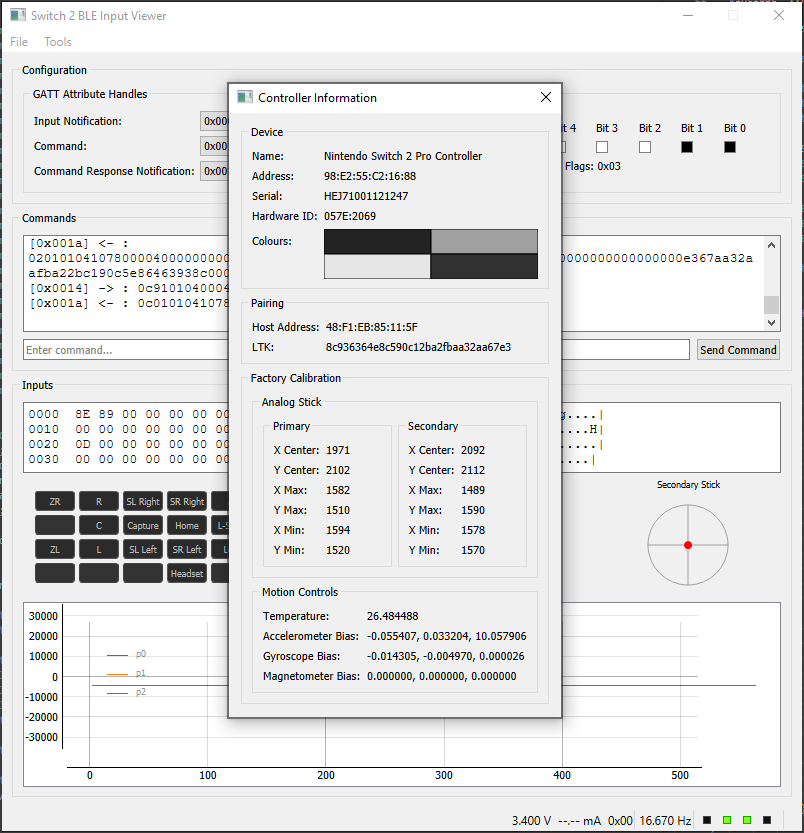

I hacked together a python GUI for experimenting with switch 2 controllers. It's a little rough around the edges, and not intended to be equivalent to JC Toolkit, but there is probably a bit of overlap in features.
Note that the onboard memory of the new controllers is mostly read-only now, so we can't edit factory data such as controller colours or calibration data anymore.
