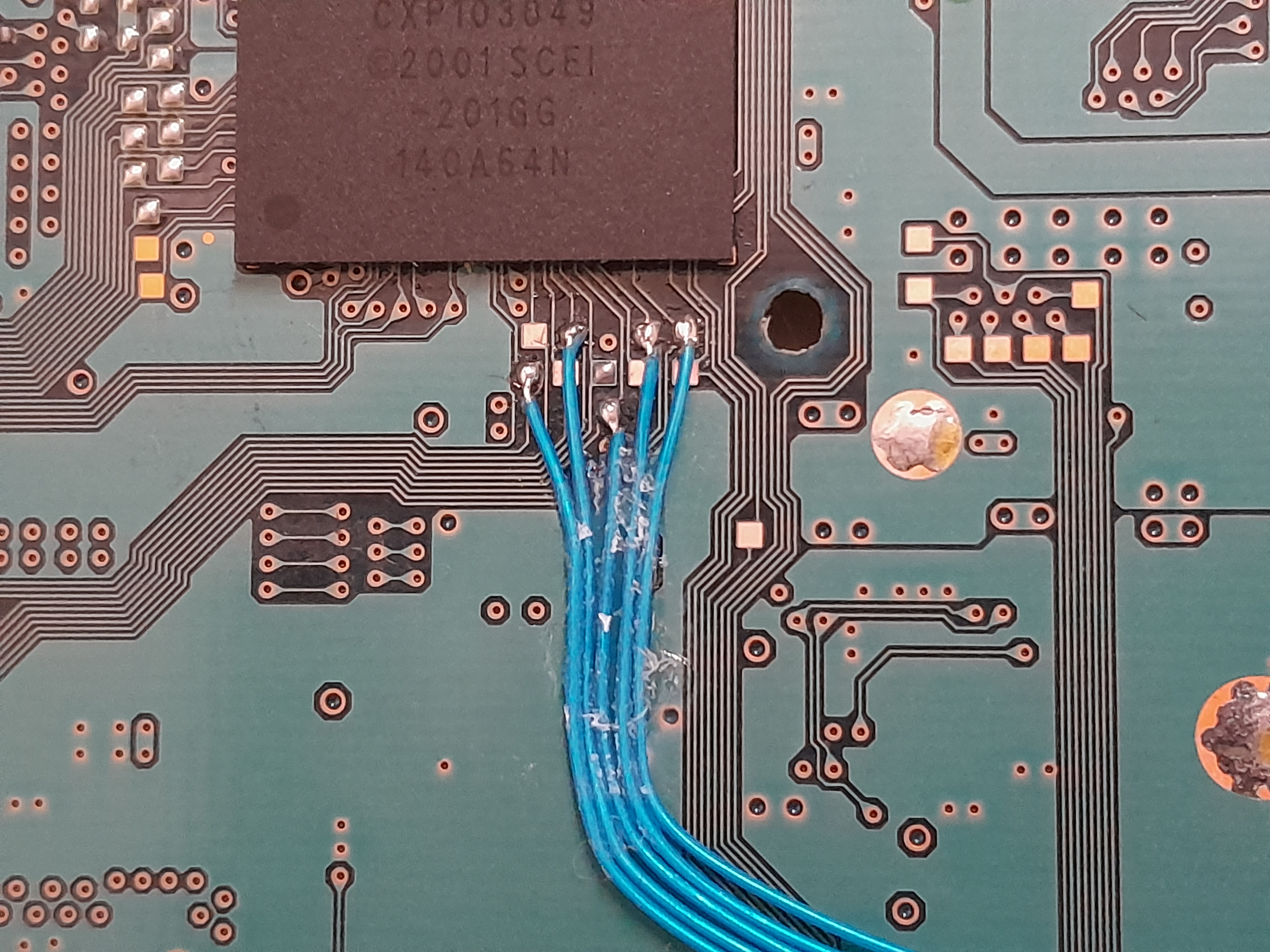

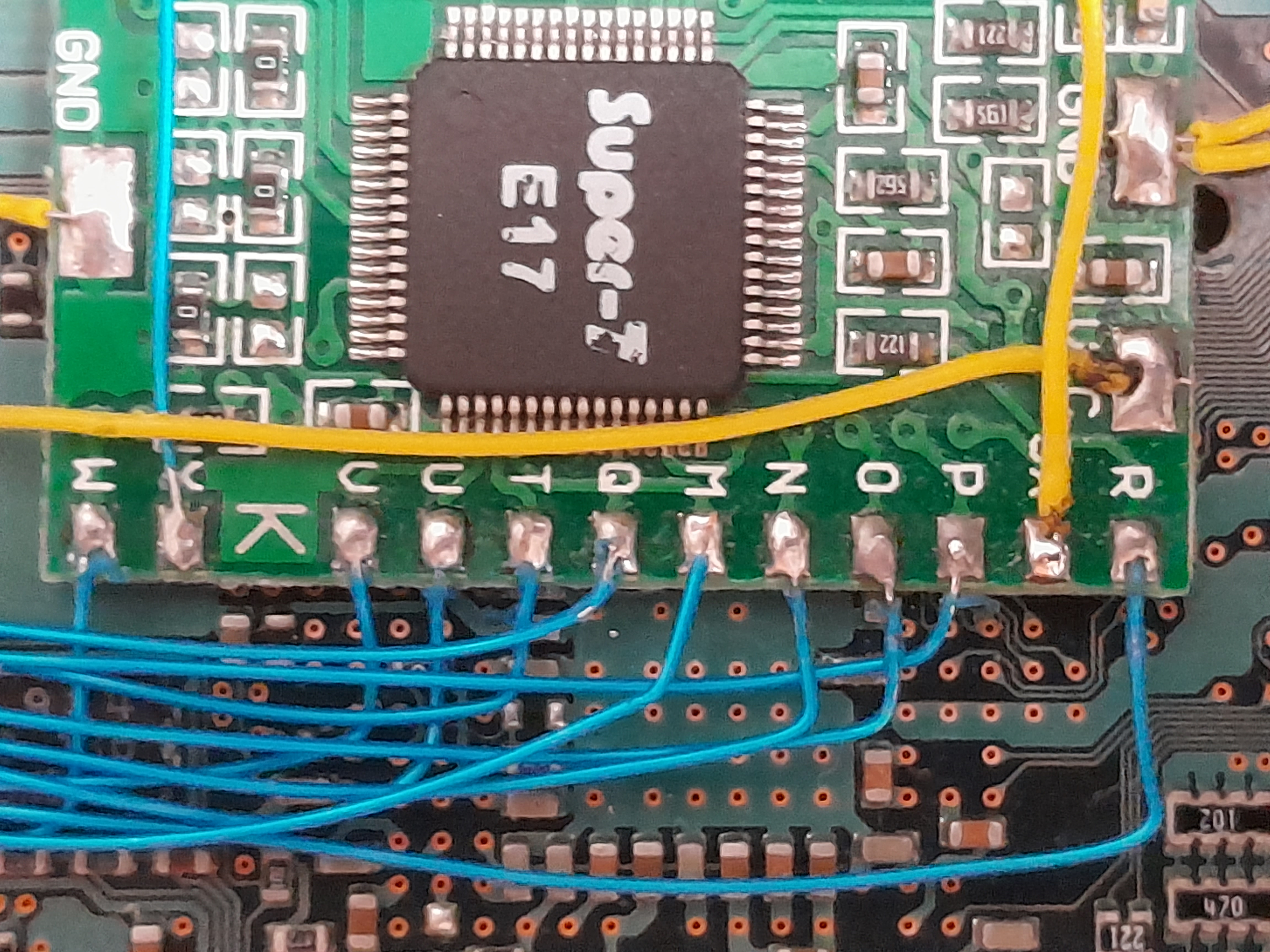

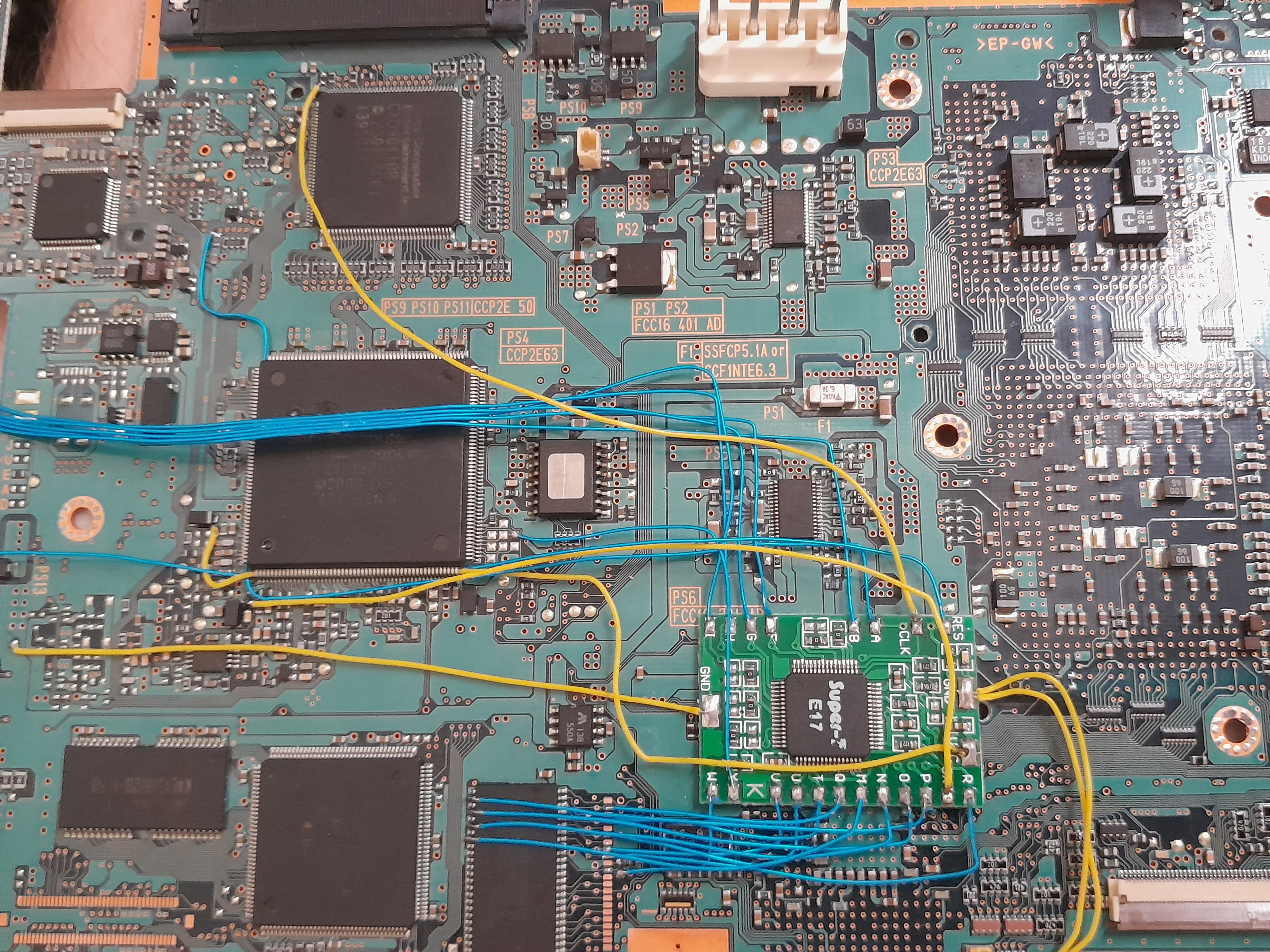

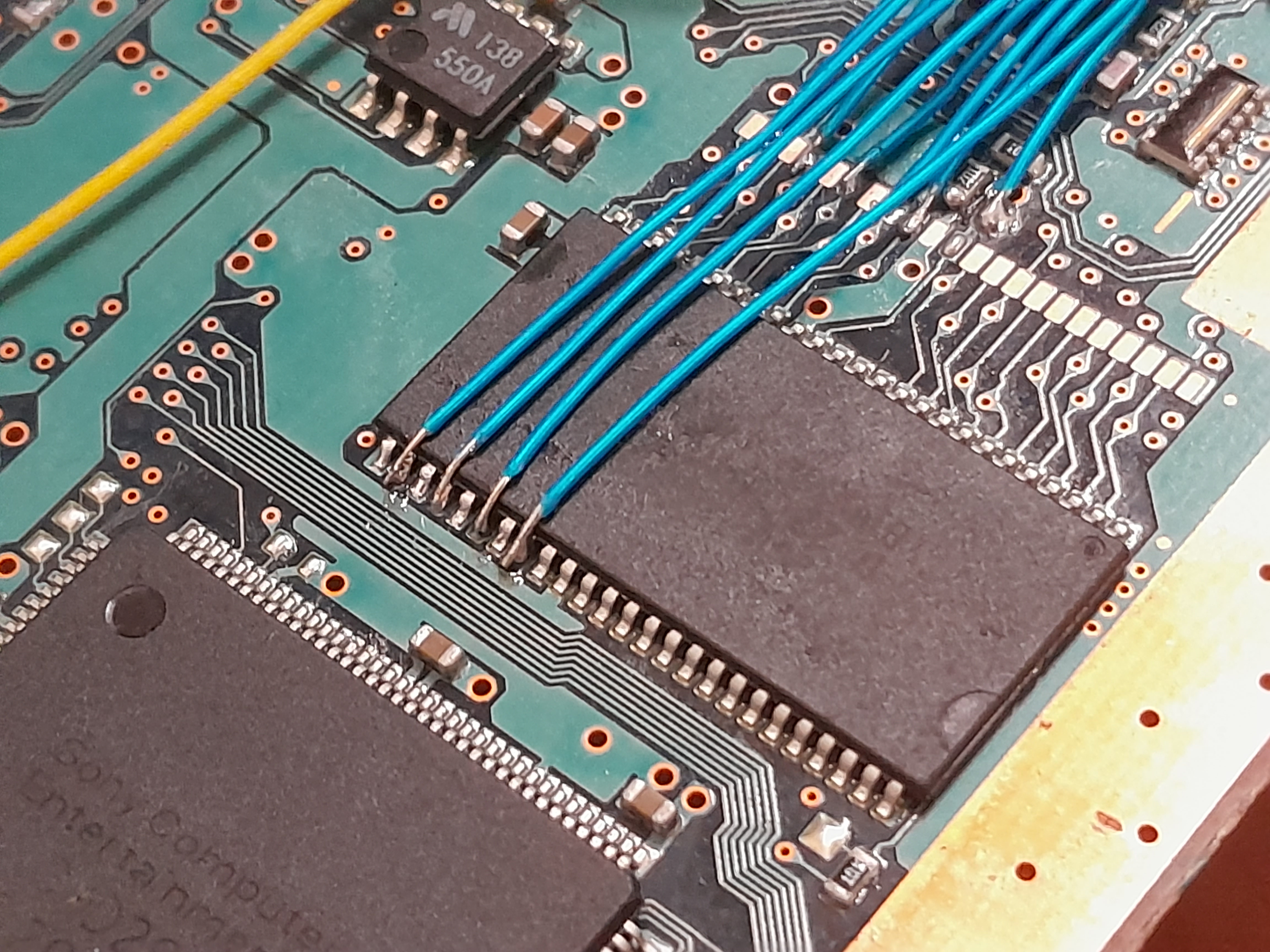

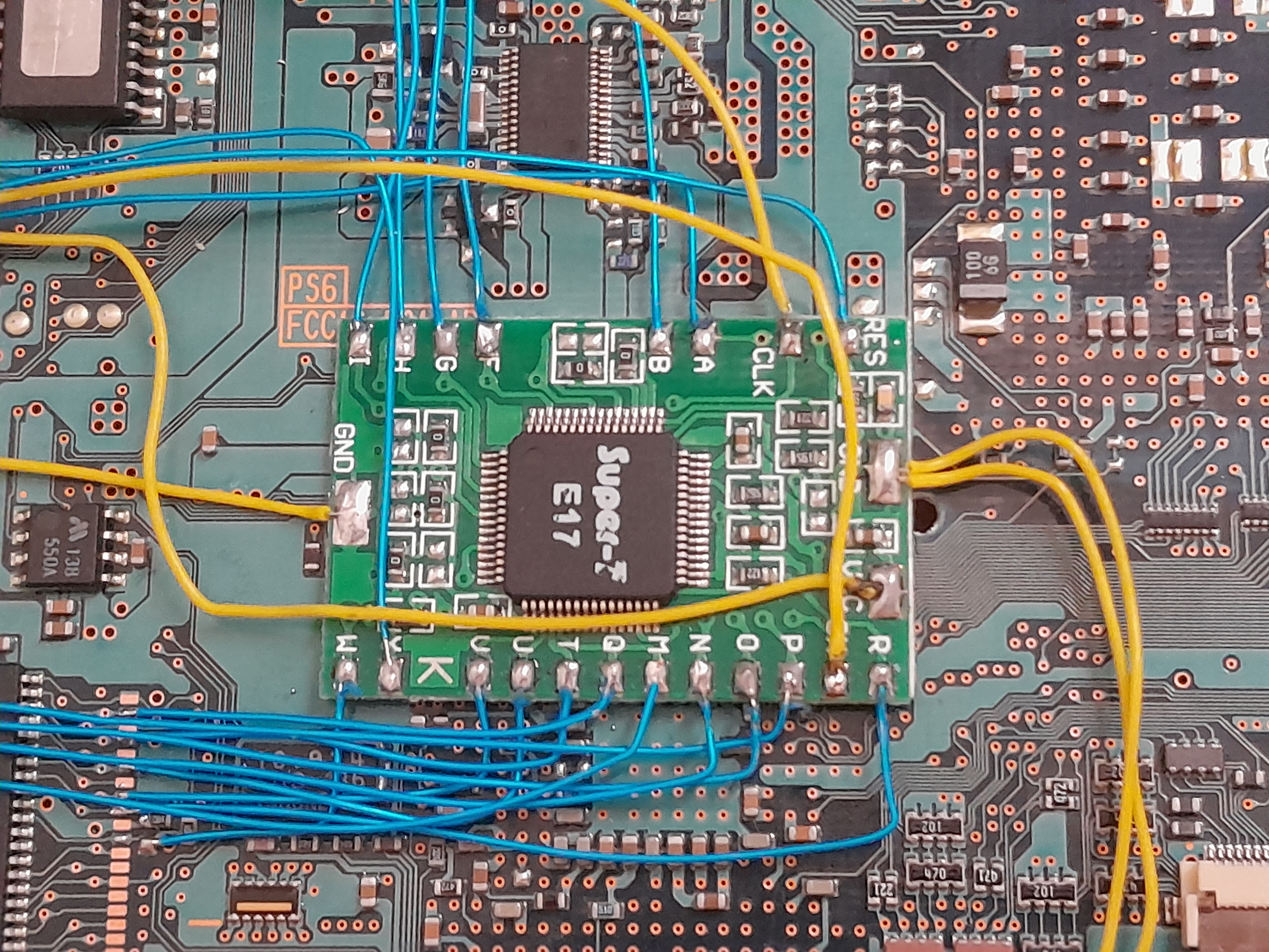

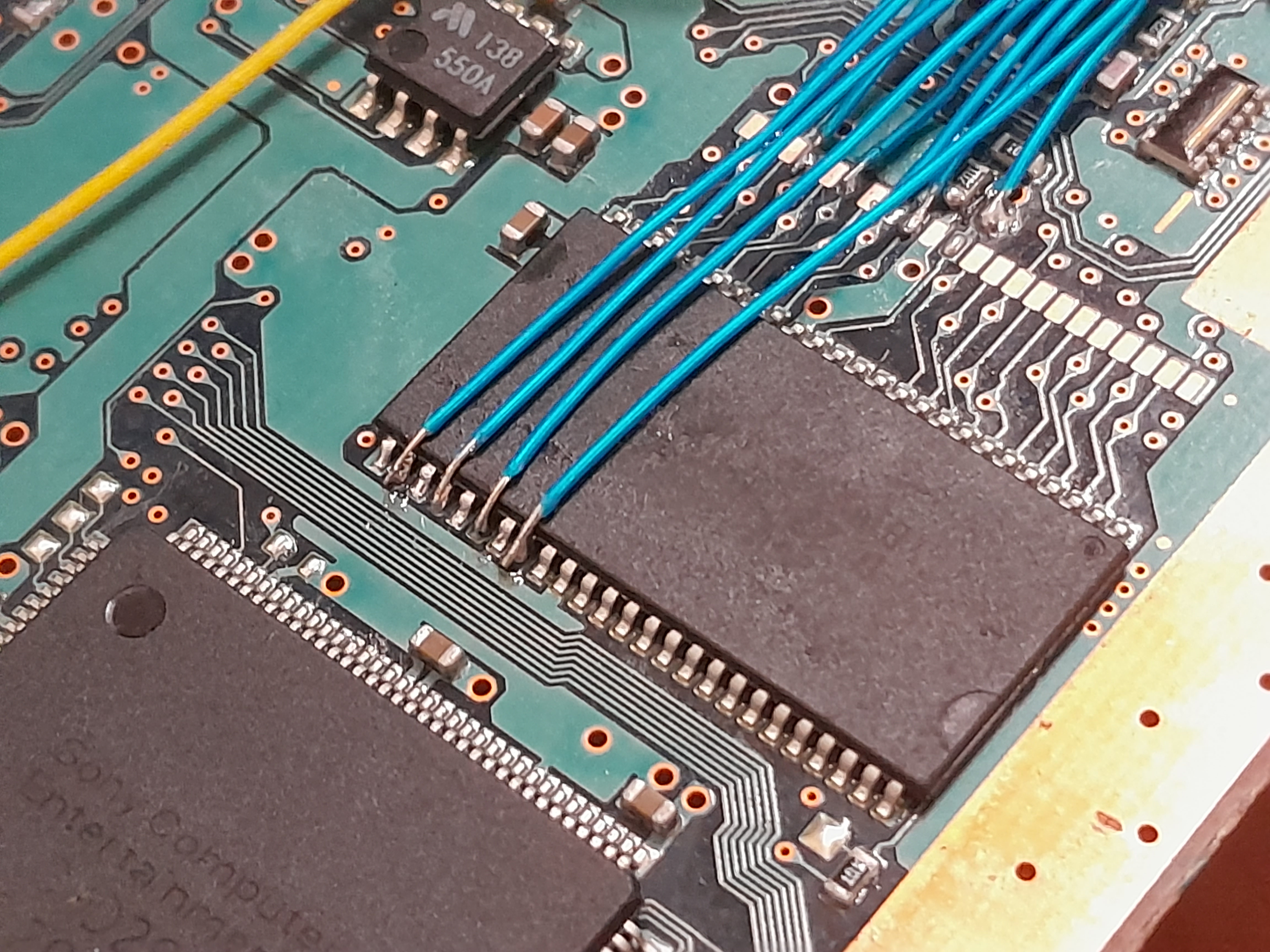

GH-015 PS2 Super-7 E-17 modchip installation.

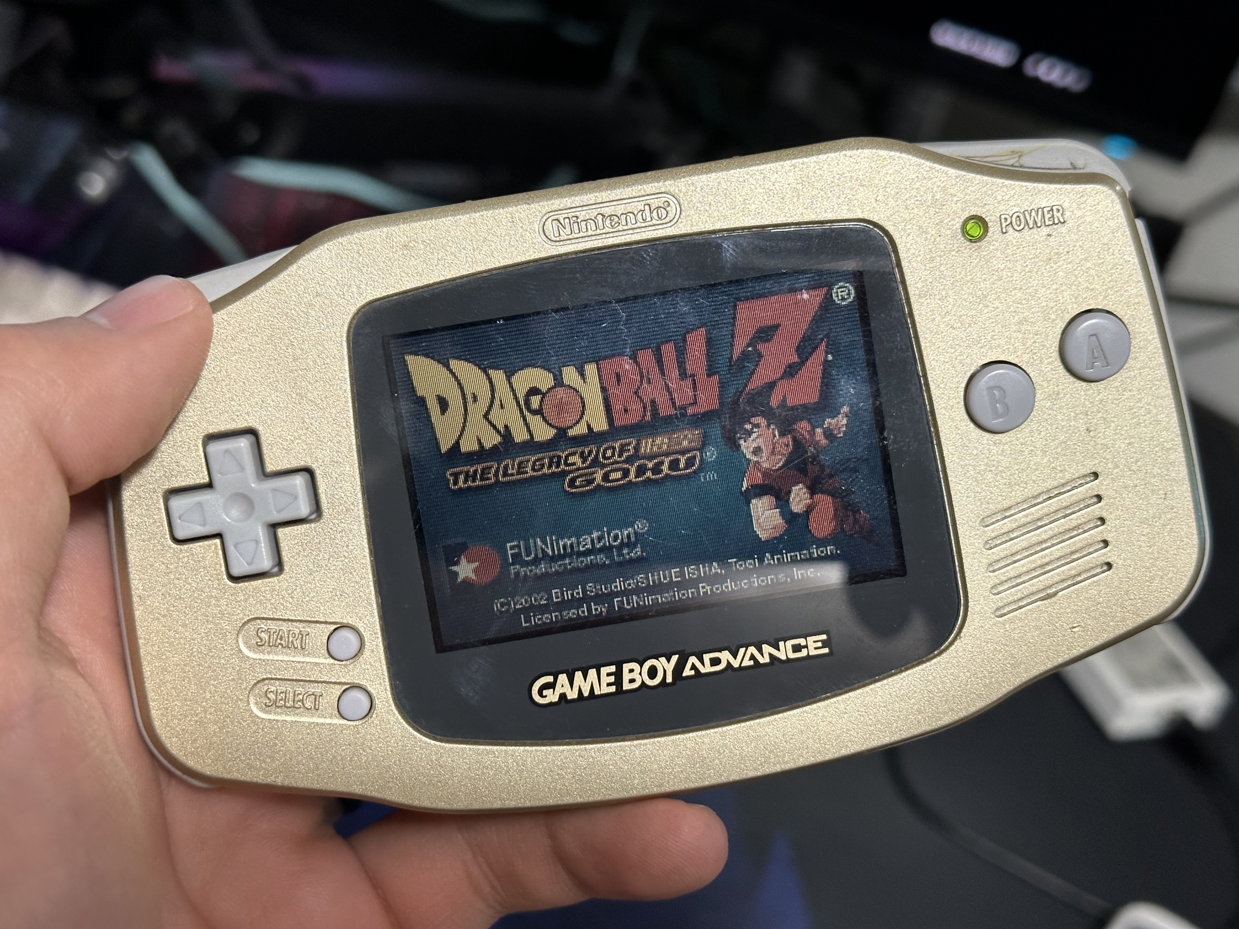

Picked up a GBA in Japan for around $30. It didn’t power on, but everything else was in great condition. The power switch just needed a good cleaning. This will be a great candidate for my first custom GBA system.

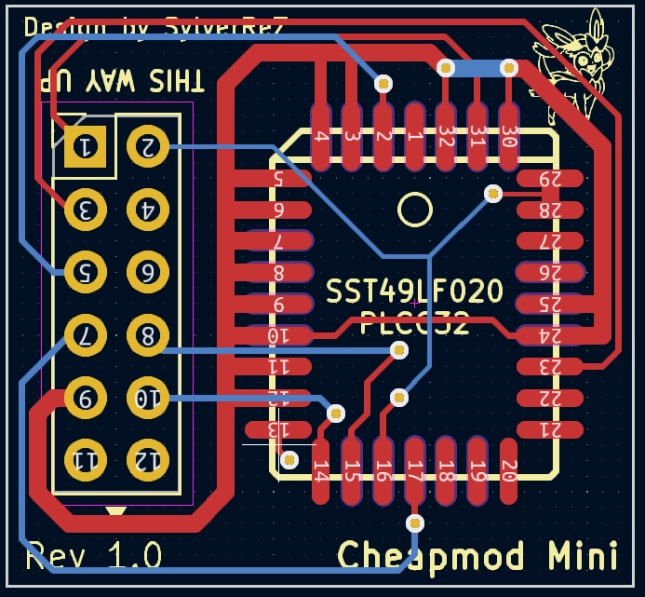

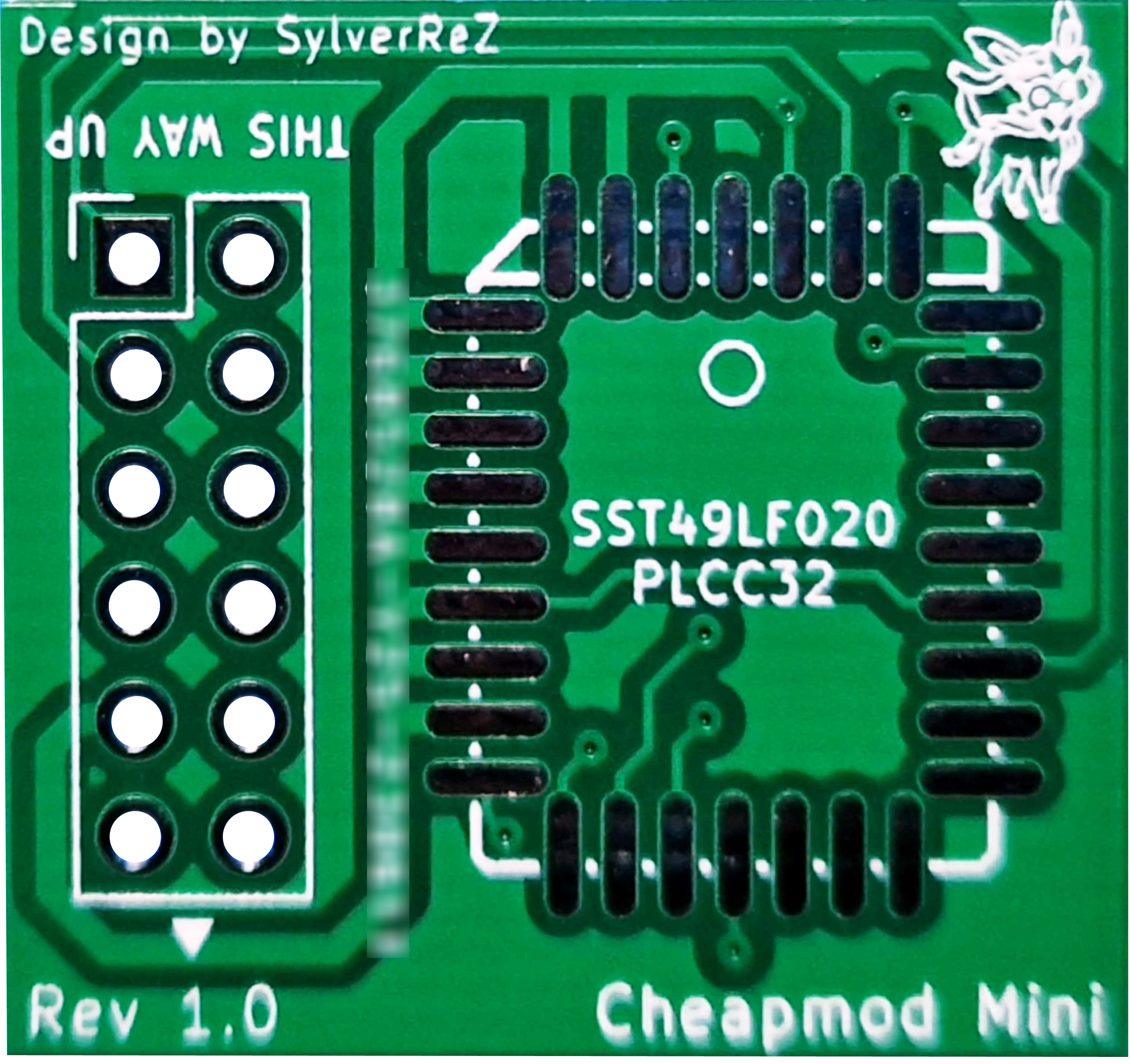

Credit to Lonnie from XBOX-SCENE for sending me a physical picture of my Cheapmod Mini modchip for the OG Xbox that he got fabricated from JLCPCB. Shown here is a prototype board, I have made one mistake in the early design and that is pin 13 of the flash chip not being connected to one of the LPC pads, the final revision will have this fixed.
I will have the GitHub repository up later in the week so you can build your own.
