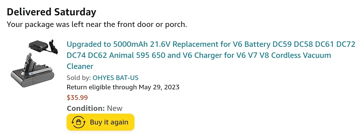

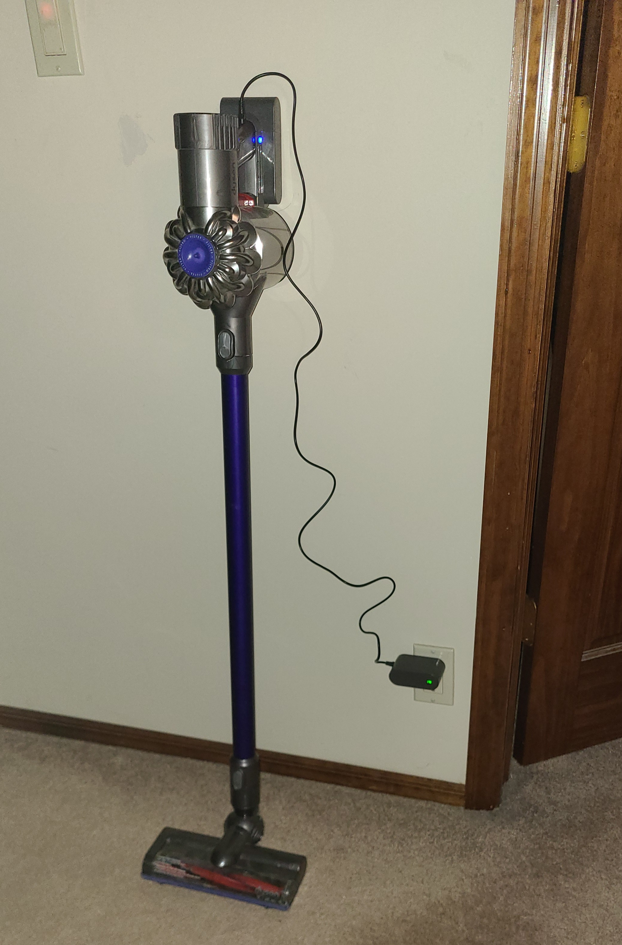

Found a dyson dc59 stick vac in the trash one day on my way home, it was just the motorhead, extension stick, and powered brushhead. No charger, wall mount or other brush attachments. Hooked up an adjustable dc psu to it of 26v @ 0.7a to the charger power port, no light, nothing. So after looking it up ordered a replacement battery with charger brick for $35, swapped the batteries and charged it and the vac is working fine again.
Surprised some people just throw out a $600 vacuum, would have been only a $20 fix for them, only had to take out 2 screws. I'll be keeping it for myself, alot quicker and far less cumbersome then my corded cannister vac.

Think I have one of these in my office, we don't know where the charger is, so it just sitting in the closet.

Wow. Quite the come up. I just had to replace the first part ever on my dyson. We've had it for about 6 years at this point and it's been great. It's one of the big ones with the ball on the bottom. What finally broke is the hose that connects the bottom of the vacuum with the rest of the vacuum. So it flexes real hard every time you go to use it.

Could just be the battery and not the plug that is damaged. But glad you managed to find that out in the end.

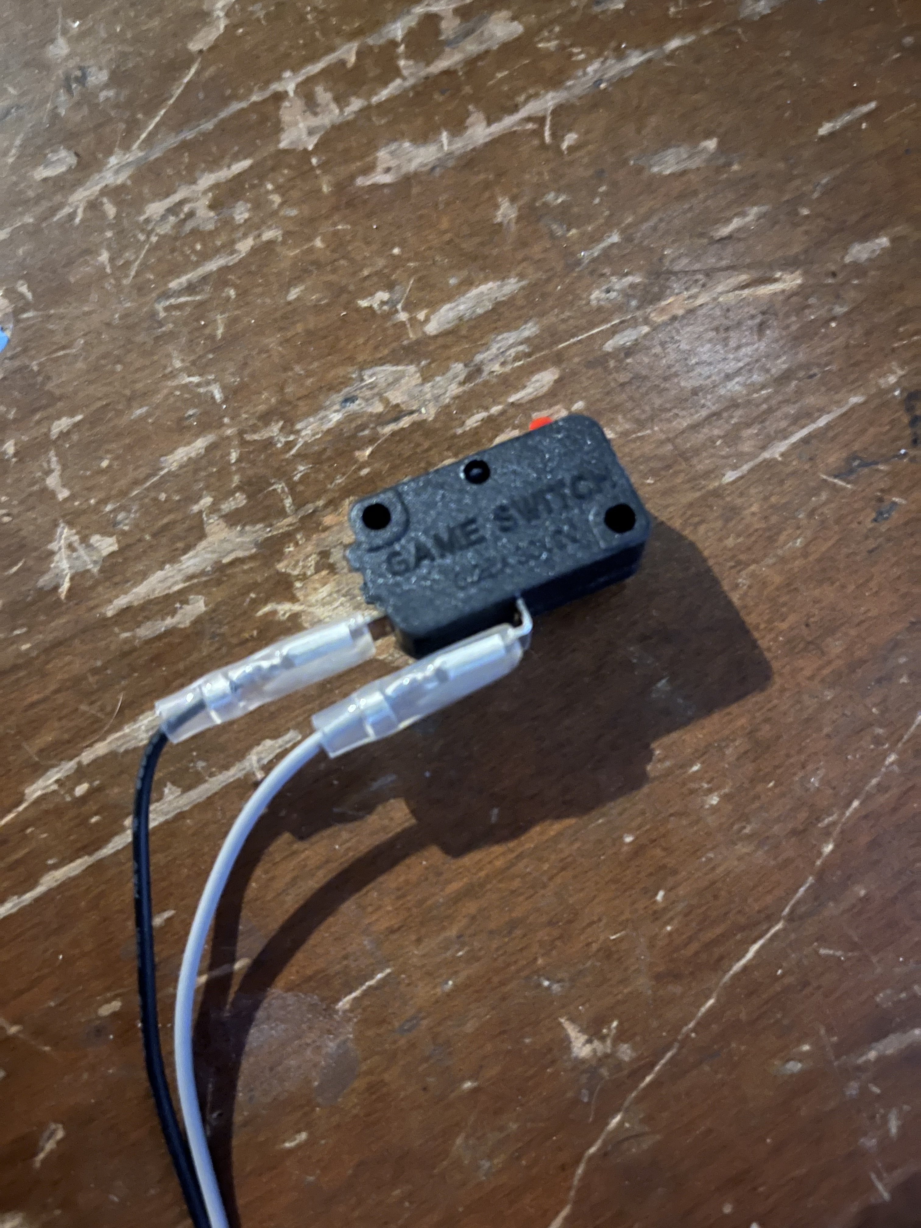

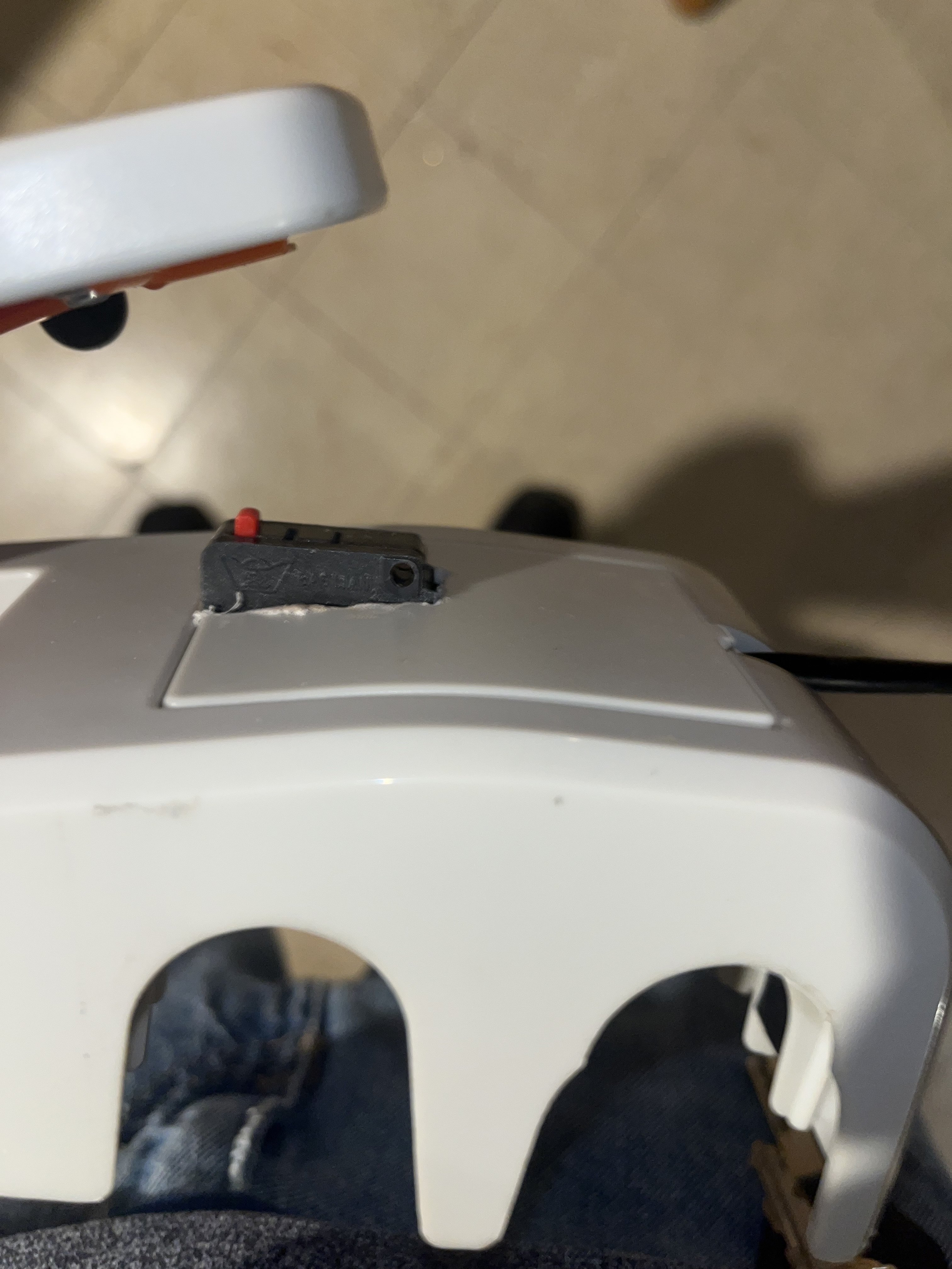

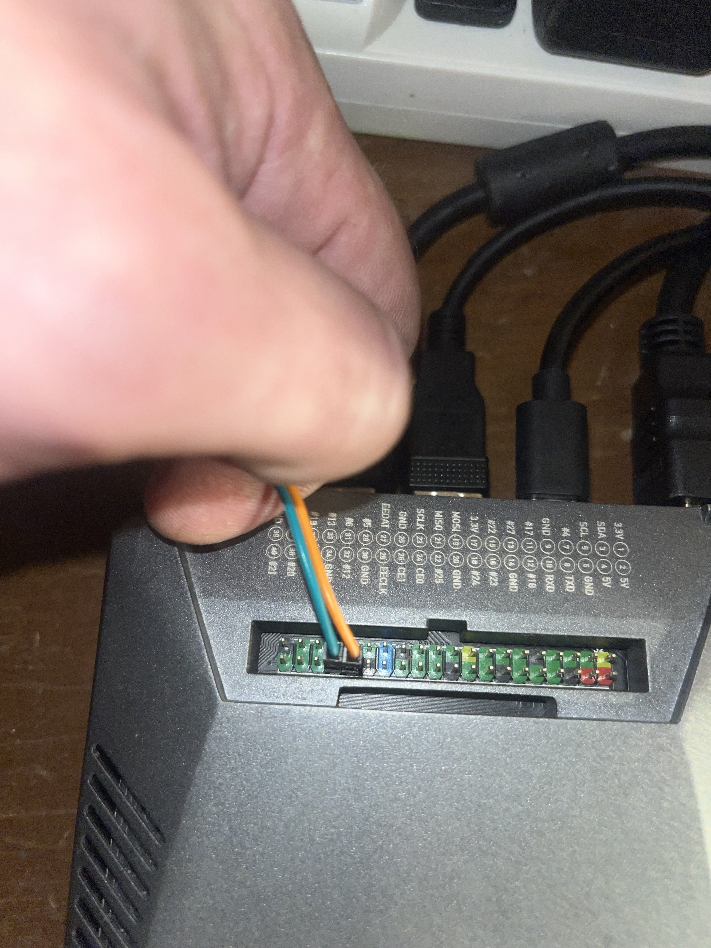

I took an old Rock Band drum pedal and modded it into a foot pedal for a Sinden setup. Just a standard arcade button switch that the pedal comes down and presses. I used GPIONext to configure it as a keyboard on a Raspberry Pi using GPIO pins. Works great.

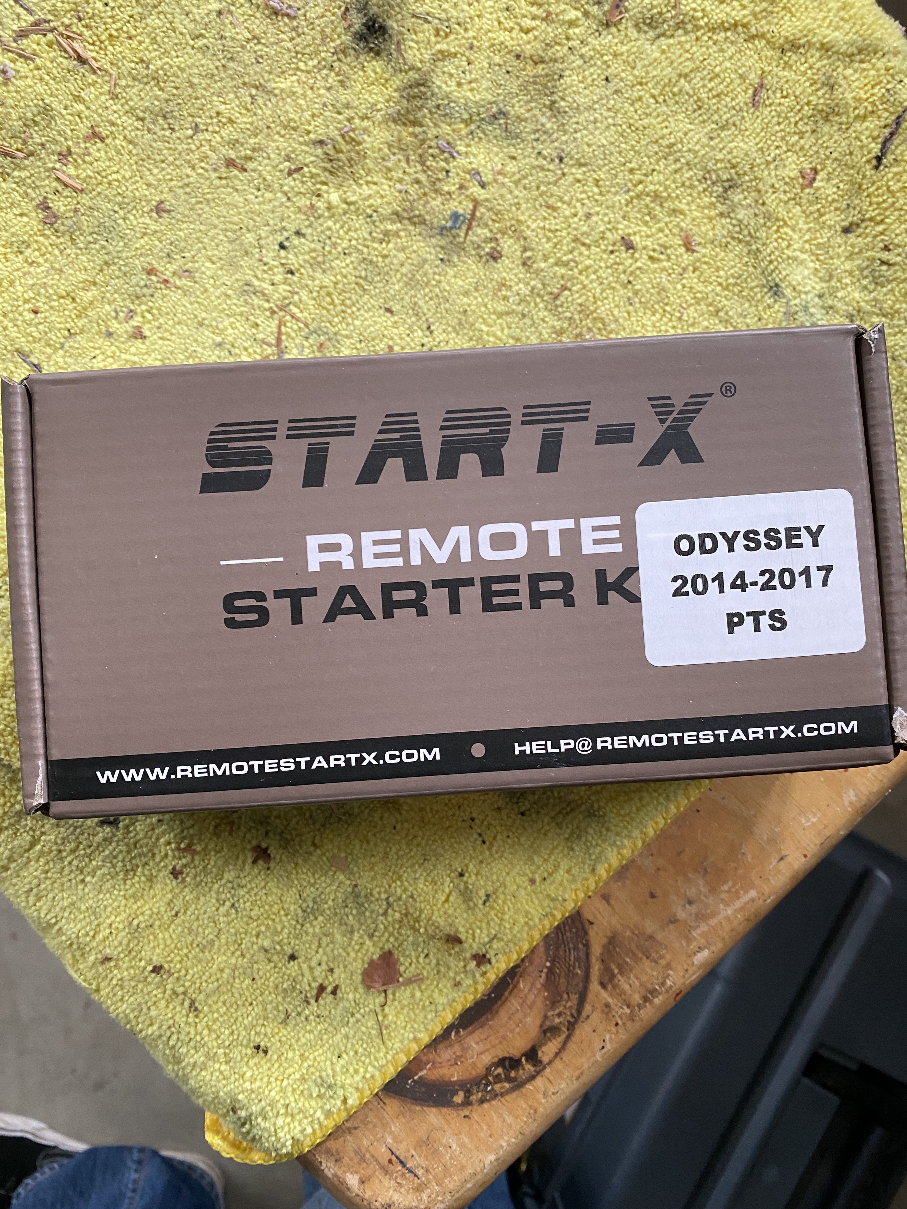

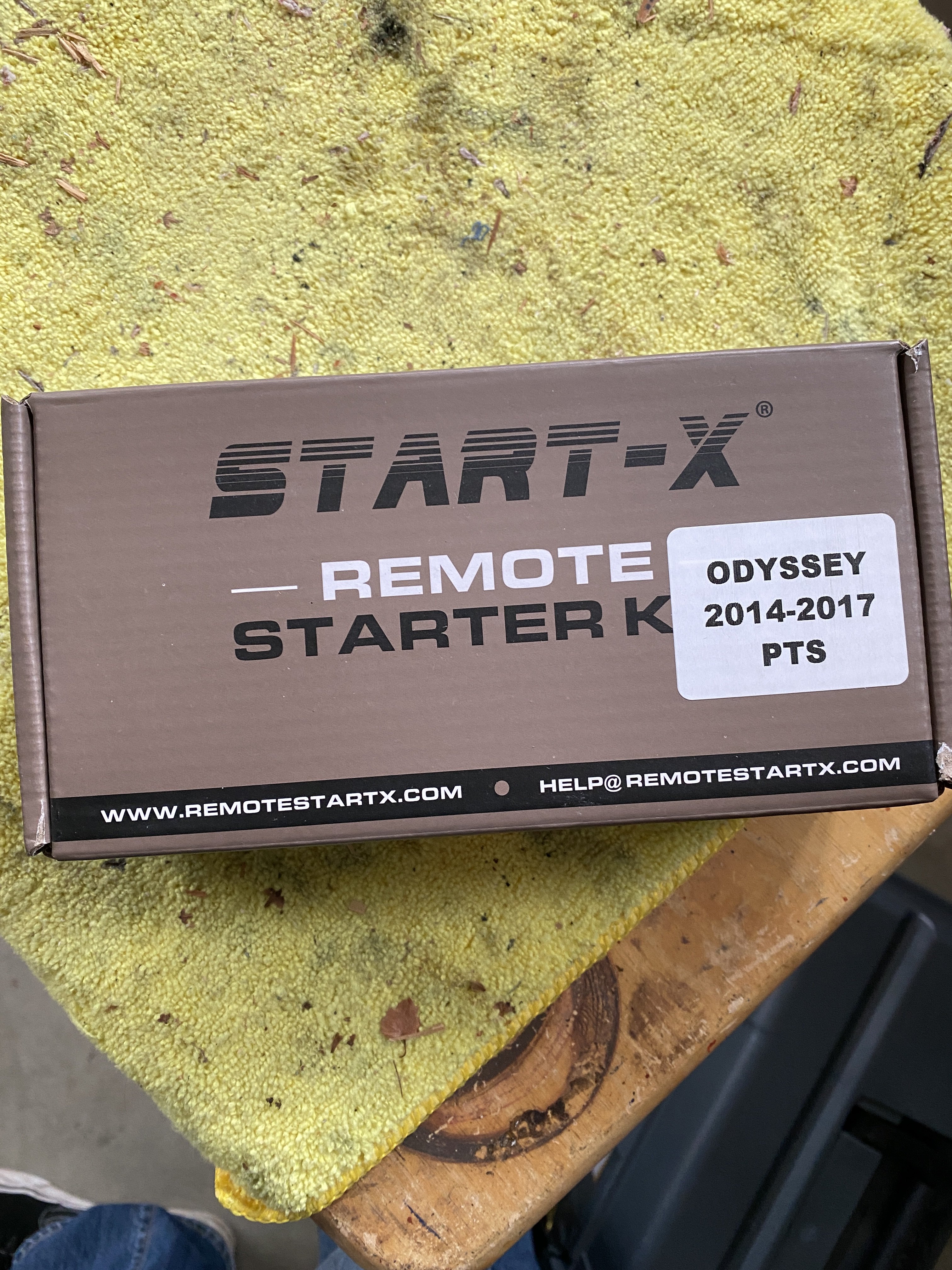

I would be leary of those, as people into hacking might find the frequency. Like they DO for garages.
I was curious about that. This kit uses the OEM key fob. There are kits with their own remote. I think those are far more likely to get hijacked, but the OEM one seems a bit more proprietary.
