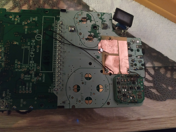

Always wanted a Gameboy Color, but working ones have been pretty expensive lately just to get on a random whim.
Decided to get a broken one for about a third of the price. Saw corrosion on the battery terminals, and the description said it wouldn't work, so I thought - hey, easy, just gonna clean that up, and boom.
Welp, as it turned out, it was pretty bad.
The power switch didn't work, and that was actually the main cause of the thing not working, not the corrosion.
However, the corrosion has destroyed most of the lower board. The A and B buttons were pretty bad and Start and Select were just gone, a whole field of nothing where there used to be contacts.
Furthermore, all of the capacitors on the board were bad, the screen flickered, the power jack fuse was blown and there was no audio whatsoever.
I cleaned up best I could, sprayed some contact cleaner everywhere, and the audio started working through the headphone socket. The thing was stuck in headphone mode permanently, so I had to try to bend that locking pin out of the way. It's not perfect, and will probably need redoing at some point, but eventually I got it to play through the speaker... very quietly.
I replaced all the bad capacitors on the board, and that didn't fix it. Decided to splice in a 3DS speaker I had laying about, and that helped a little bit. It's not perfect, but good enough until I get a proper replacement.
I thought the screen flickering would just be a bad screen, but I noticed that touching the ribbon cable around made absolutely no difference. Thus, my attention turned to a little potentiometer on the board which adjusts the screen contrast, and, indeed, it was not reading anywhere close to the specified 50K Ohms. Didn't have a replacement pot of that size, so I spliced in a larger one, and it's just kind of floating in there. Not perfect, but the screen returned to looking good. Progress!
Now came the problem with the controls, and, well, in lieu of any remnants of the original pads, I had to make my own. After some scraping and cleaning, the A and B buttons started working properly, so it was just a matter of the START and SELECT. Decided to use some conductive copper tape.
...it looks pretty bad, but it actually works, and that's all I need. I have ordered a proper replacement, but it does the job for now.
And indeed! The whole thing came back to life.
Was it worth it?
...dunno. Maybe I should've just gotten a proper one. But it was a fun adventure.
