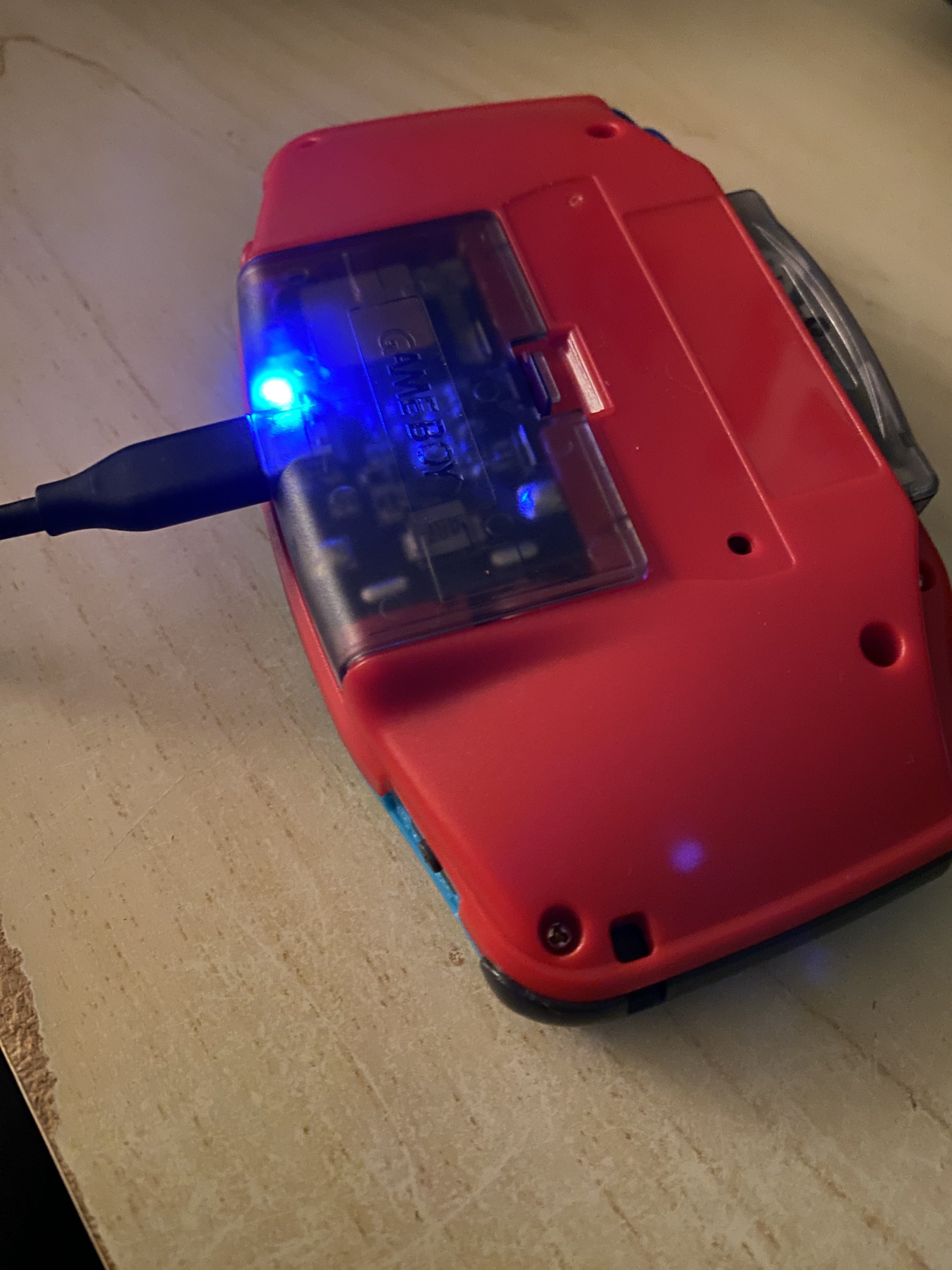

Funnyplaying? I just got one last week too :gba:
No. Some cheapy I found on aliexpress. It’s a 1800 mah battery. I’m just trying it out now. I had to cut up the battery bay quite a bit, but it fits well now.
I just noticed. With AA’s, if the power switch is bumped, the light will flicker green to red. With this battery, there is no flicker. I think it’s because this battery is 3.7 volts. The AA’s are 1.2 volts each, in series. That’s 2.4 volts. The 1.3 extra volts must not be that harmful to the gba.
What is the capacity of your battery? I see the funnyplaying photo, it’s 2000mah, but the listing says 1800mah.

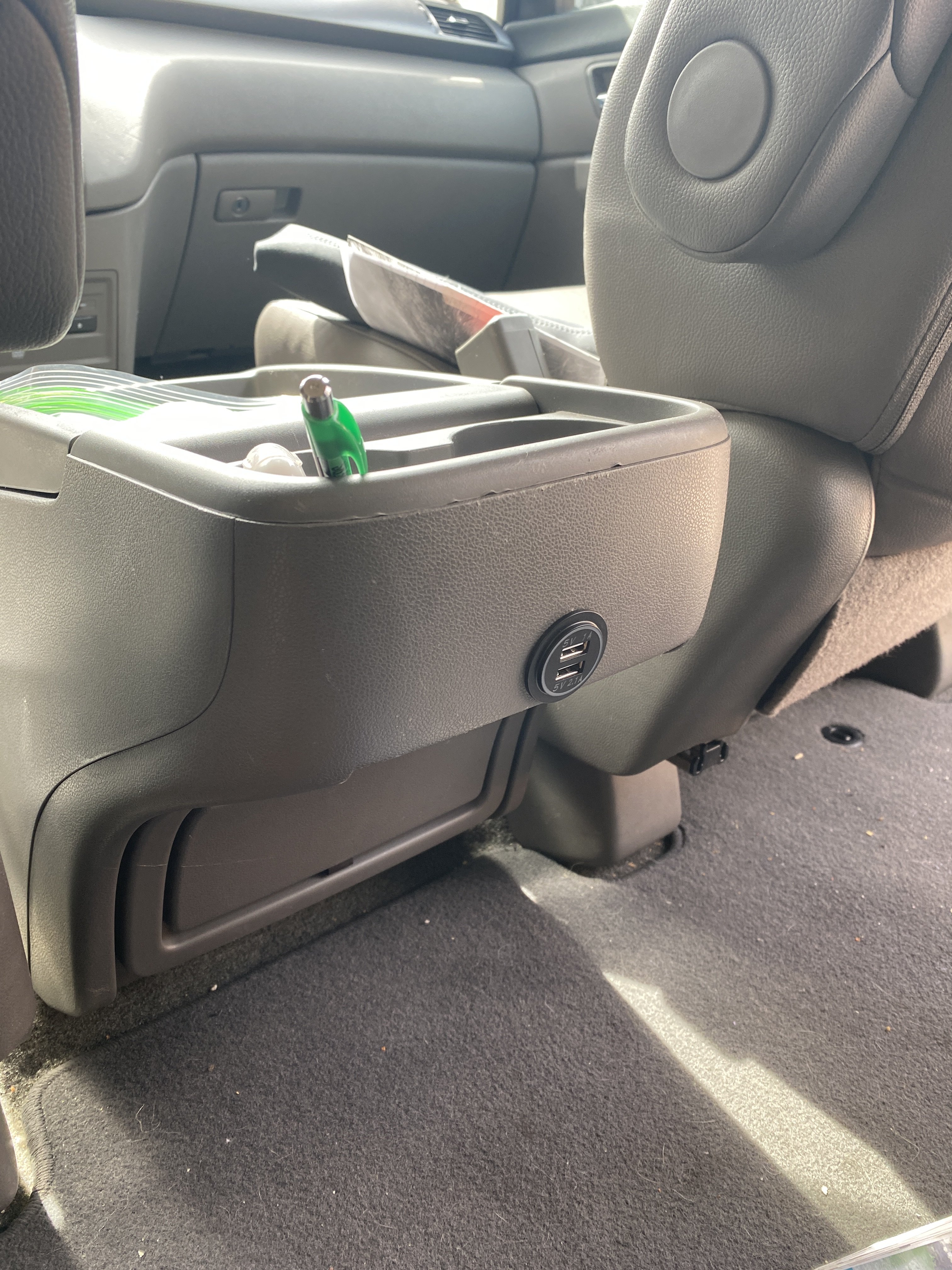

Just installed usb ports for the second row passengers. I’ve been wanting to do this for a while and finally just ordered the part and did it!
I tapped in to the cigarette lighter port to feed this. Fishing the wire under the carpet wasn’t too bad. The hardest part was fitting this in a place that is easy to access. The port is so low because of the cup holders. I didn’t have a whole lot of room there.

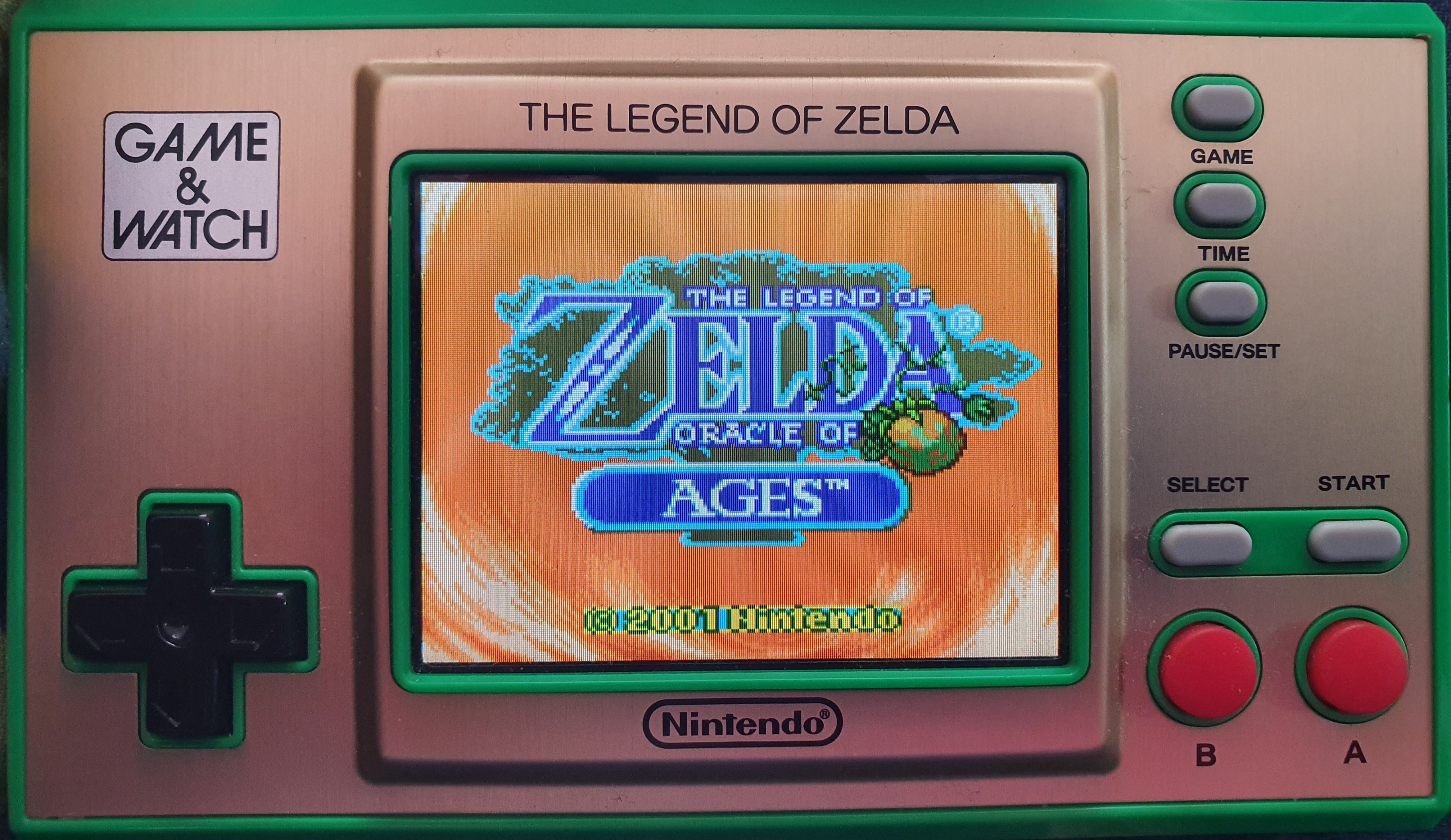

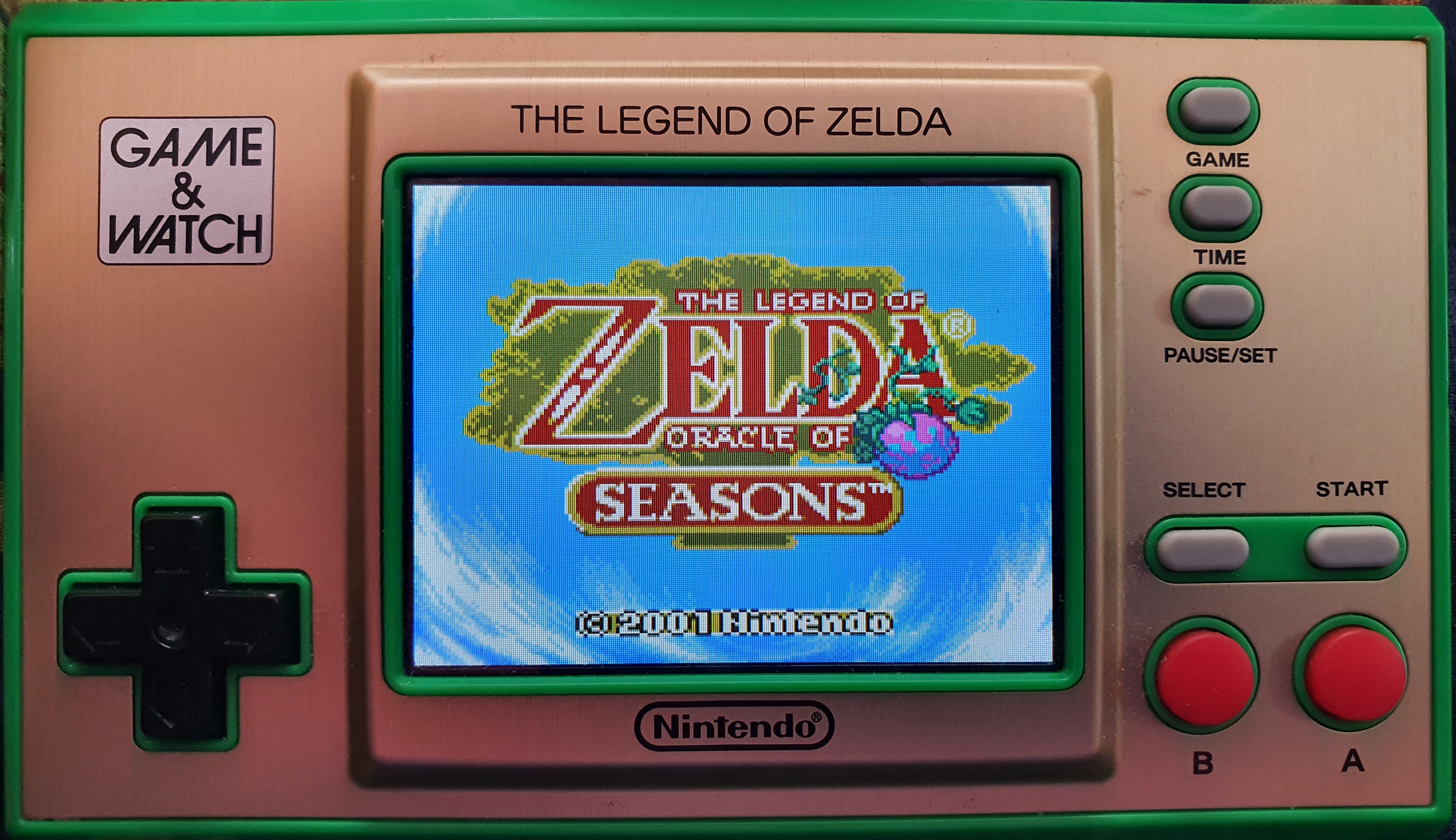

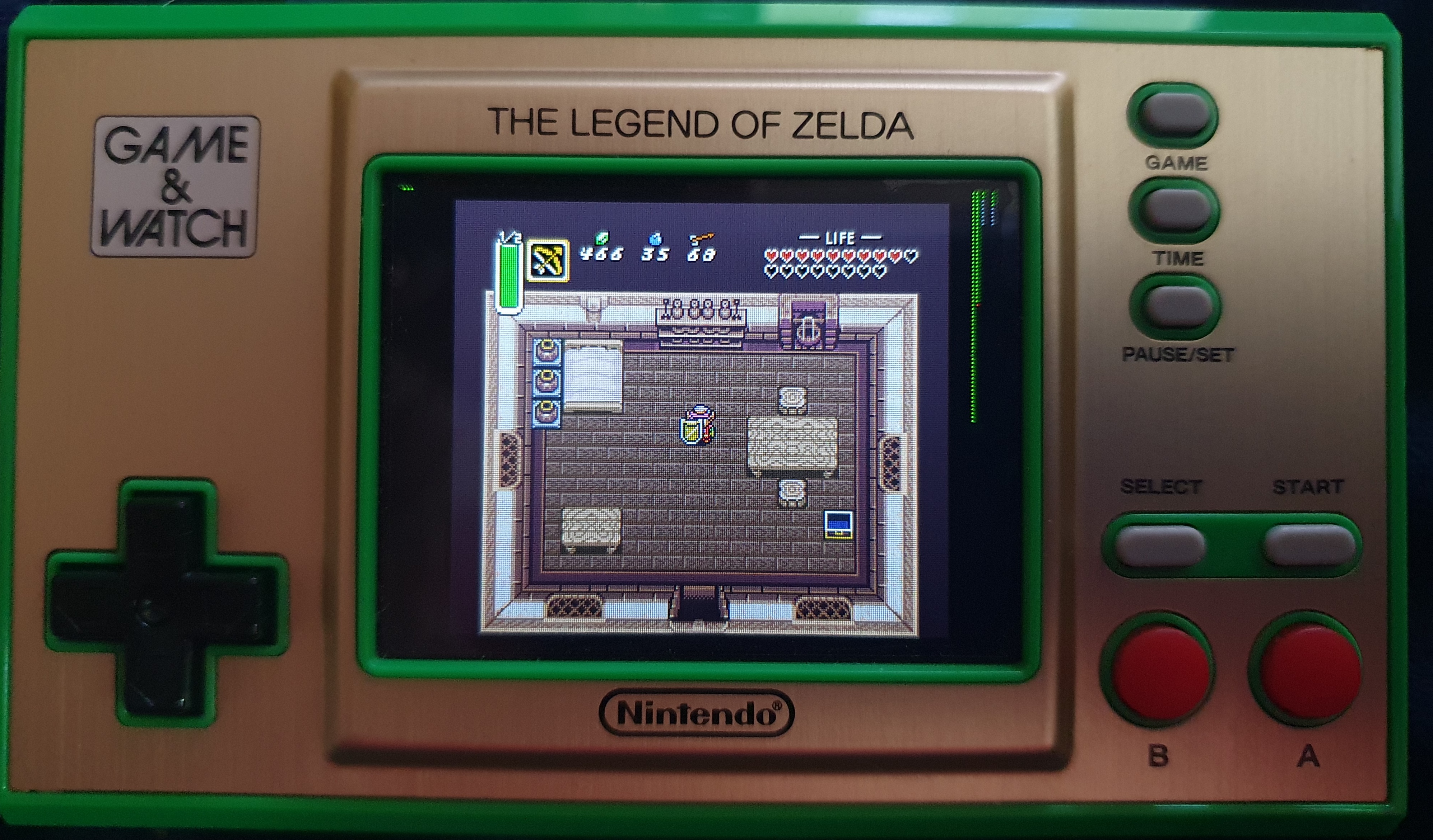

Zelda Game & Watch hacking, phase 1 complete:
No soldering for now, was just holding the Dupont cables in place, worked well enough. Didn't upgrade the flash storage yet, so this is the two Oracle games and the emulator crammed into the original storage along with the original firmware with its two NES games (monochrome Link's Awakening has been removed for now), and its funky clock and old-school g&w game.
Phase two when I'm confident with my soldering will be to replace the flash with a 16MB chip, hopefully connect the data points to the USB connector so I can reflash without opening it up, and to load it up with Link's Awakening DX as well as the Oracles, plus some funky Zelda and Zelda-themed ROM hacks I've been looking at (and one I've been working on myself) - and of course the Game & Watch emulator with all the classic LCD games. I also saw on discord that someone is working on porting the source recreation of ALTTP to run on these G&Ws natively, it's not full speed yet but if it ends up looking playable then that's definitely going on!

be careful with the spi flash when you remove it. some broke the pads. maybe ill hack one of my g&w again, as i still use a non-public emulator, which only emulate some g&w, tiger, konami titles

Thanks, yeah I'm gonna see if I can find something with comparable chips to practice on first. Must have at least one dead phone kicking about.
