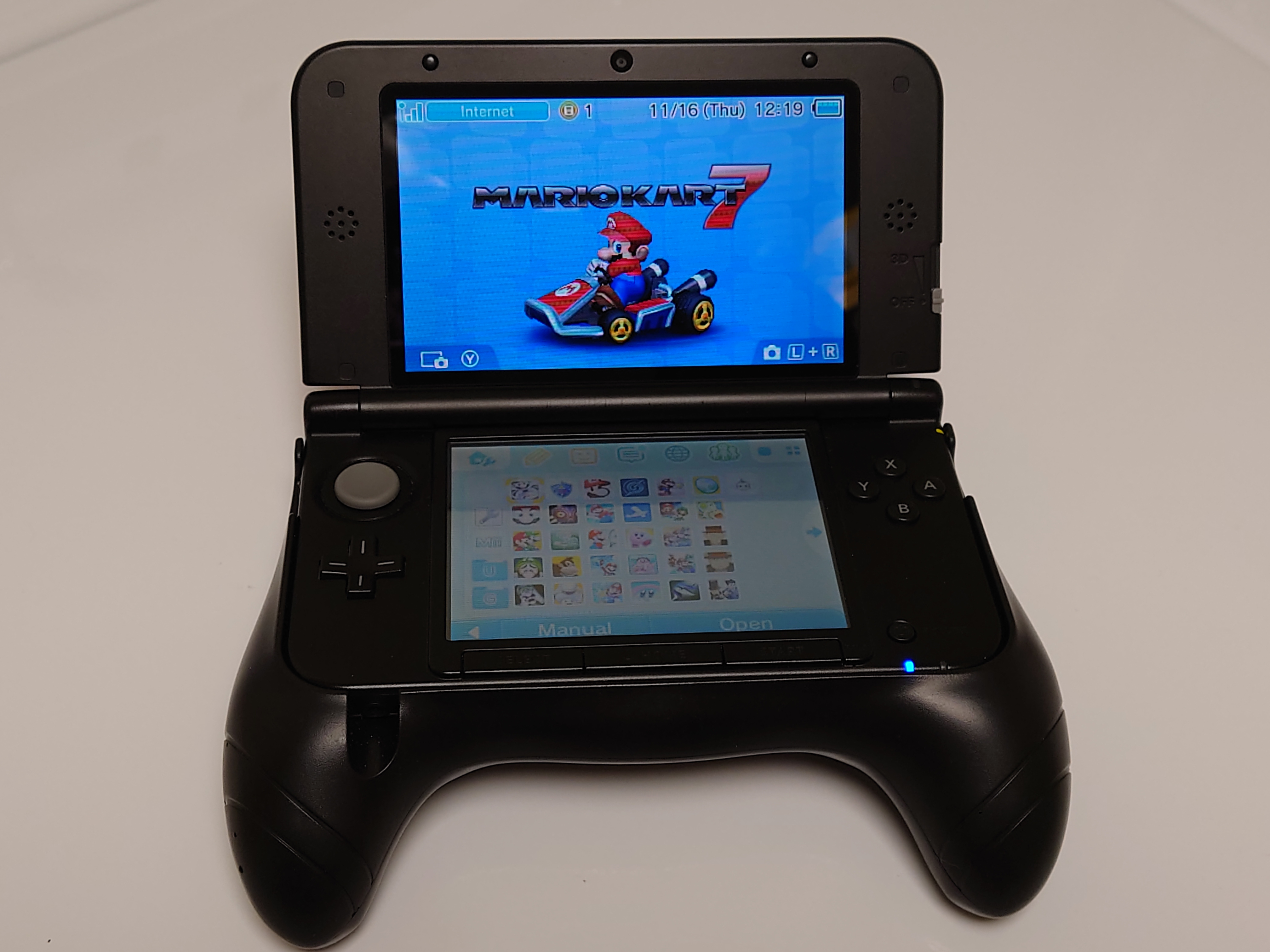

Low key success story, but when my stepson was home on leave from the Air Force about 6 years ago, he gave me this old red 3DS XL. As far as he was concerned it was trash - circle pad felt like it was gunked with dried soda and the top screen was badly scratched. Sat in a drawer for years. Now it has a new OEM circle pad (complete assembly, not just the thumb pad), glass top screen lens, a nice "grip", and cfw of course. It's my new GBA go-to. I've got a regular sized New 3DS which is great for 3DS games but GBA is too tiny on it at original res.
I've got about $19 in it lol.
