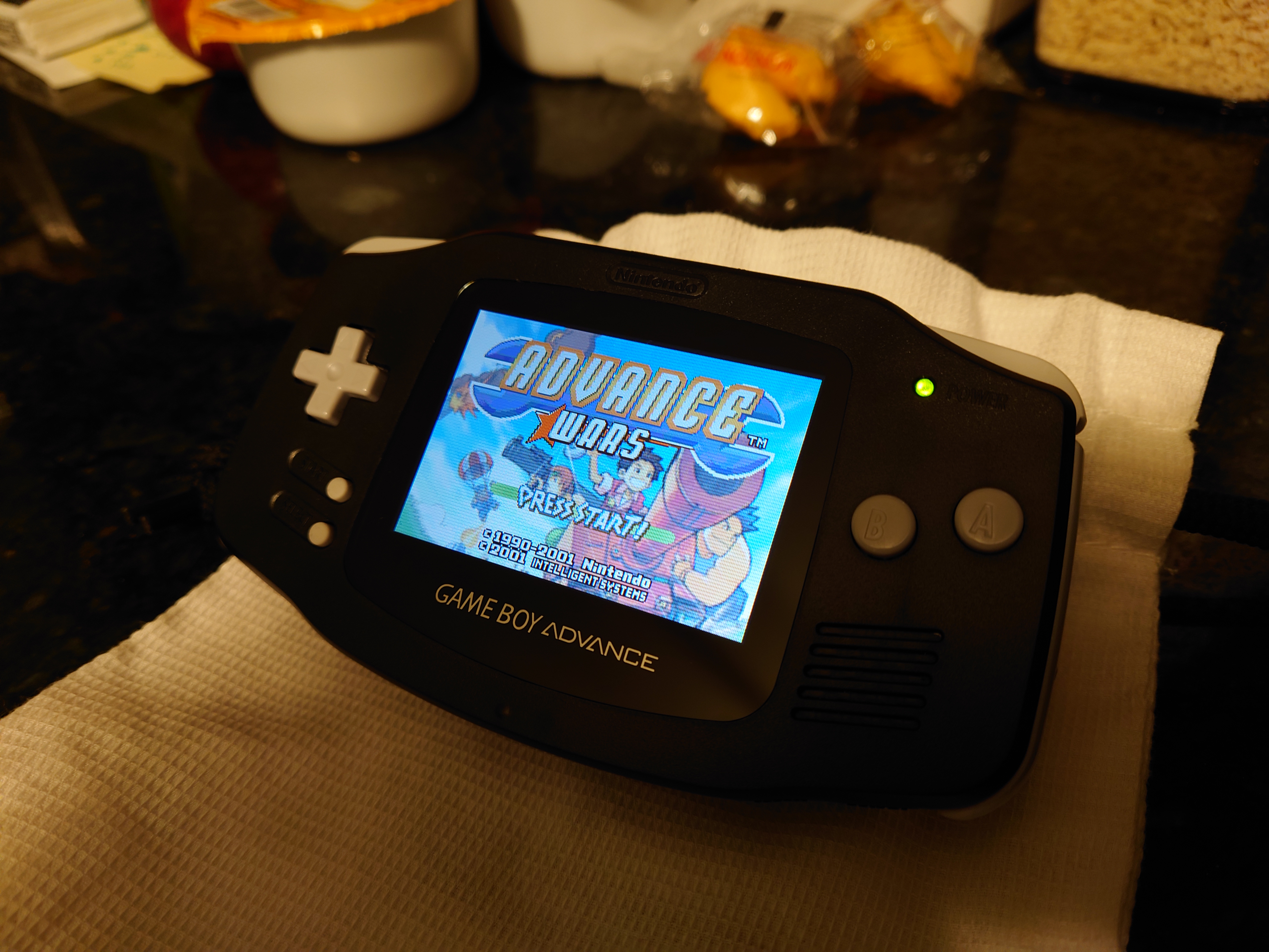

Not the best photo, dark sorry. But, I just finished my FP laminated ITA rebuild of the old murky blue GBA. Nothing pretentious, no neon colors or led lights except the one it came with (power). Original buttons too. I haven't fiddled with screen calibration yet ... that was enough for one evening. But, very very nice. Screen is fantastic. (!!!) The shell, which you have to use their specific shell for the laminated screens ... it's ok, not amazing though.
A small FYI for my fellow 'temprs .. if you build one of these and want to use the original screws, be careful putting the black screw back in the battery compartment area. Apparently the original screw is slightly long for the FP shell. It made a very small dimple on the face just below the screen. Luckily I didn't punch through - would've been a $10 tragedy. I don't mind it since it's a tiny bump and centered at least. I'll know for next time.
I also did a mod-in-a-mod here. Removed the TC233A touch sensor chip off the screen adapter PCB, which completely kills the touch function. Now the OSD, FRM, and X/Y screen position controls are only by way of Sel-L-R buttons. Very nice. Info here:

Tomorrow, screen calibration with the "Aging" ROM. But, I think it's looking pretty good already.

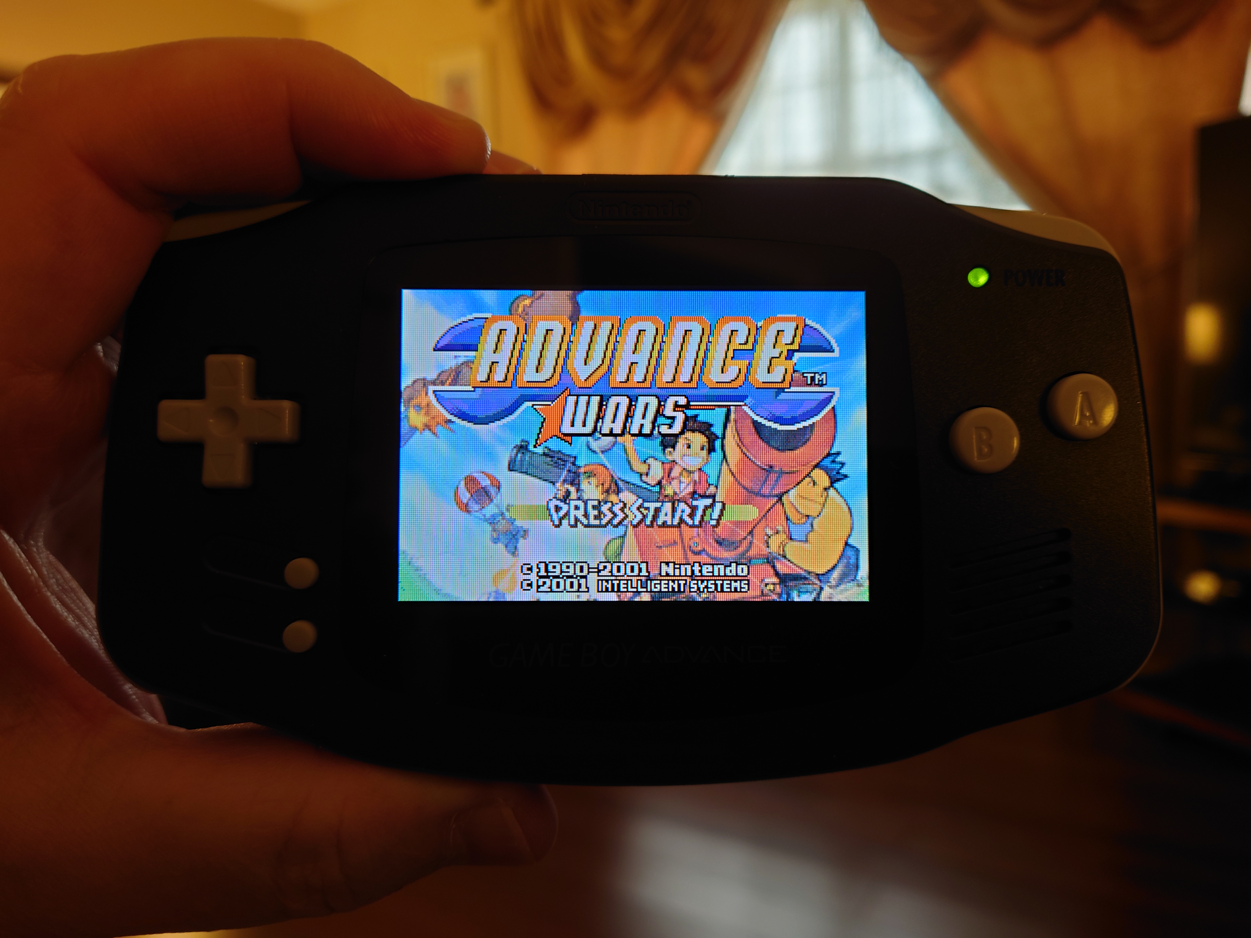

Edit: after screen voltage pot adjustment using the "Aging" rom. Color balance and vibrance improved. Pure eye candy.
Another dark photo ... I think my phone is compensating for the screen brightness. I just wanted to show the screen off anyway, so fine.

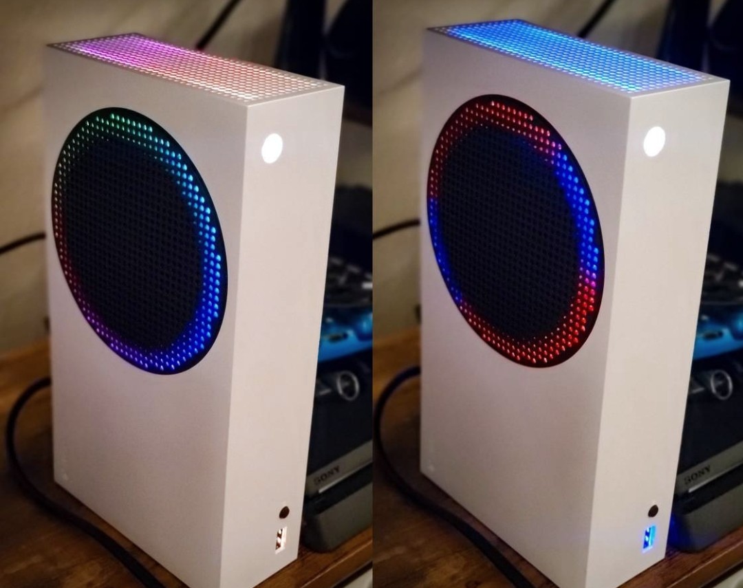

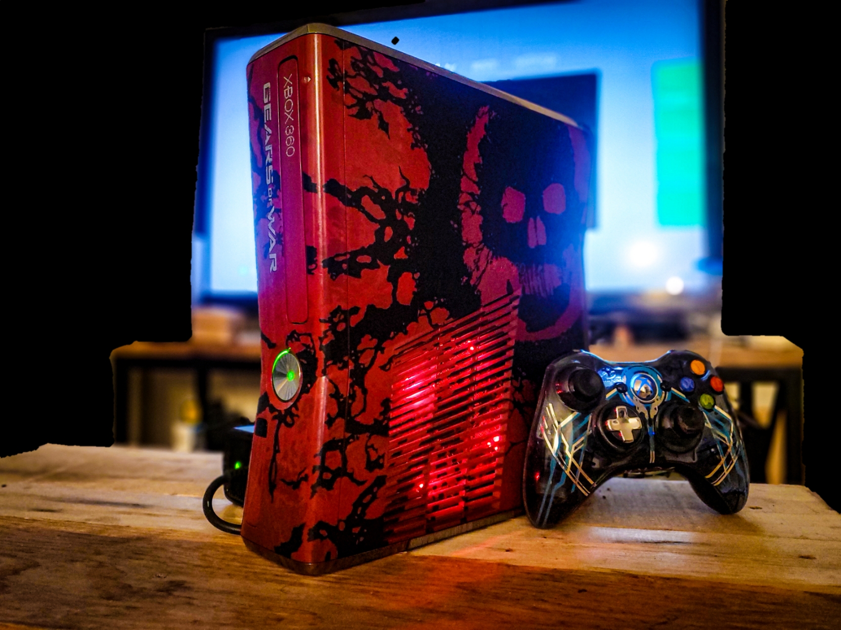

Picked up an open box of Xtreme Rate RGB mod for Series S, and went thrifting for fairy lights for the 360 S consoles. All happy customers... though my guy with the GoW Slim wasn't happy when I told him he needs a matching controller... but lemme tell you about fairy lights, it's like Popeye's... it's the shiznit!

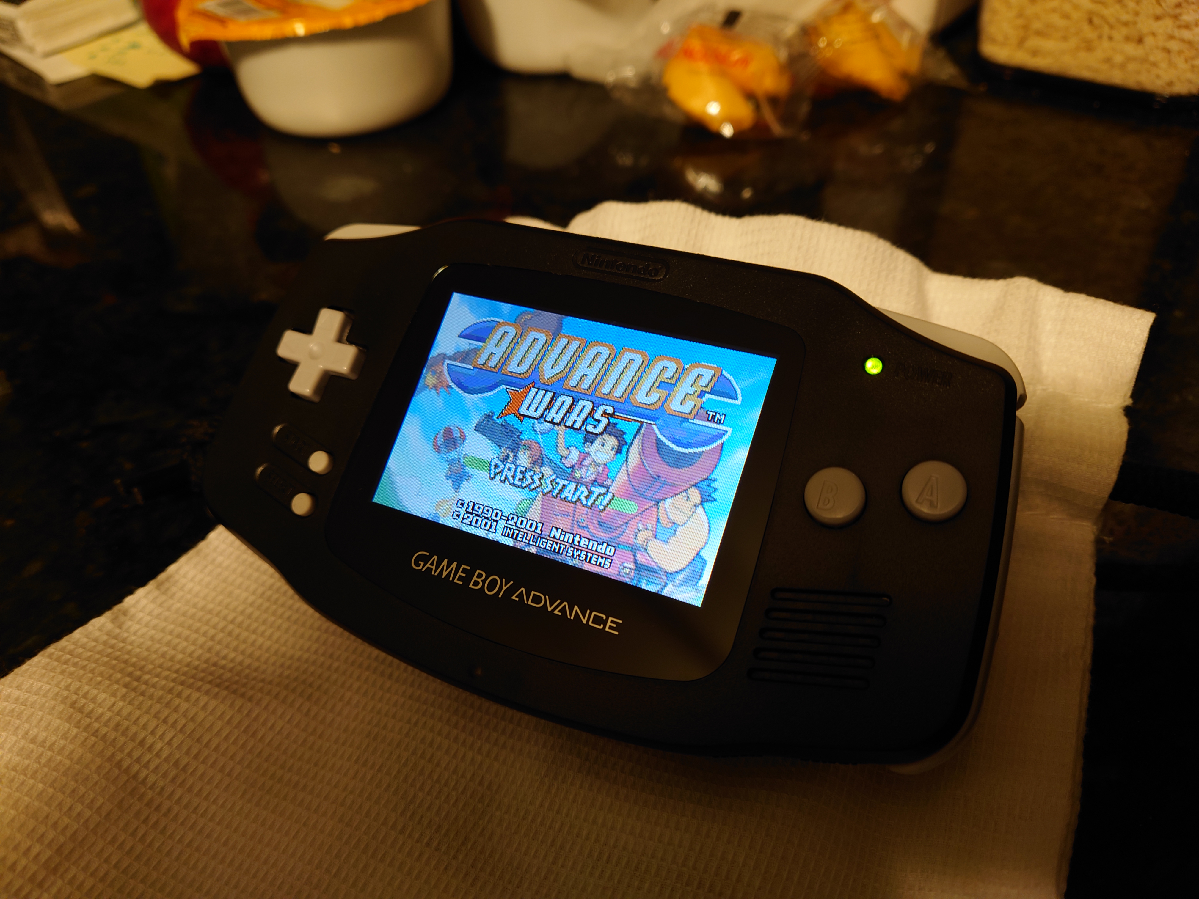

Beautiful! Yeah I found my ITA screen didn't need any adjusting when I went to calibrate it. Idk if that was because it was taken from a DSi rather than supplied separately, or if they often don't need it.
And yeah, similar to the touchscreen thing, the older cable adapter for my ITA screen (before they started offering the laminated ones) came with a little touch panel that sat inside the top edge of the case, as an optional adjustment method if you didn't solder the button controls. Unfortunately it kept activating randomly, and I had the button controls hooked up already, so I just physically cut off the little flap of flat cable that had the sensor on. Gotta mod that mod!
Why didn't you change those tiny leds on the 4 ring power button to match the color of the inside leds? :D JK. Looks nice!
The touch control thing hasn't changed, it's still the flap that folds in under the top edge of the shell. But I've read people have had problems with "ghost" activations of the OSD turning on even after that flap is cut off. Removing the touch sensor chip off the screen adapter PCB negates the issue absolutely, and without affecting the SEL-L-R button method of control.
