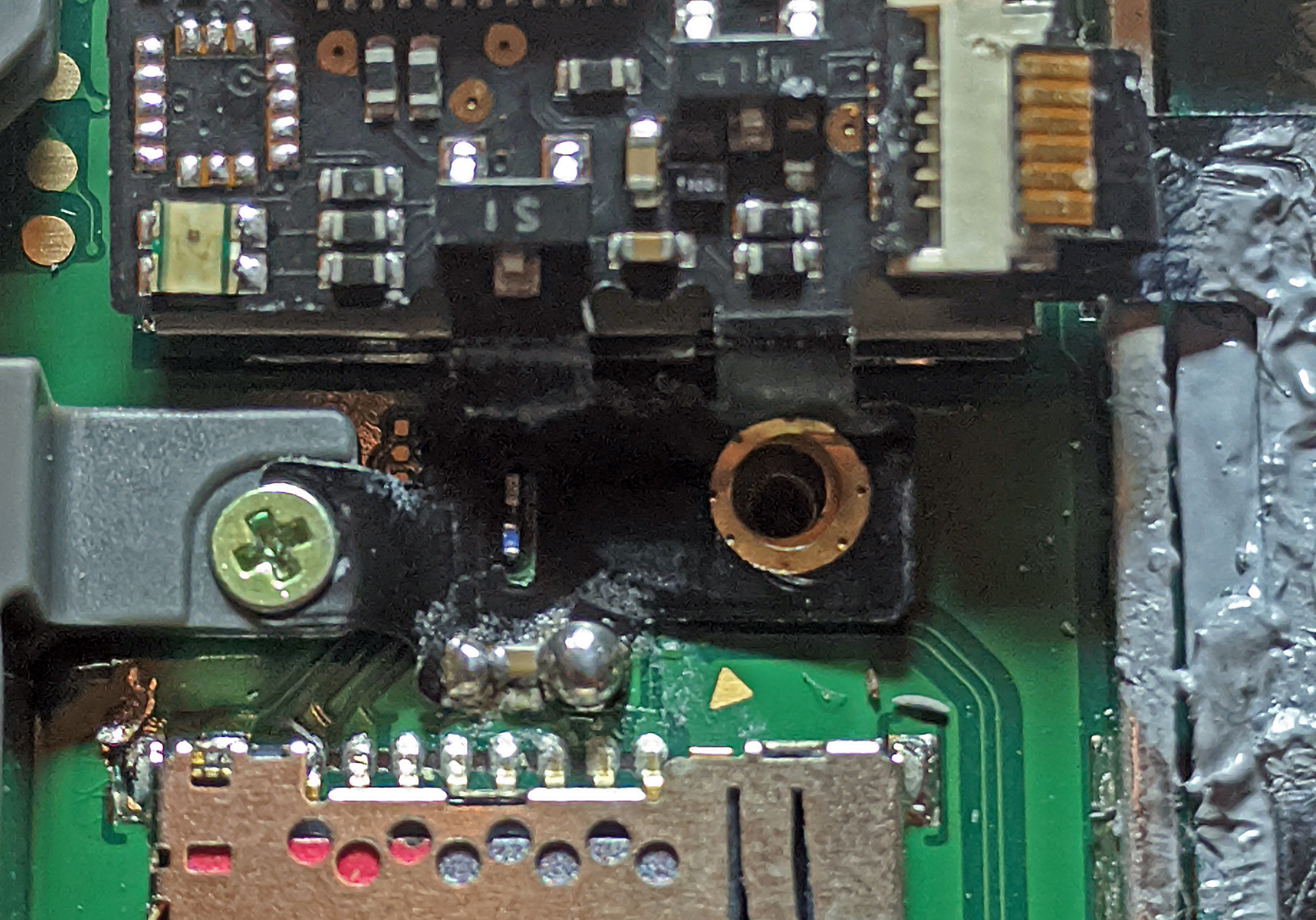

Who else here accidentally fucked up when installing the sx lite? I didn’t realize my iron was too hot and kinda burnt a hole in the flex cable for the nand points :rofl2: will my lite still work if I take off the mod chip? No pcb was hurt in this accident
Remove power from cip , the 2 cap solder points next to micro sd connector , or just disconnect the qsbs, but inspect first for shorts bridges etc, or go to a pro if you are not shore @ModderFokker619

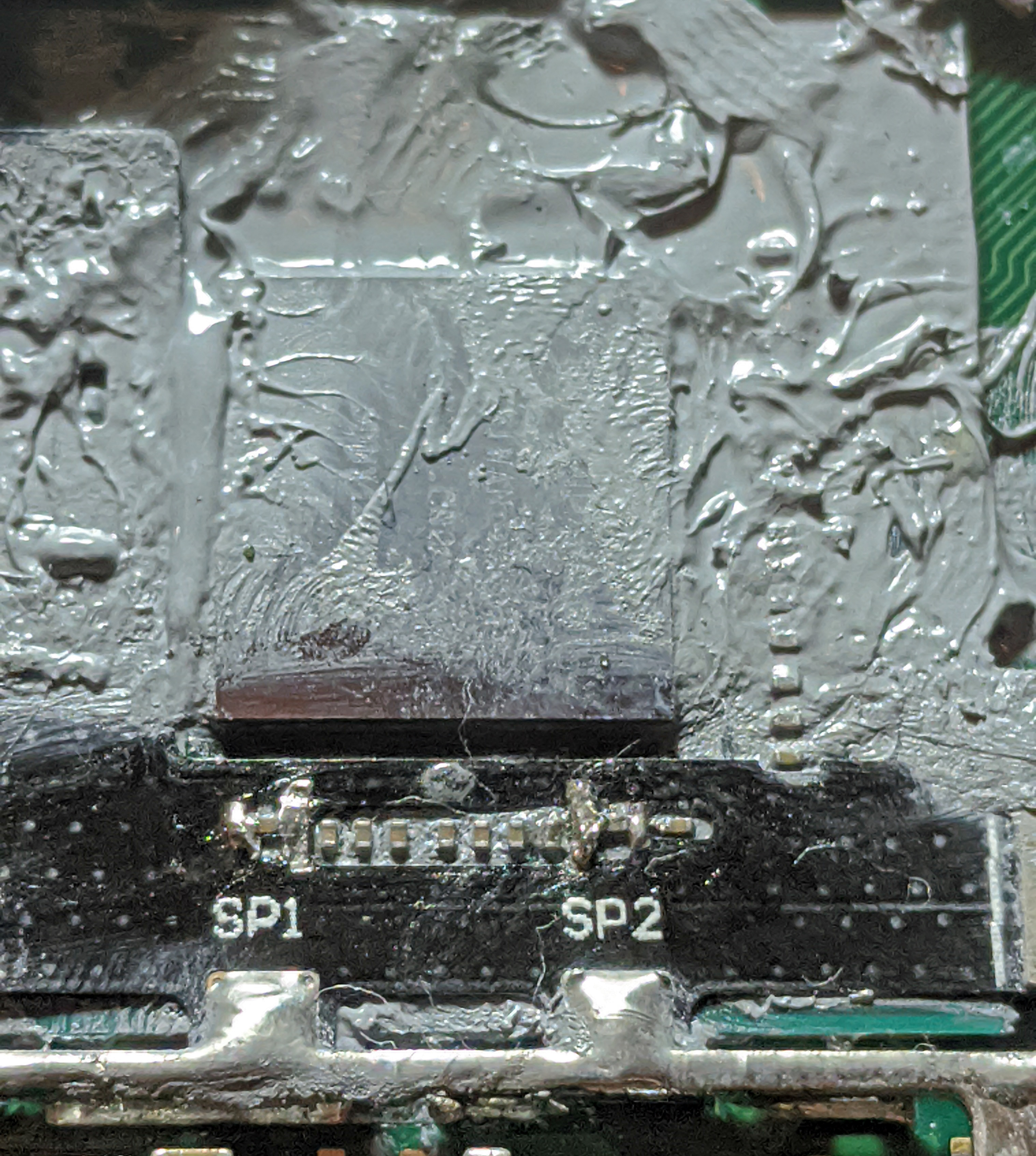

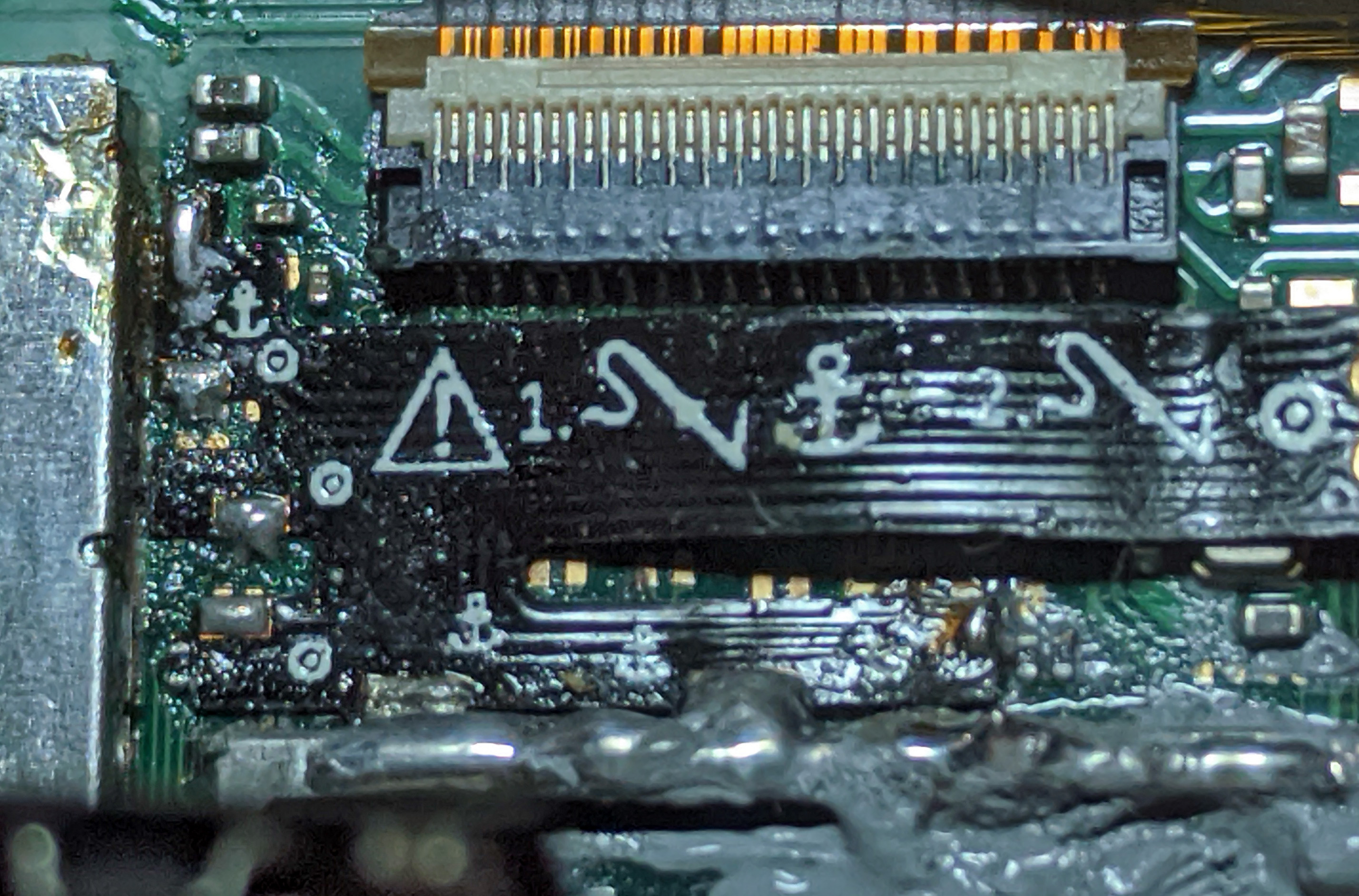

In the next days maybe, i'm not promising anything i need time , i will map the alternate points for the nand qsb to sx lite , for using wires , like the good old days rgh days.
was gonna say cant you just solder wires from the nand points to the 5 bypass points at the end of the flex cable itself
Reactions: Modificatorul
But if the qsb cable is broken, hole, you don't realy now exactly were to go from lite mb nand points to sx lite pads , and solder, except when you have a good one or folow the tracks from a good picture i see you have one in the signature :), ia is pointless weist of time to make a pinout but is easyer to folow if is colored difrent collors etc.
