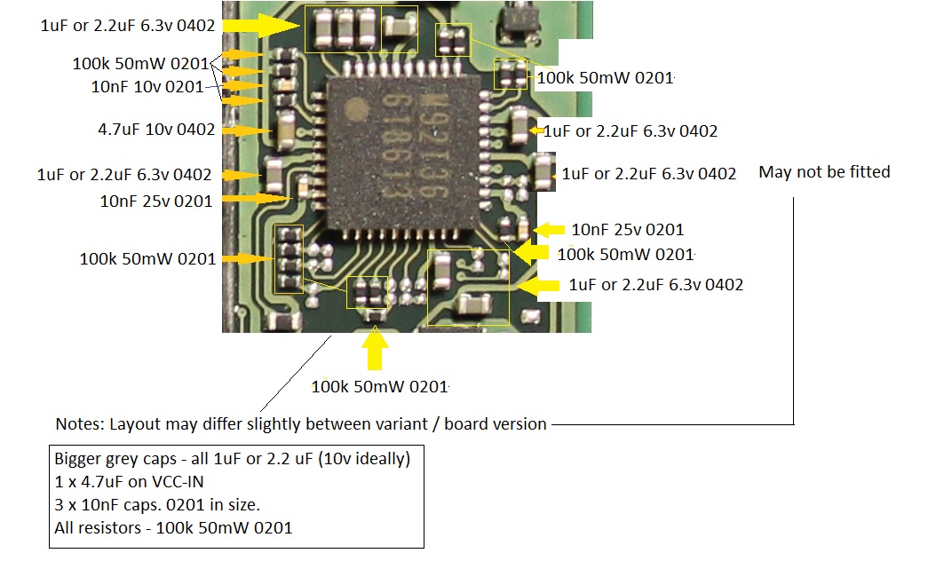

I lost the resistor in the top right corner. Can you tell me which one I have to order?

I removed the M92T36 with 420°C using a Yihua 8786D station, on 3/4 of its max. airspeed

How do I solder the capacitor? Using hot air or solder iron?

Should I remove the one on the left first?

Can I use the resistor from the pdf file?
