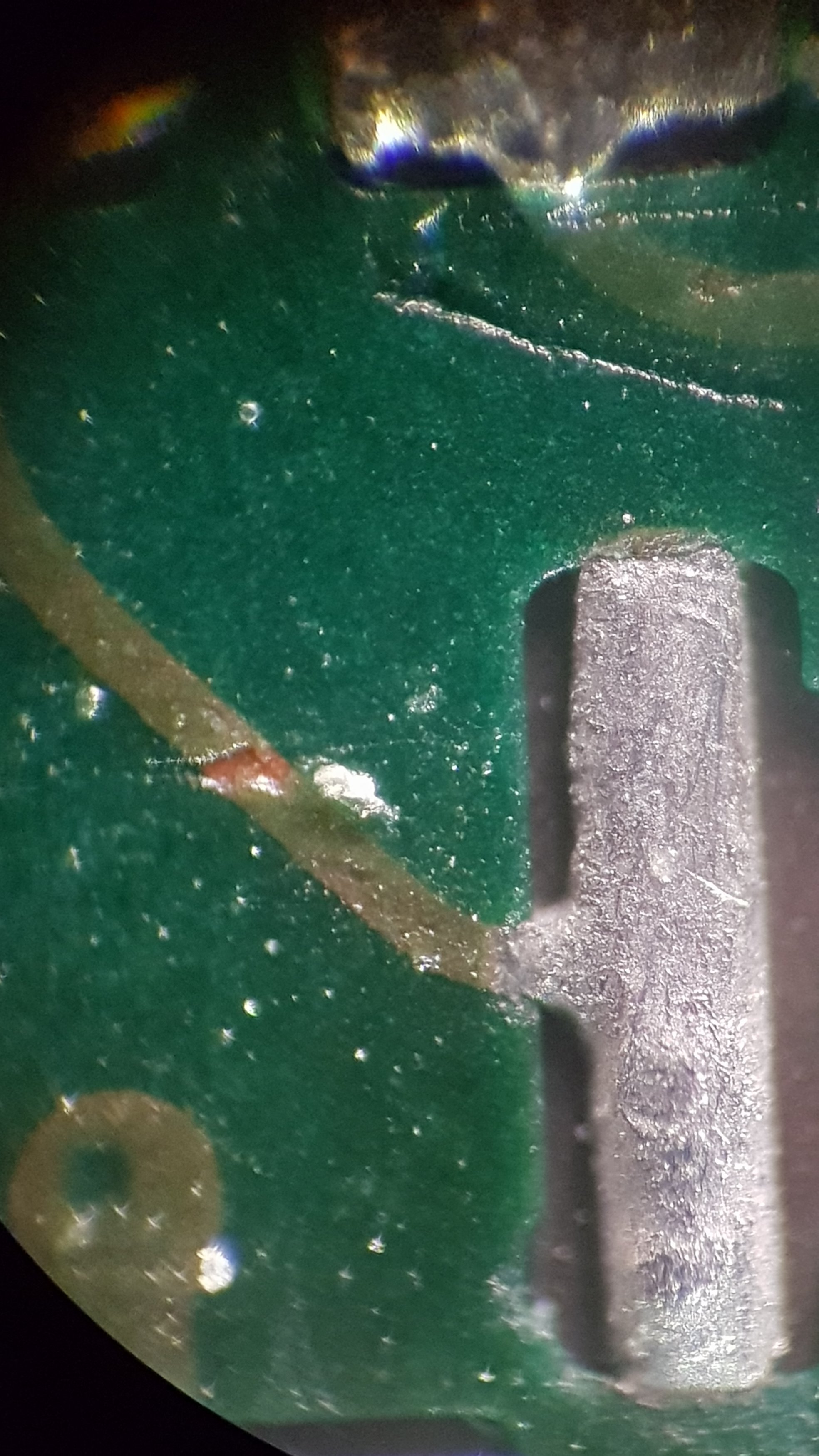

The solder that bridged the resistors somehow vanished... But I noticed this:
What happens when I bridge the missing resistor?
I took pictures of all pads that look suspicious
Clean the board, make sure there is no bridged pads, overall it's looks good.
I personally don't see any damaged traces, in some places you have lost mask but it's very minor.
If you skeptical about traces just use you tester in continuity mode.
