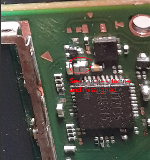

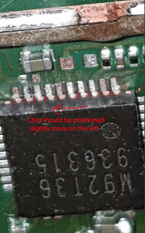

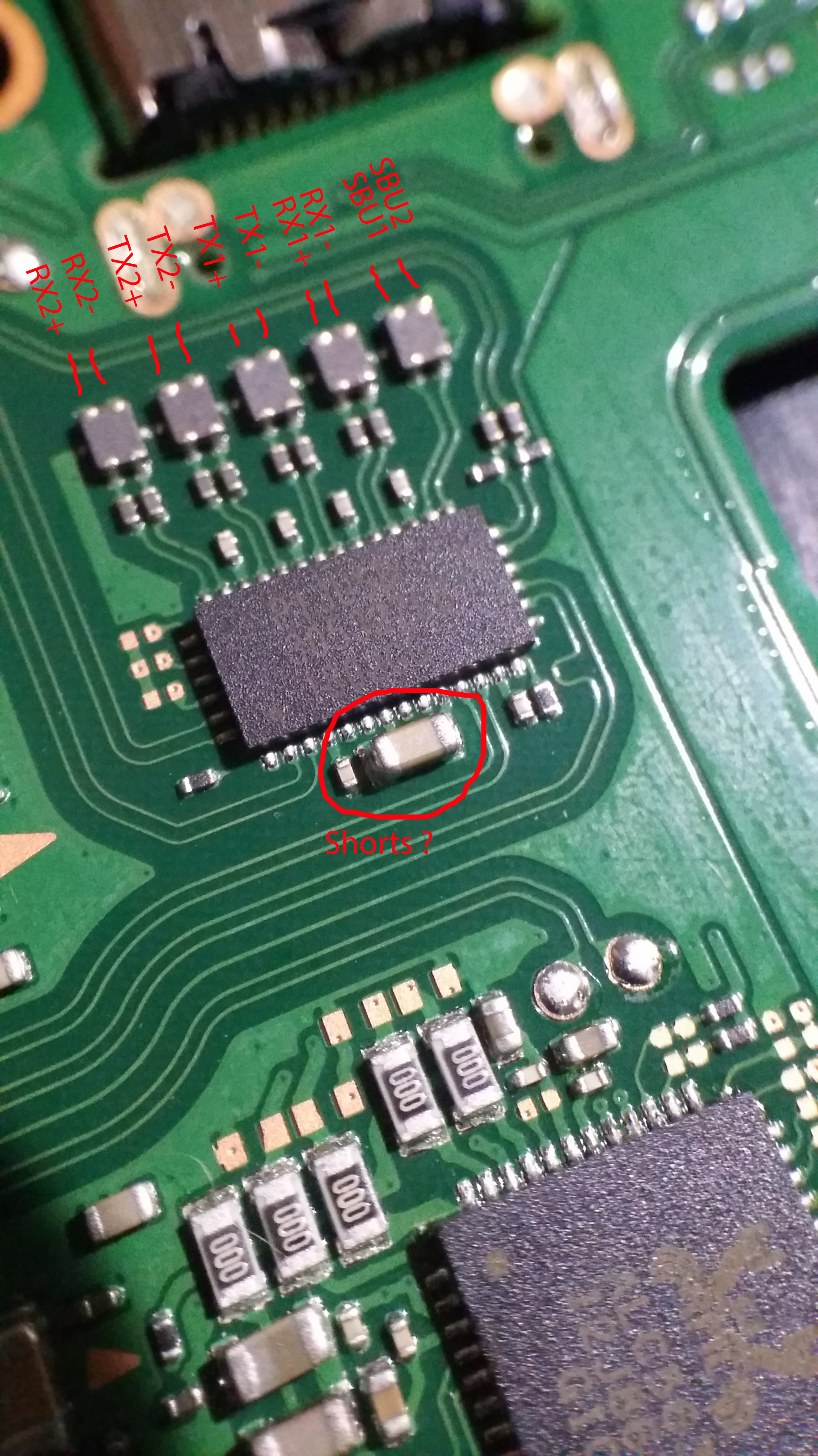

You did a good job to replace all missing components that were blowed.
I know it is difficult to find the good feeling with chip alignment when you begin with this kind of component. But you should really try to realign the chip.
See picture attached for your chip aligment. Can you please send us pictures to see the other faces of the chip ?
You can check if there is no more shorts on PI3USB (see picture) and also nearby M92T36.
I have doubt on picture quality regarding capacitors spacement (see attached)
Please double check these points before powering the motherboard to avoid burning components and maybe ruine you motherboard.

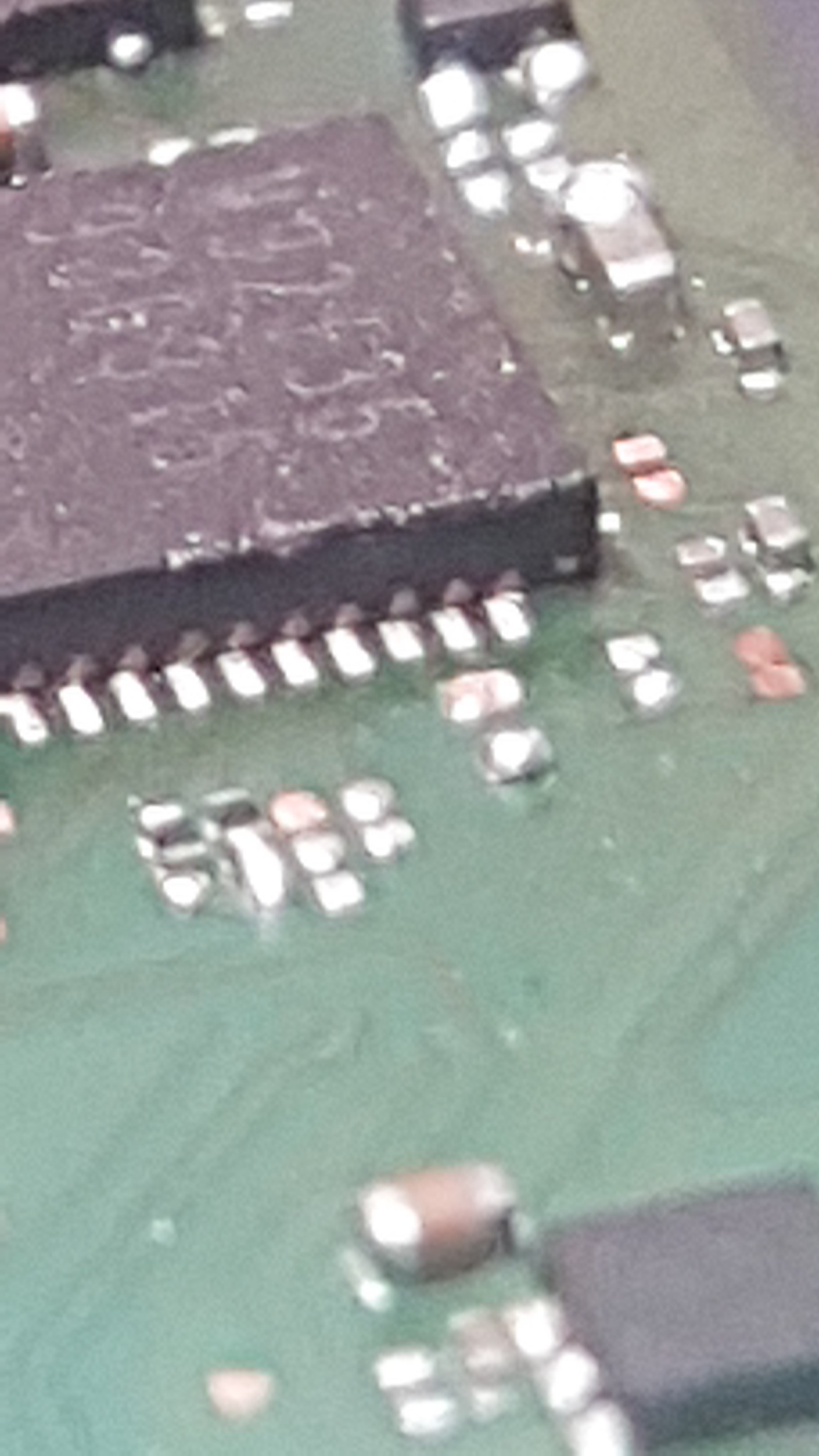

The M92T36 looks gorgeous now except for some scratches (I know that it's still missing loads of components, but I think I can fix this Switch)
Is this a problem?
