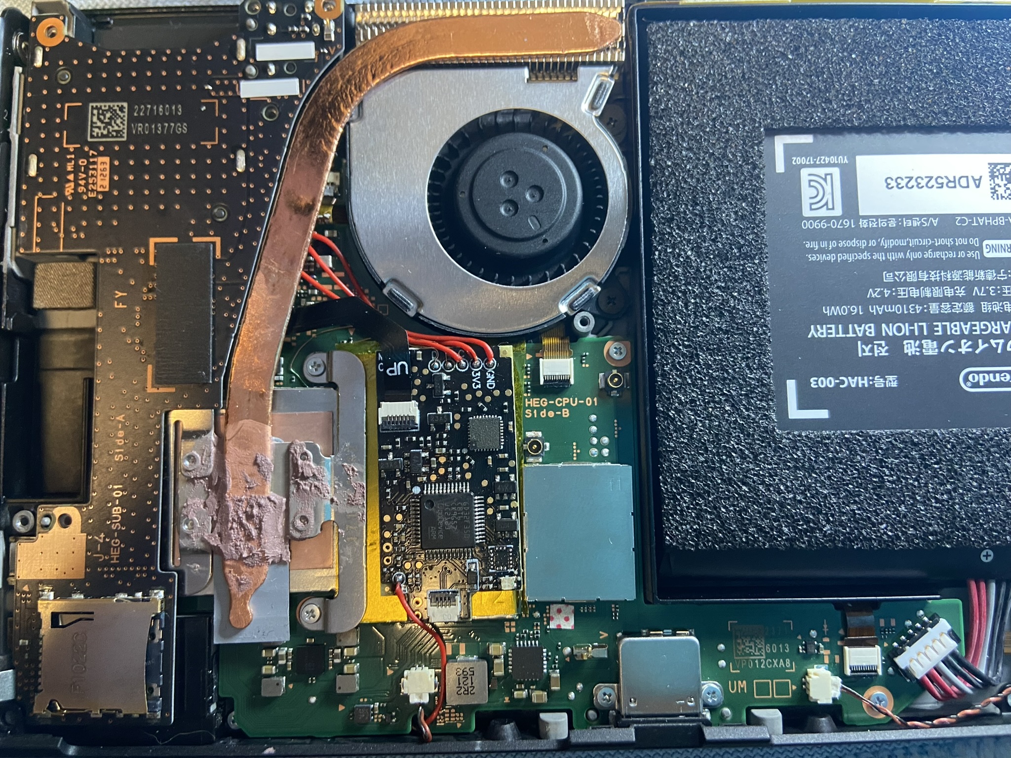

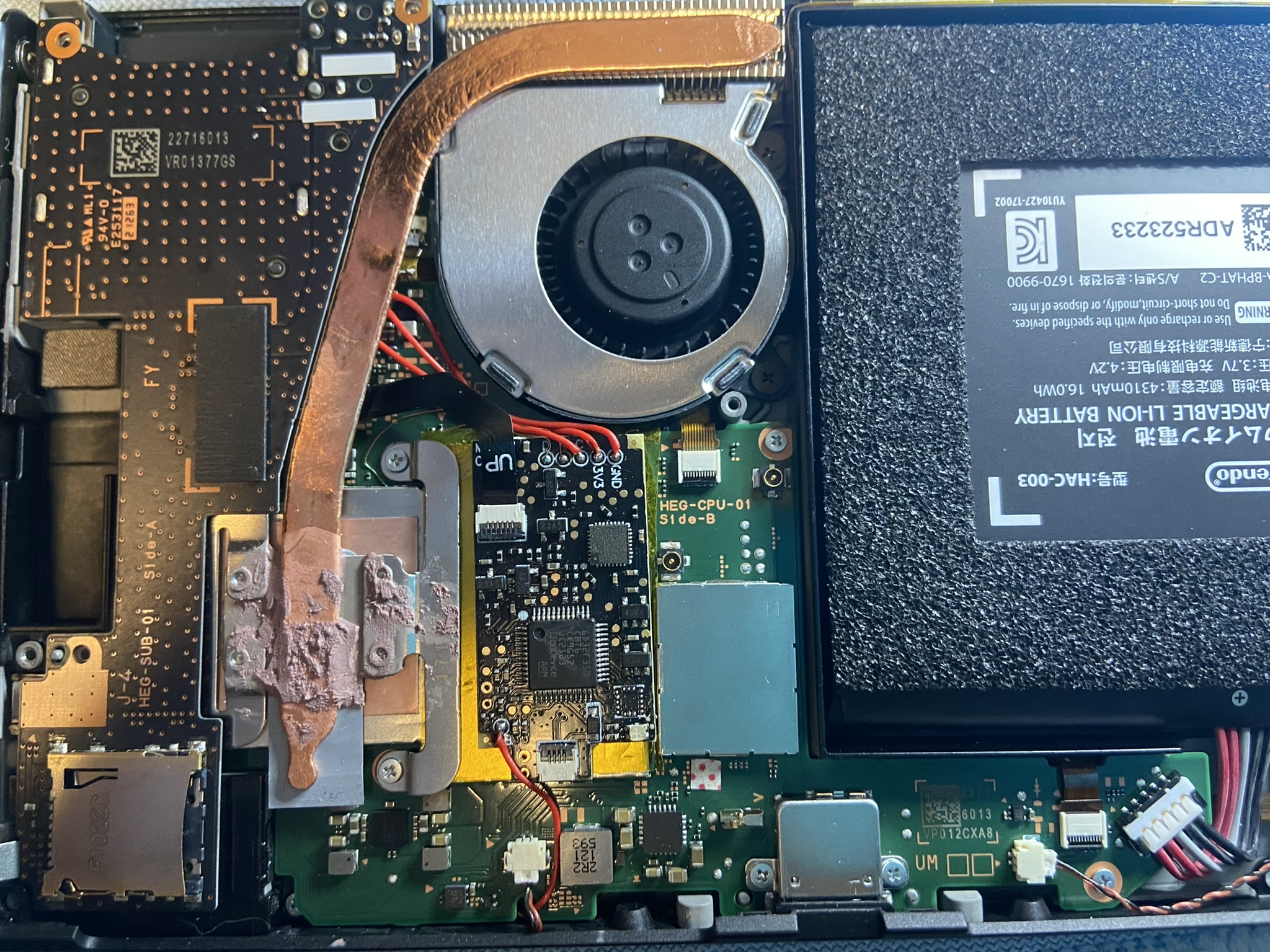

Installer set up the OLED chip for me yesterday. Noticed that the left two solder points are using what appears to be sleeveless/bare wires. Is this going to be an issue?
The Switch itself works fine and I'm pleased overall. Glitches within 5 seconds and works without a hitch. A bit of a bug when shutting down though where it goes back into Hekate so I have to shut it down through there.
P.S. Does anyone know that that pink gunk is? Thermal paste to transfer heat from the heatpipe to the metal shield on top?

those are enamel wires, and they are ok.
setup autohosoff from Hekate setting
the pink gunk is thermal paste from heat pipe to the metal shield

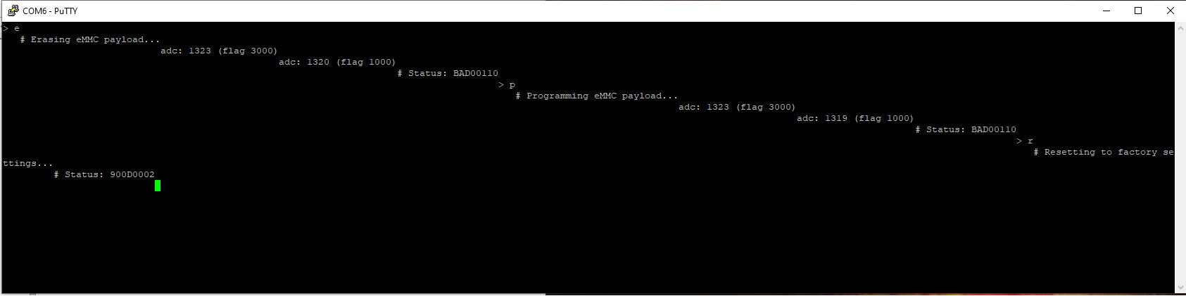

try if you can access the emmc over USB; poweroff the switch, plug in the USB, connect over putty to the COM port that appears, hit enter on the prompt, then press 'e' (for erase payload) and 'p' (for program payload), that'll tell you if modchip can communicate with the emmc

modchip usb. prompt after opening USB connection in putty
Now I understand, PuTTY is a program.
Is any pre-configuration required?
What will the program say if the modchip sucefully communicate with emmc?
What if I can't communicate?

Modchip can't communicate with eMMC. Check your dat0, cmd and clk points (measure voltage drop in diode mode on DMM). Possibly your 3v3 but that's most likely good.
