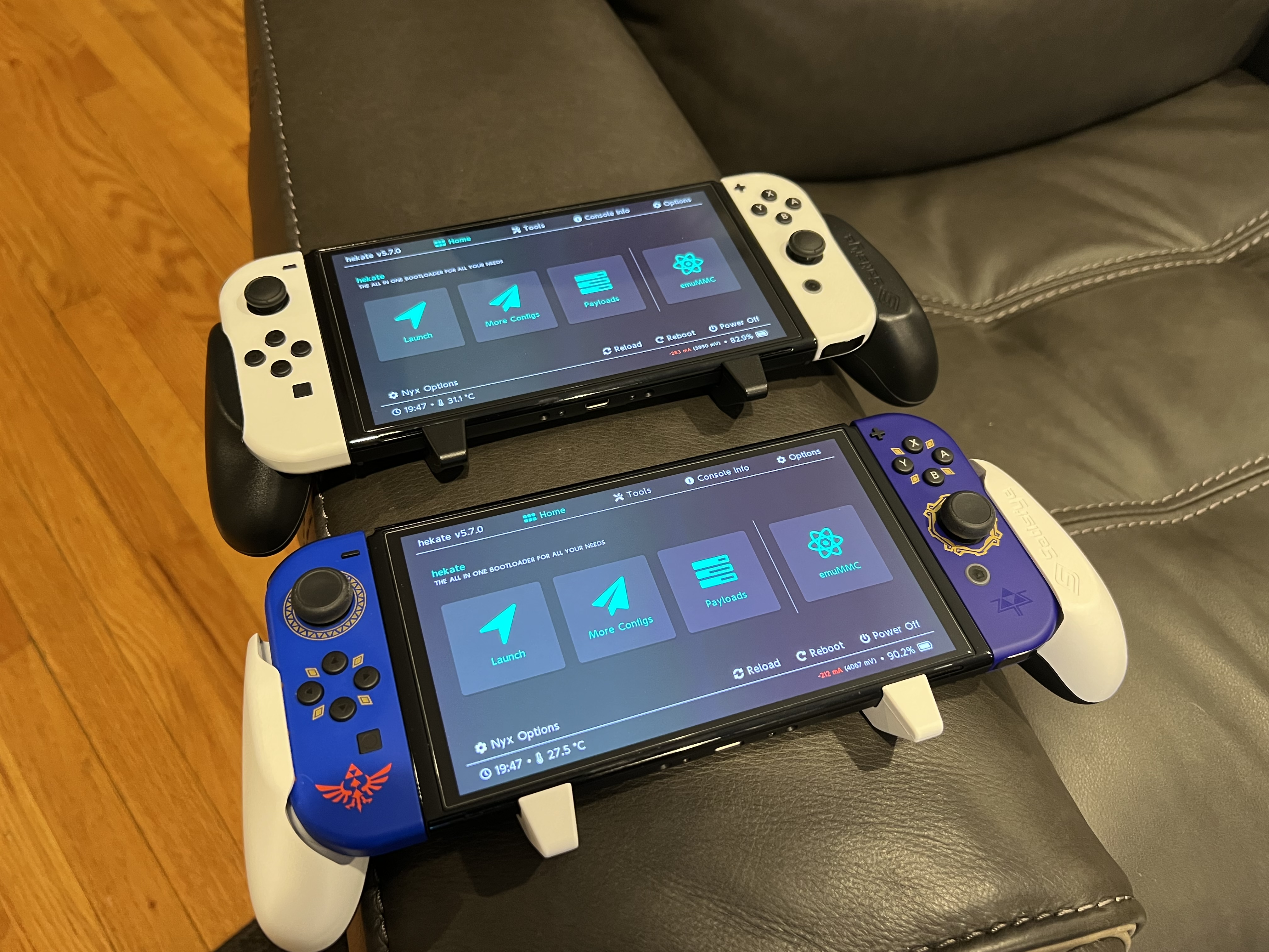

Just wanted to give a shout-out to @de9ed !
He’s the real deal and installed 2 modchips in both my OLED switches. I play primarily in handheld so OLED is definitely worth the upgrade and costs of the modchip and installation.
I actually tried to do 1 install myself and it fried the switch. I thought I did the install right and all the diode values were correct, but yet I still saw some smoke after turning it on to test. So lost confidence in my skills and decided to have a pro like @de9ed do the installs for me.
