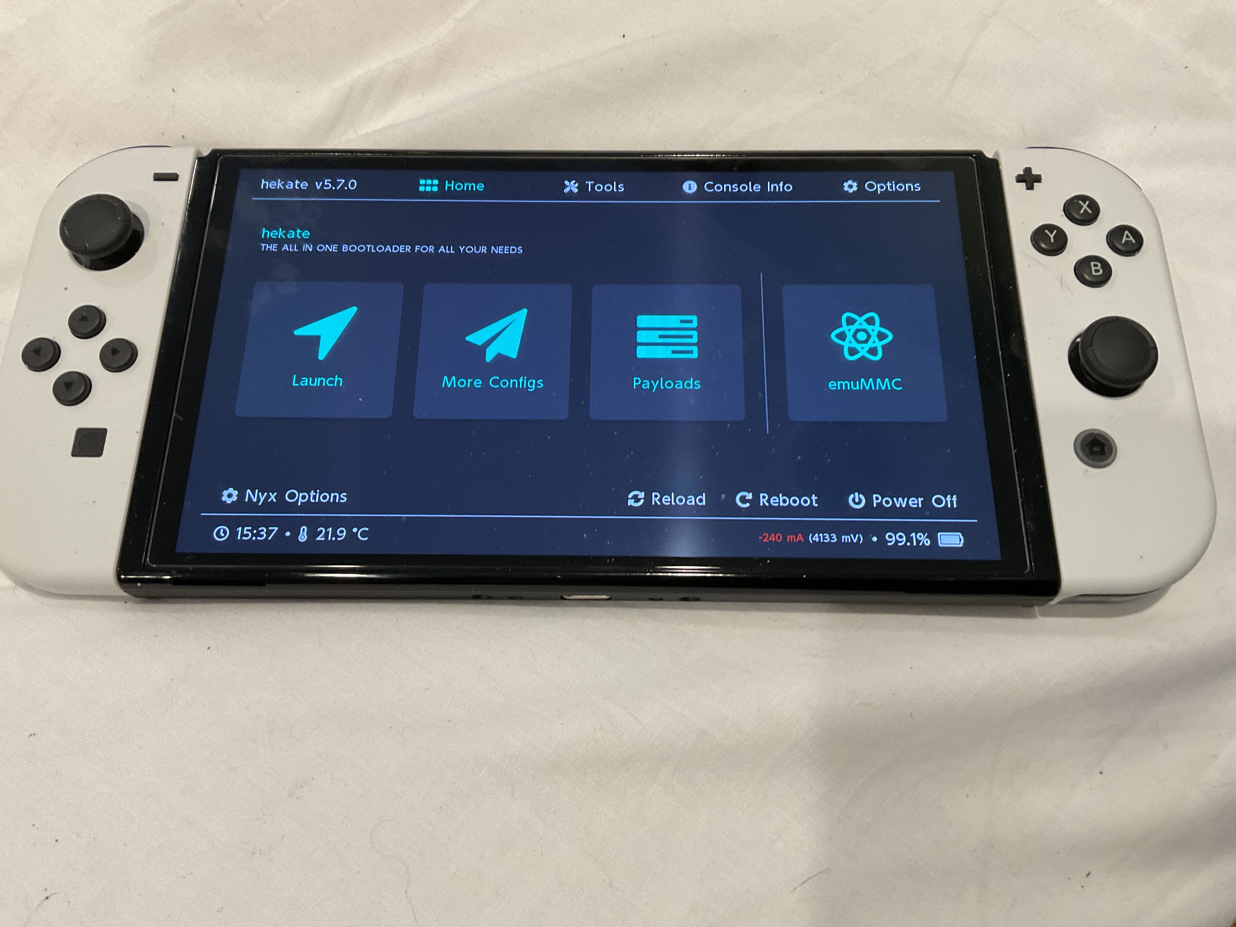

De9ed did my Oled for me. Very fast, great communication, and reasonable prices. If you see some of my earlier posts, you will notice I tried to do an HWFLY lite in Oled (before the new Oled specific version) and botched it pretty bad. De9ed helped me out and I have a wonderful Oled with Oled chip running beautifully.
