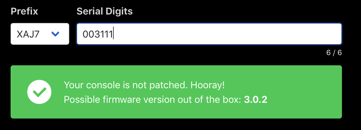

Yo guys. I wanna install custom CFW on my switch but im not sure if my switch is patched. Site ismyswitch tells me that my switch is patched but serials info from your site and xecuter show that i still can install CFW. Im reading it wrong way?
My Serial Number is XAJ70031114XXX. Soo my question is: Can i install CFW on my switch?
