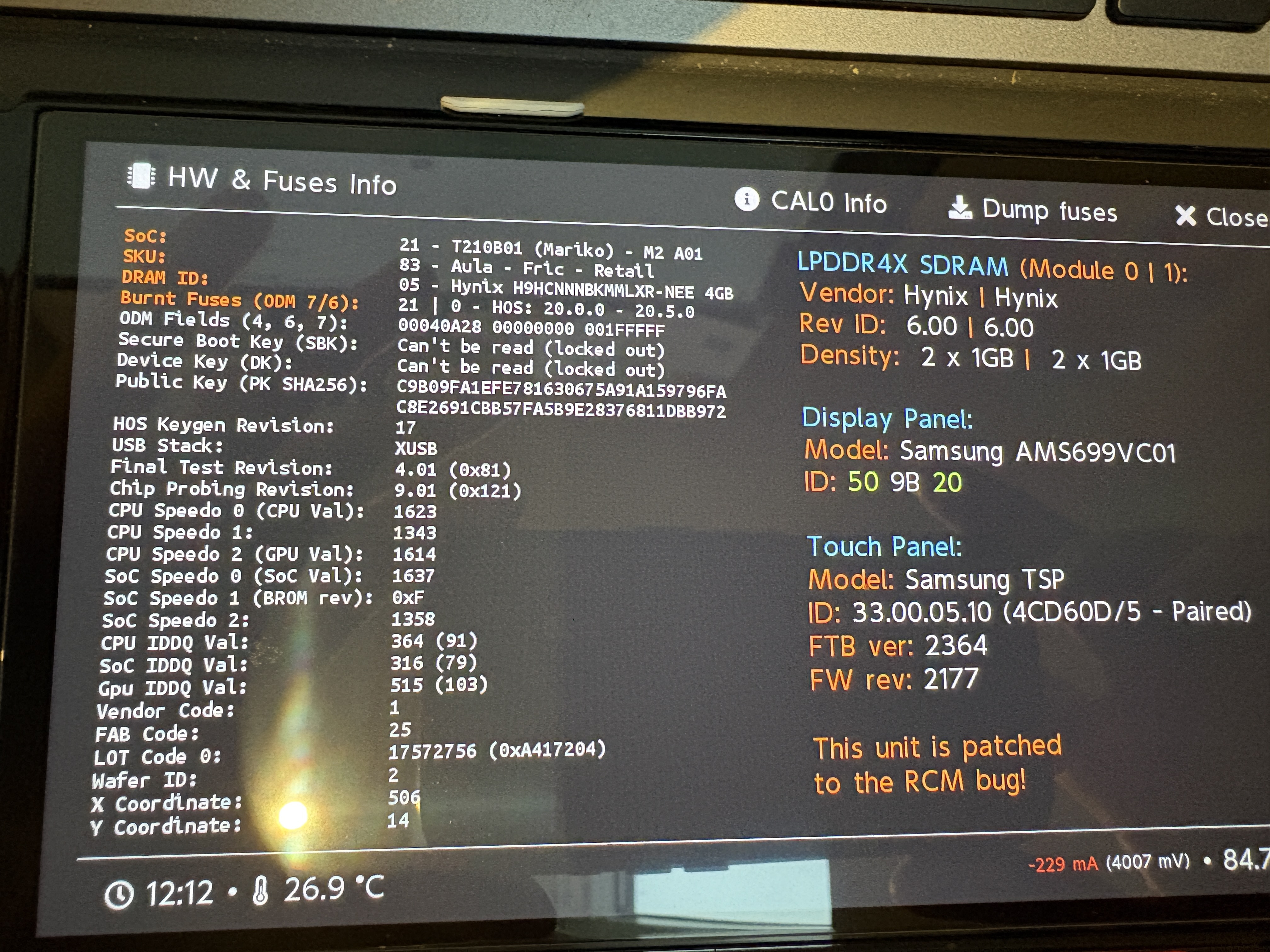

i have an OLED with an annoymous S/N (donated motherboard) which I don't have the prod.keys (see the error on secure boot key and device key) to recover hence is permanently ban. I can't use the Nintendo servers to update the firmware will get the 2123/2153 error.
Anyhow I have update to firmware 21.0.1 via daybreaker both SYSMMC (semi-stock and cfw) and EMUMMC. However, I can't boot to OFW since I get blackscreen which I think is due to fuse mistmatch. How can I force a fuse burn so that OFW boots?

So I have updated to 21.0.1 with daybreaker. Both semi-stock and sysnand boot but not the OFW (blackscreen). Also if I am in semi-stock for a few minutes I get the 2123-0011
Your fuse and firmware doesn't match if you are on 21.0.1 on sysnand.

I have the latest HATS release (HATS-21112025-00b00fd.zip) so it has the fuse.bin for 21.0.0 (includes the Atmosphère 1.10.0 ). Before I read your comment I restored the firmware 21.0.1 with my prod.keys using the EMMCHaccGen to create the package and then TegraExplore to restore it (followed this procedure Switch Unbrick Guide - Such Meme, Many Skill's Dumping Ground).
Current state change:
- OFW and SYSMMC (Semi-Stock): before total black screen - now stuck on nintendo switch logo
- SYSMMC (CFW): before would boot - now black screen
- EMUMMC: working well as usual (expected didn't touch it).
Do you think that the fuse for 21.0.1 will be different than for the 21.0.0 ? If so I am stuck until a release by Atmosphere.

Well the thing is the fuse is burnt when you boot into OFW or Sysnand CFW on an OLED, sound like problem with NAND.

I finally managed to fix my console.
The issue was the PRODINFO partition, which was damaged on the sysnand. I used TegraExplore to copy the PRODINFO from the emummc to the sysnand. After that, the firmware booted normally.
I still get the usual 2123-0011 error, but I added a DNS redirect that points all Nintendo servers to localhost. With that in place, it no longer crashes in Semi-stock or CFW. On the official firmware, it still crashes if I try to go online, but that is fine. I also use a donor prod keys to install a game cert so I can play cards (even if I don't do that much).
I now have a stable sysmmc that I can always clone to emummc. The console is banned and in a strange way. Someone (previous owner of this motherboard which was cheap and I knew it) anonymised the serial number, so it cannot update software through official channels. I have to use Daybreak for updates. But for local gaming works-flawless and I never play online so is perfect.
