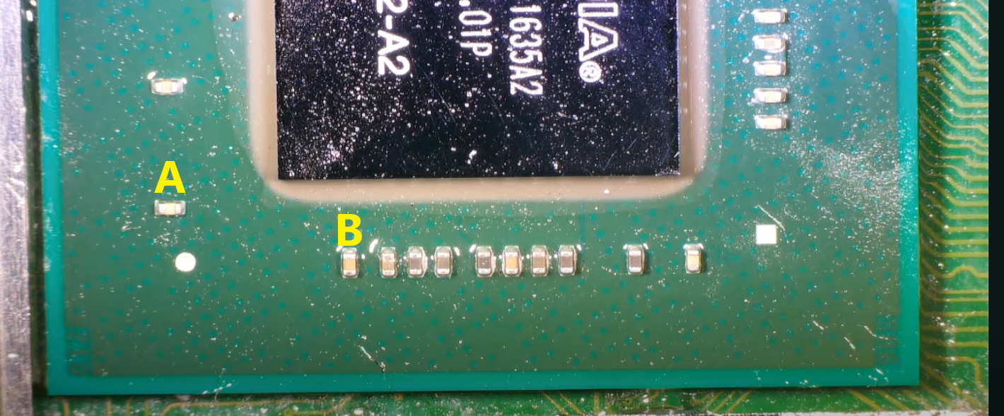

Hi, I installed a Picofly RP2040 V1 on a patched SWITCH.
At first, it worked well. But after a few hours, my switch stopped working.
The screen stay black and the LED of the picofly only shows blue light flashing from it's led.
So I removed the picofly set up entirely, but the Switch still doesn't power on.
I figured out the following:
- Firstly, the left capacitor (named B on the picture) where I connected my picofly V1 died (no color visible in the middle)
- Secondly, when checking the Ohm value of the capacitor around, I figured out the one on the left (named A on the picture) show 0Ω when I use my Multimeter on both its sides.
So here are my questions:
- If I try to replace them, what are those capacitor references to buy some?
- Will it works if I use those one from Aliexpress {item/1005006048549738.html} (copy in picture Capacitor ref X5R 0201 1UF 10% 6.3V)?
- Should I replace the one with 0Ω as well, or it is expected to show this value?
Many thanks for any help you can give me. :bow:

QUESTION FROM A NOOBE
(who f*cked up her sister's switch, I beg you please help me! T-T)
Hi again, I cleaned up all the board with solvent and removed the excess of tin on my solderings.
I discharged the capacitors with my Ohmmeter and waiting some hours.
Now the Switch succeed to boot on the original firmware, but the battery showed low power (shows 10% according to the Switch, and shows 3.57V on the multimeter).
So I tried to plug the Switch to the sector through the USB-C, but then the Switch shuts down and doesn't start anymore.
So I disconnected the USB-C and the battery to discharge again the capacitors on the board.
Once the capacitors are discharged and I plug back the battery (without plugging the USB-C cable), the Switch can boot again.
Now I can confirm the Switch still works but I don't know why the USB-C charging make it stop to work.
Do you have any idea or tutorial for finding the issue ?
Otherwise, I find on the forum that the capacitor SP1 (named B on the picture) is not obligatory to make the Switch works but it's still recommended to replace it.
But I didn't find any information about the one on the right (named A on the picture). It still shows 0 Ohm with the Ohmmeter.
Should I replace it? What are the references of this capacitor (X5R 6.5V 10% 0201 as well?)?
I hope you can help me.
