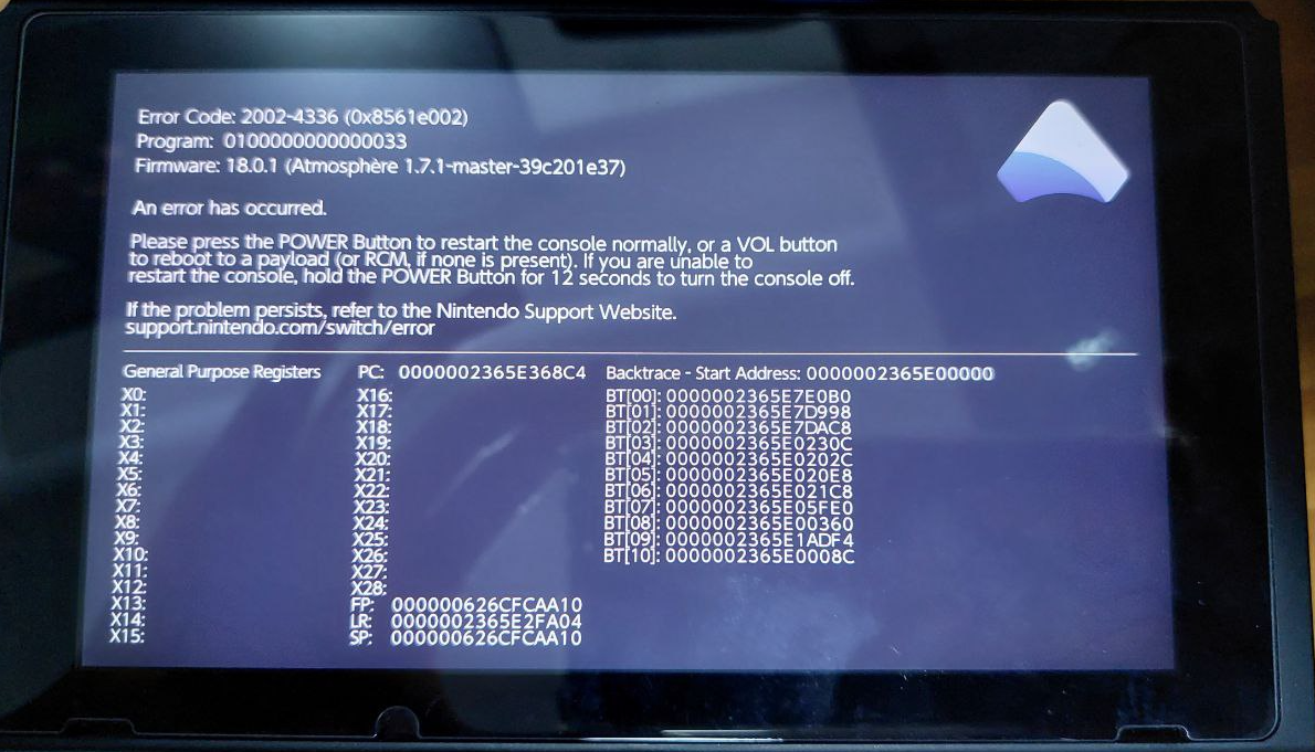

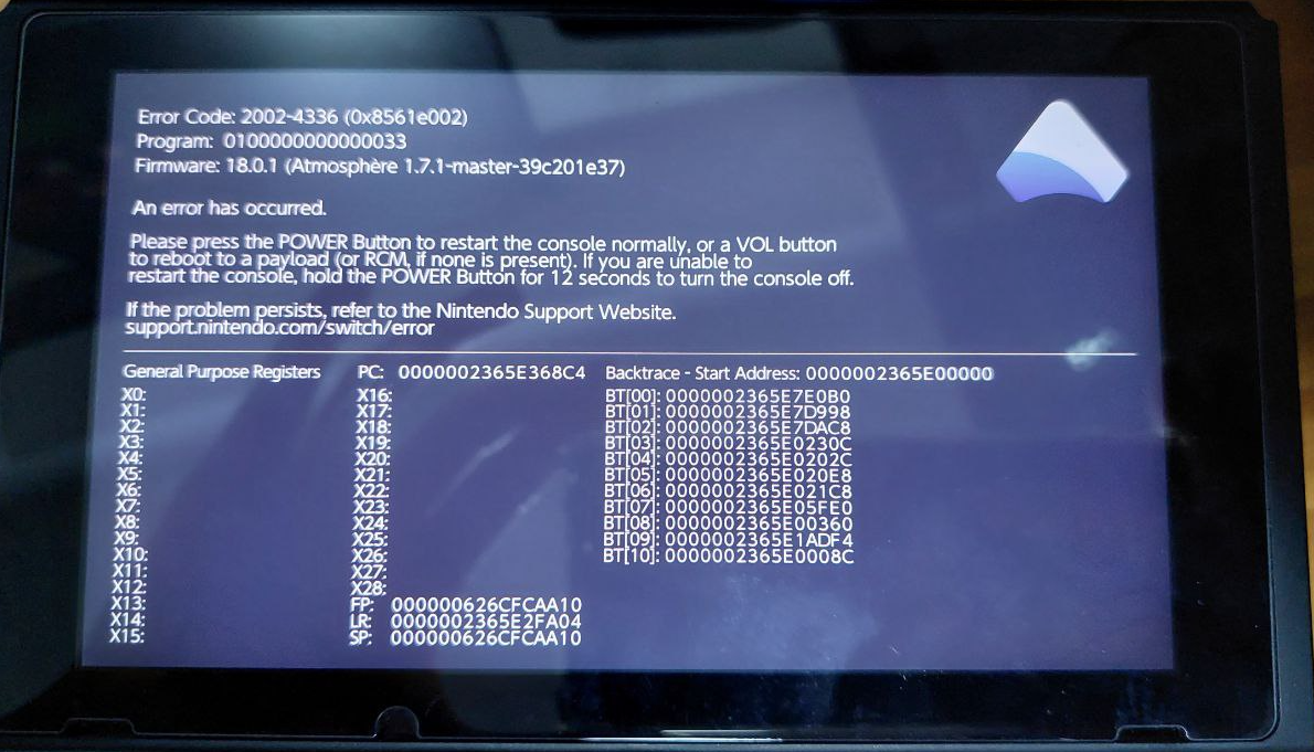

Currently i am still able to boot into RCM Hekate, but unable to boot into my emummc.
After the deepsea and atmosphere screen, this screen with error 2002-4336 will appear.
Is there anyways to fix this or restore is the only way?
Before this happens, i did a upgrade from firmware 16.x.x to 18.1.0 with deepsea dev v4.11.0
Met with issue of some games not able to load.
Decided to do a downgrade to see if the problem persist.
Downgraded firmware 18.1.0 to 18.0.1, with deepsea v4.10.0
After which unable to boot into my emummc and this error kept prompt
While inspecting my sdcard, i seen 1 of my folder with corrupted file, and unable to delete the folder away.
0100000000000033 IS THE ES TITLE (Encryption Services)
BACKUP AND REMOVE YOUR SDMC:/Atmosphere/contents folder and try again
STAY AWAY from prepackaged packages and update everything by your self.
