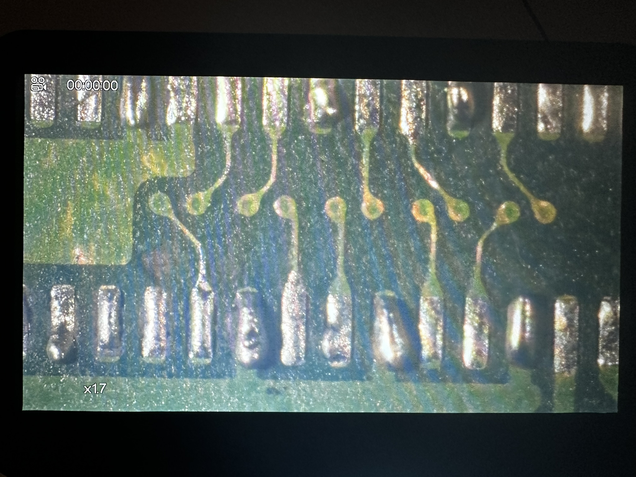

Trying to fix the oled display socket and i think i ripped a pad but i dont know. In the schematic it says N/C but i dont know what that means, also in other board pictures i dont even see a pad that belongs there so im confused af as to what is this and if i should be worried or not.
