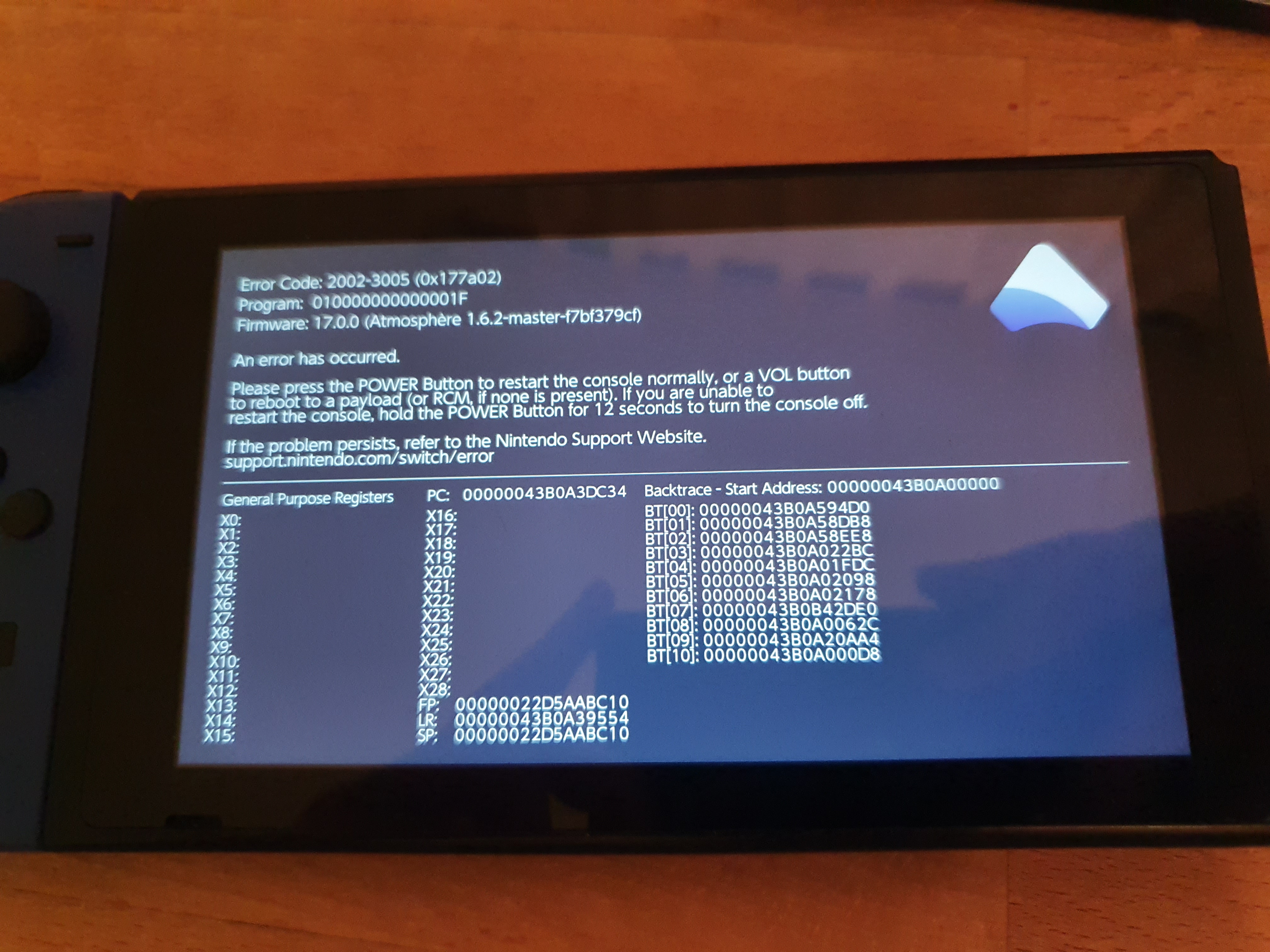

Today I wanted to update my switch to 17.0.0 so I installed the latest atmosphere release (1.6.2-master-f7bf379cf) and installed the 17.0.0 firmware with Daybreak. After the install was successful I rebooted and got this screen:

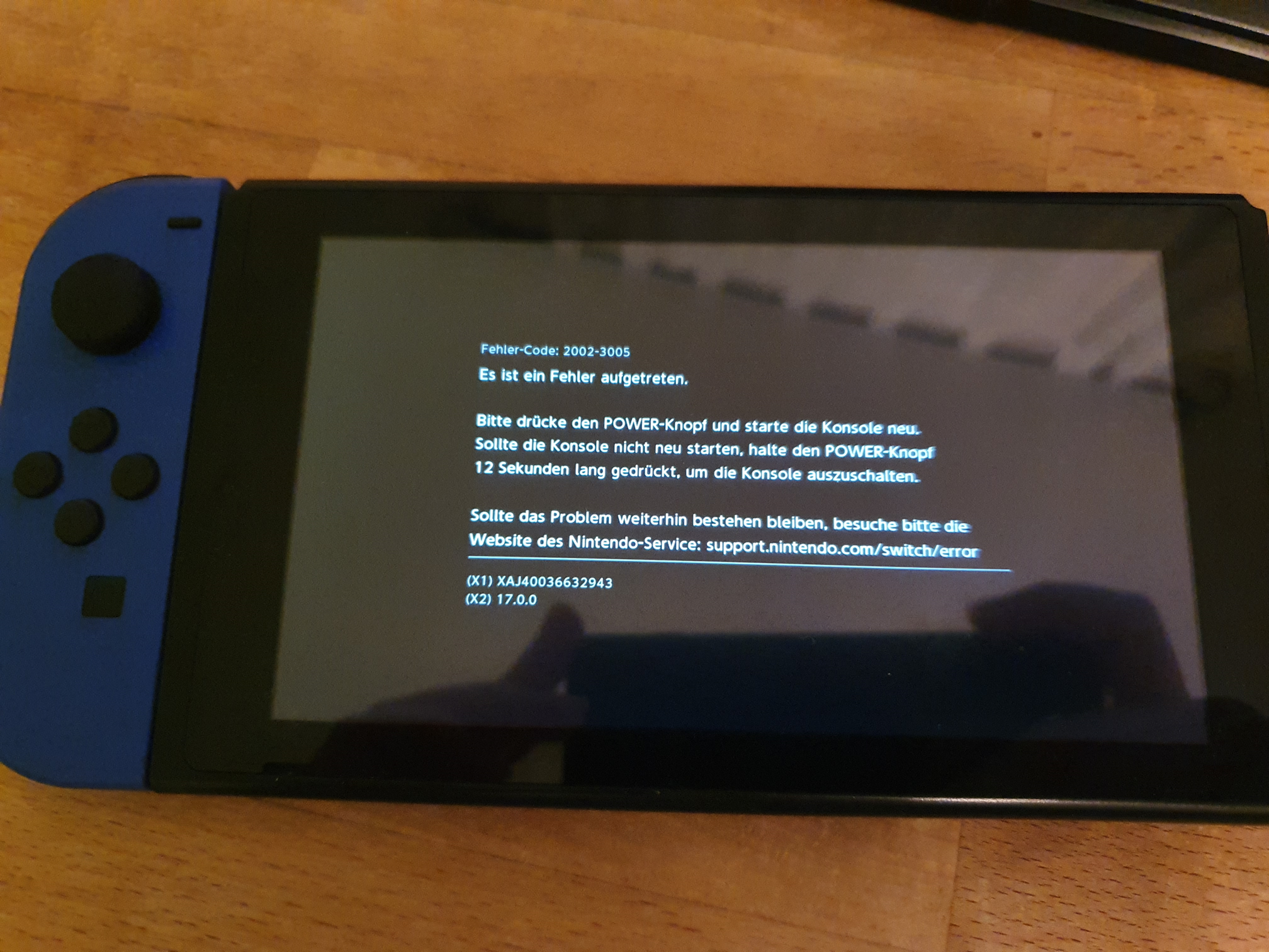

I then tried rebooting to OFW and got this:
Is my switch bricked?? What do I do?

Today I wanted to update my switch to 17.0.0 so I installed the latest atmosphere release (1.6.2-master-f7bf379cf) and installed the 17.0.0 firmware with Daybreak. After the install was successful I rebooted and got this screen: View attachment 404549
I then tried rebooting to OFW and got this: View attachment 404557
Try booting ofw with the sd card removed. I have only seen this error code twice, but both times it was the sd card causing issues.
