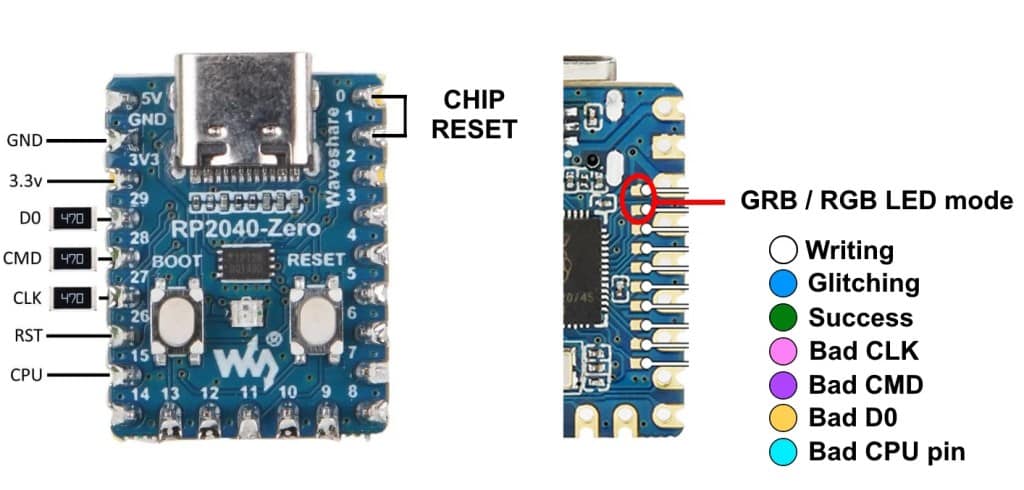

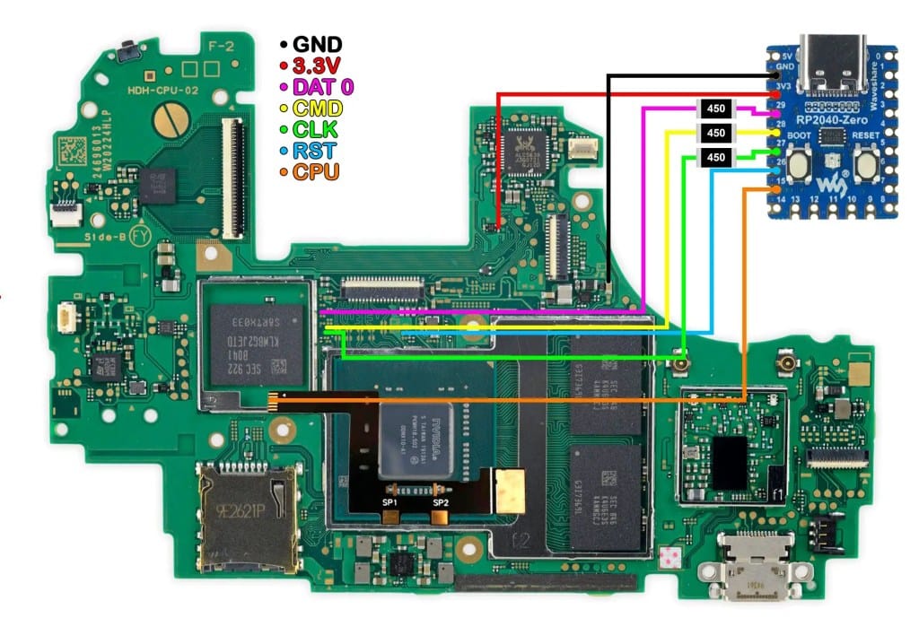

Hello, I've Done my research for a month or 2 now(hehehe). I think I already mastered the Installation process(watching videos) but regarding for the POST and PRE installation, I'm having a little trouble. I will be installing the Picofly in probably next 2 weeks(when it arrives) on a expert cellphone shop(expert micro solder technicians) and I need corrections if I have one so Kind Ma'am And Sir please help me and thank you so much in advance...
Im afraid to brick my only switch so preparation is key
Materials:
RP2040 zero
36awg teflon wire
47 Ohms SMD resistor 0603(couldnt get 0805)
DAT0 Yellow 4 anchor variant (stethix said this is the best/no reball=no problem[?] )
Flex cable (mosfet too risky)
OLED switch
used in Nswitch, with legit download free games from eshop - 256gb Sandisk card
PRE-install:
reformat 256gb card to Fat32
-skipping format sd card on legit switch
-put HATS pack by sthetix on clean formatted FAT32 sd card (PC +card reader)
-flash pico with 2.5+ unlock.uf 4mb by Vittorio
remove buttons and USB C
-flex cable solder ONLY THE 2 MIDDLE or 3RD AND FOURTH pins
INSTALLATION:
gonna follow this by sthetix also backing up with this by modsville USA and refering to the three pictures attached

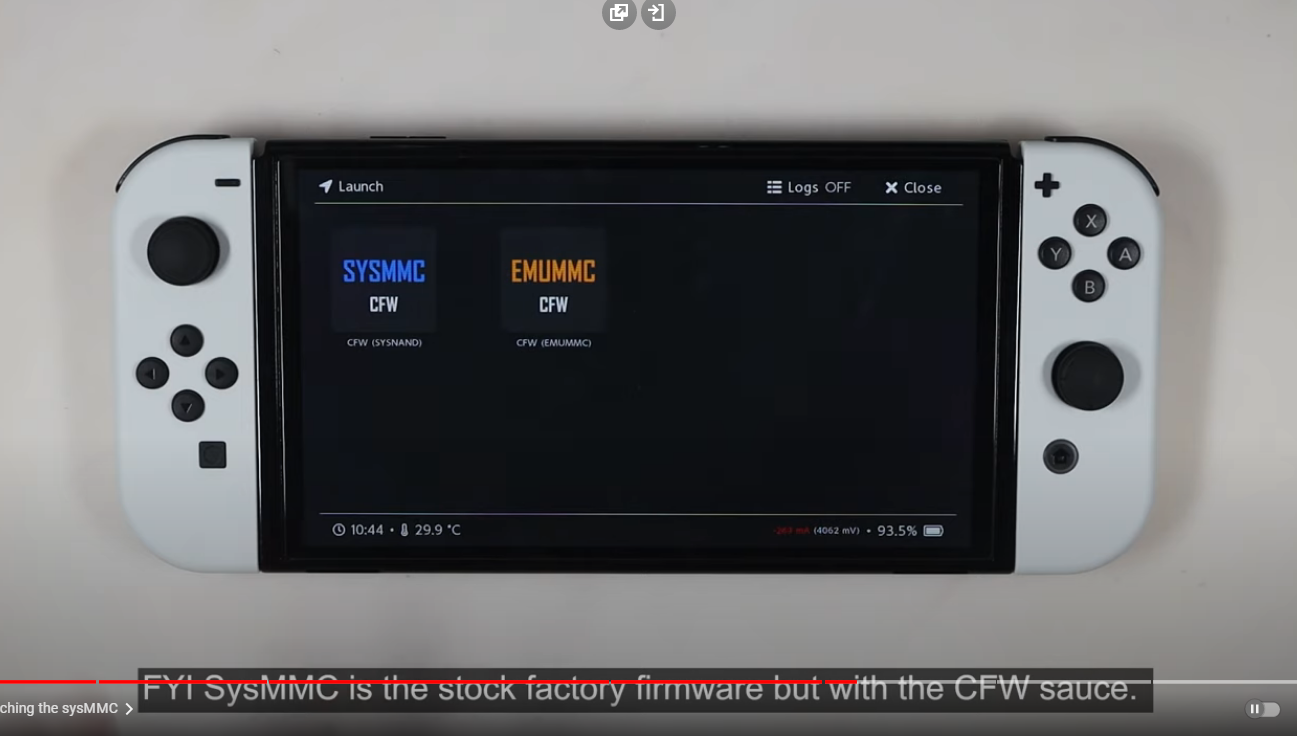

POST-install: this is the confusing part for me!!!
-gonna follow this by sthetix
- i dont know if atmosphere is already installed
-assuming i followed the video properly i should have SYSMMC and EMUMMC like in the picture. where is OFW ?
-is prod keys and title keys installed already like yuzu?
-how to Dual boot? like OFW and CFW EMUMMC . i researched but sthetix video regarding dual boot was RED OS not Hekate?
