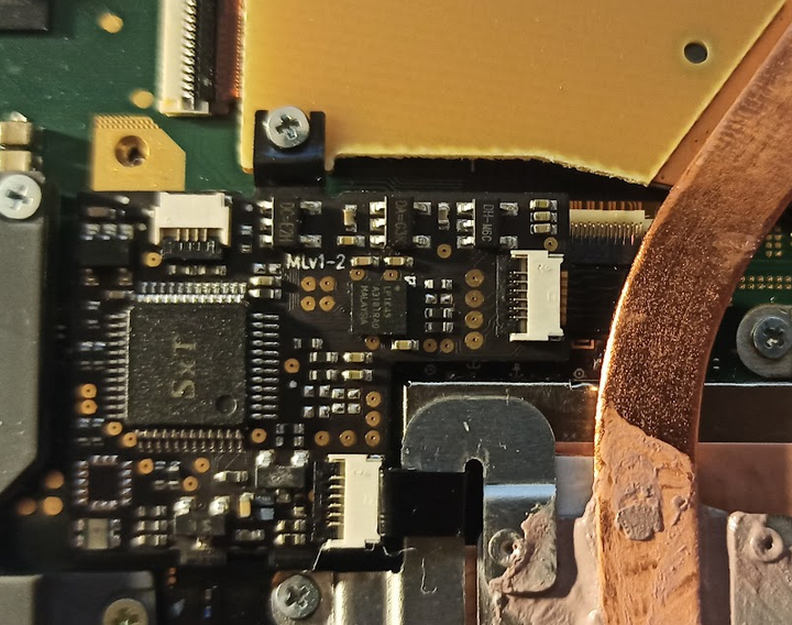

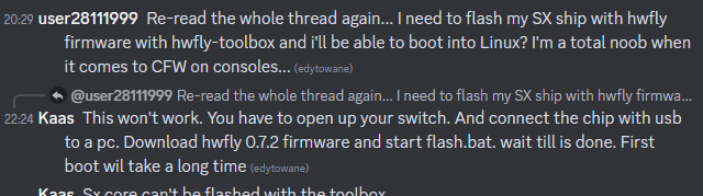

Hello, for the whole time I was thinking I have switch lite with hwfly chip (I bought it from second hand). However after I try to boot L4T (Atmosphere and OFW works perfectly) I've got error "Board was not initialized properly! Hang prevented. Board will reboot in 10s…". After searching a lot of sites I got suspicious that I dont have hwfly but maybe spacenx/sx chip. After disassemble I indeed have an original sx chip.

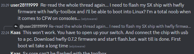

Am I correct that in order to successfully boot to L4T I need to flash https://github.com/Spacecraft-NX/firmware ?
If so, then another issue - after disassembly switch I noticed on my chip there's no usb flex cable connected - would hwfly usb flex cable also work?
I believ Spacecraft was originally written for SX anyway. HWFLY just forked it for their own purposes.
Here is a way to fix you board issue w/o needing the USB (you out the file on sdcard and then run toolbox)
I already came across that page, but I dont understand part "If you have hwfly-nx (...)"
I believe I dont have "hwfly-nx", my modchip is original sx one:
Or maybe you meant that even if my chip is SxT it should have hwfly-nx firmware on it, correct? Can I check somehow what firmware is on it before proceeding?
That is what I’m saying…
https://retrohacked.com/forums/topic/1052-switch-hwfly-nx-release-071/
  • added support for SX Core & SX Lite modchips
There is a user support thread in #Switchroot on discord that goes over this in exquisite detail! :-)
Sorry if my questions were silly. After "Update SD loader" the same error "Board was not initialized properly" is still present however (after updating I need to wait around 2 minutes to hekate to show up and diode was blinking blue). Do I need also to update firmware in hwfly toolbox?
// also (if that would be helpful) when I boot to hekate with VOL+ durning power on then I dont have "The green LED should be on and static". LED on my chip only bliks once.
Youre in the right thread to ask whatever you’d like.
yes, but it’s preferred to do the USB method. An HWFLY cable should work. Do you have one to try?
See bold letters below.
If you have hwfly-nx for your modchip's firmware then you can flash the sdloader.enc file.
  1. Obtain hwfly toolbox from https://github.com/hwfly-nx/hwfly-toolbox/releases
  2. Place hwfly_toolbox.bin in sdcard:/bootloader/payloads/.
  3. Place sdloader.enc from hwfly firmware into sdcard root.
  4. Boot switch into hekate, then run hwfly_toolbox.bin payload.
  5. Update SD loader from toolbox menu.
  6. Power off console from menu.
Unfortunately no, I dont have hwfly cable at the moment, so I'll buy one and I guess then I'll try again then since I lurked at switchroot discord a little and there are mixed information about if its possible to flash hwfly-nx using hwfly-toolbox on sx chips:
I mean, you can absolutely try it. I just don’t know if it will fix it. That’s all I was saying! :-)

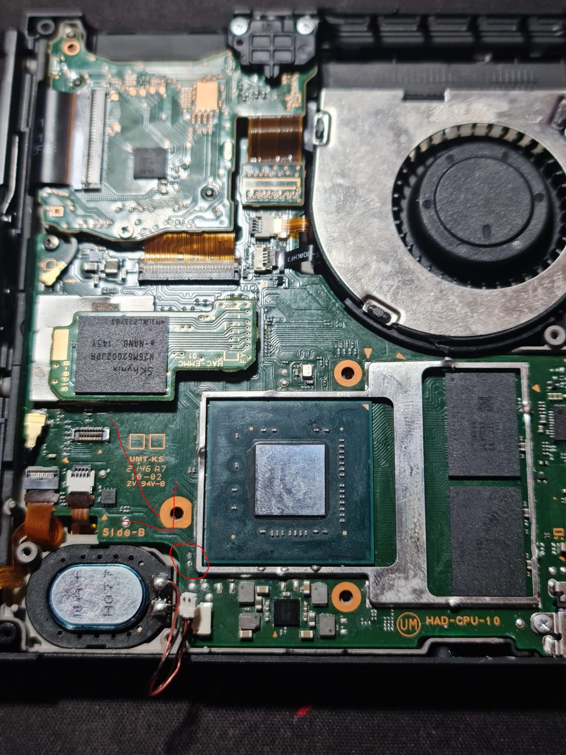

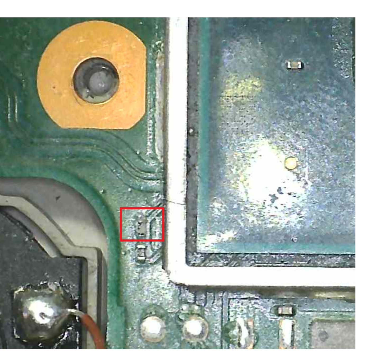

Hey, guys!
I need your help. Does anyone know if in this place (attachments) was any component? looks like there should be something there
Obs: Switch v2 (mariko HAD CPU 10)
