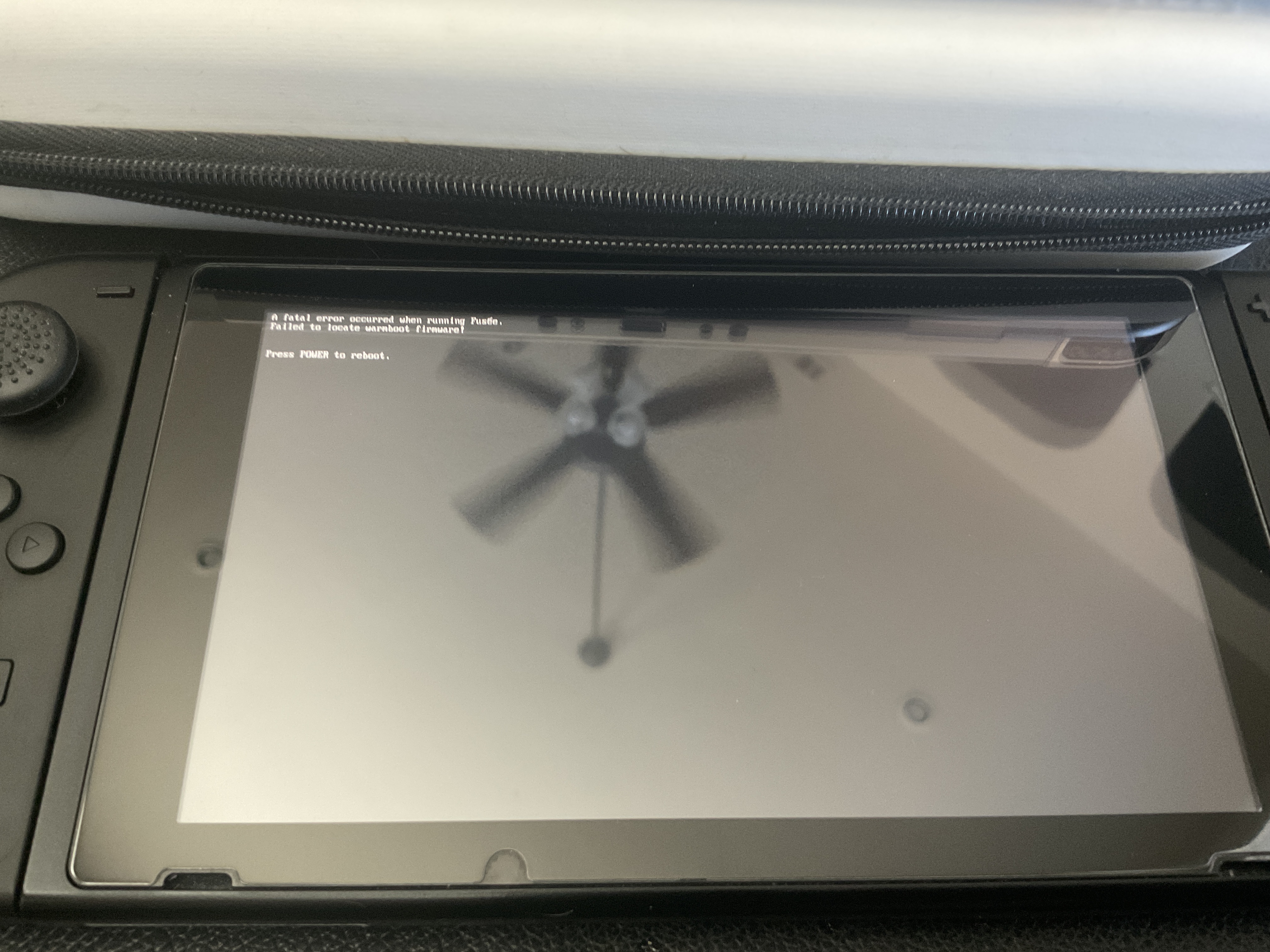

hmmm, after upgrading OFW to 16.0 and when I'm trying to boot atmosphere on CFW with 15.0.1 I've got:
A fatal error occurred when running Fusee.
Failed to locate warmboot firmware!
I initialy thought that SD card gets formated after update, but when I view in on pc:
So I bet emunand is on 29,16GB partition and it is should be there on 15.0.1 (I updated on OFW to 16.0). Am I missing something?
yes, the 29.16GB is absolutely the Emunand and it does not get touched during an OFW update.
Are you on a V1 or a V2?
You can still boot OFW, correct?

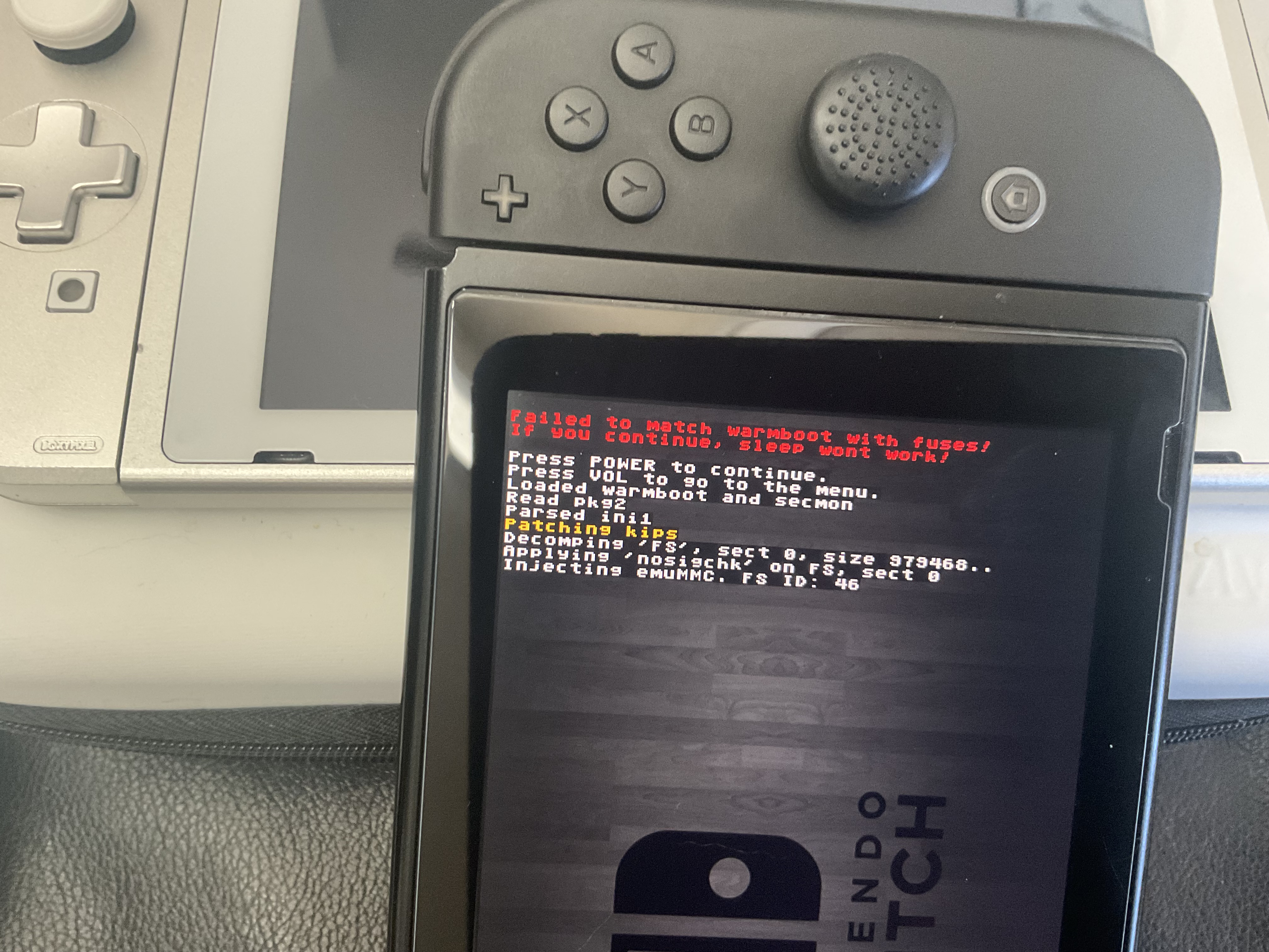

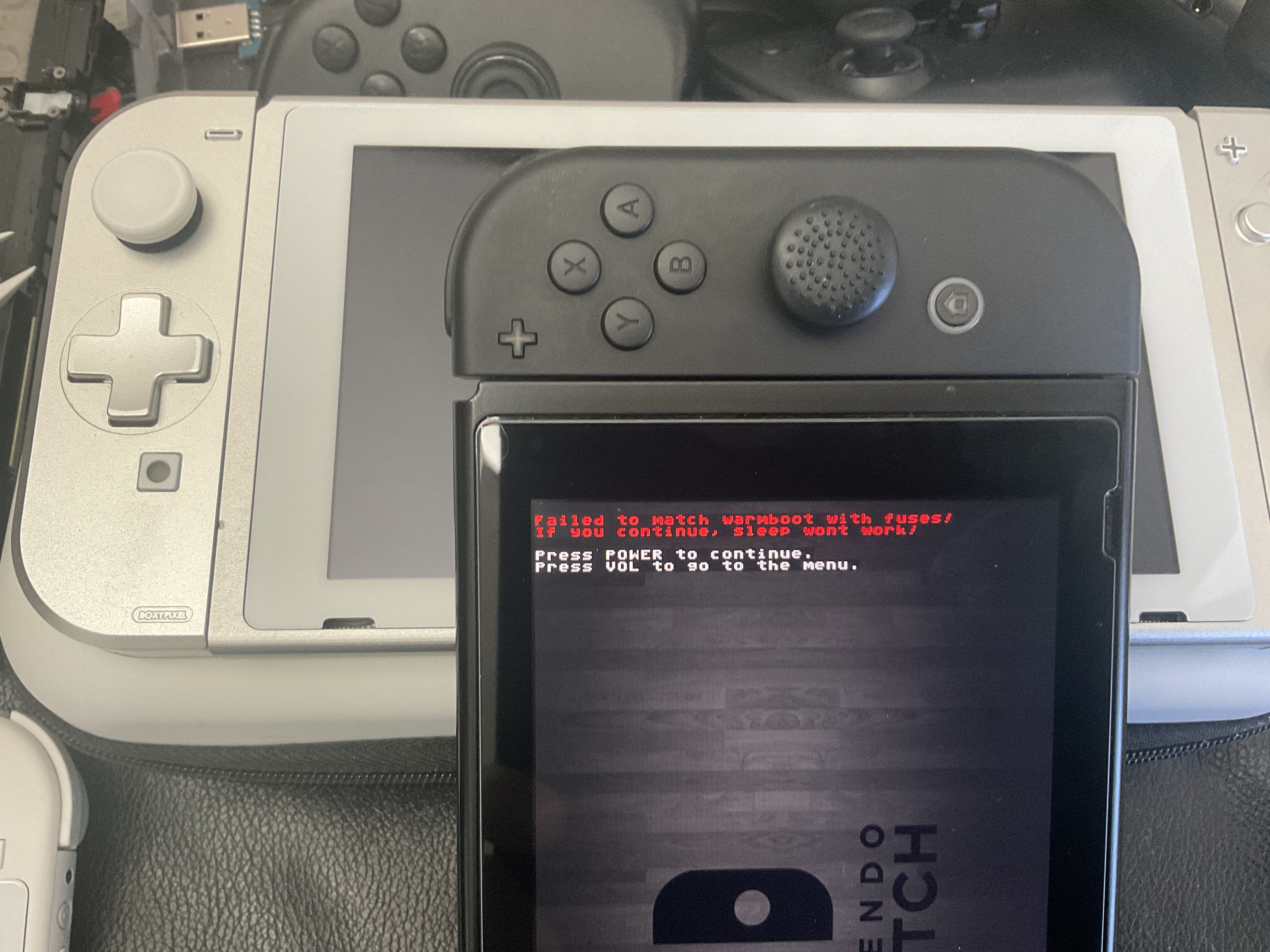

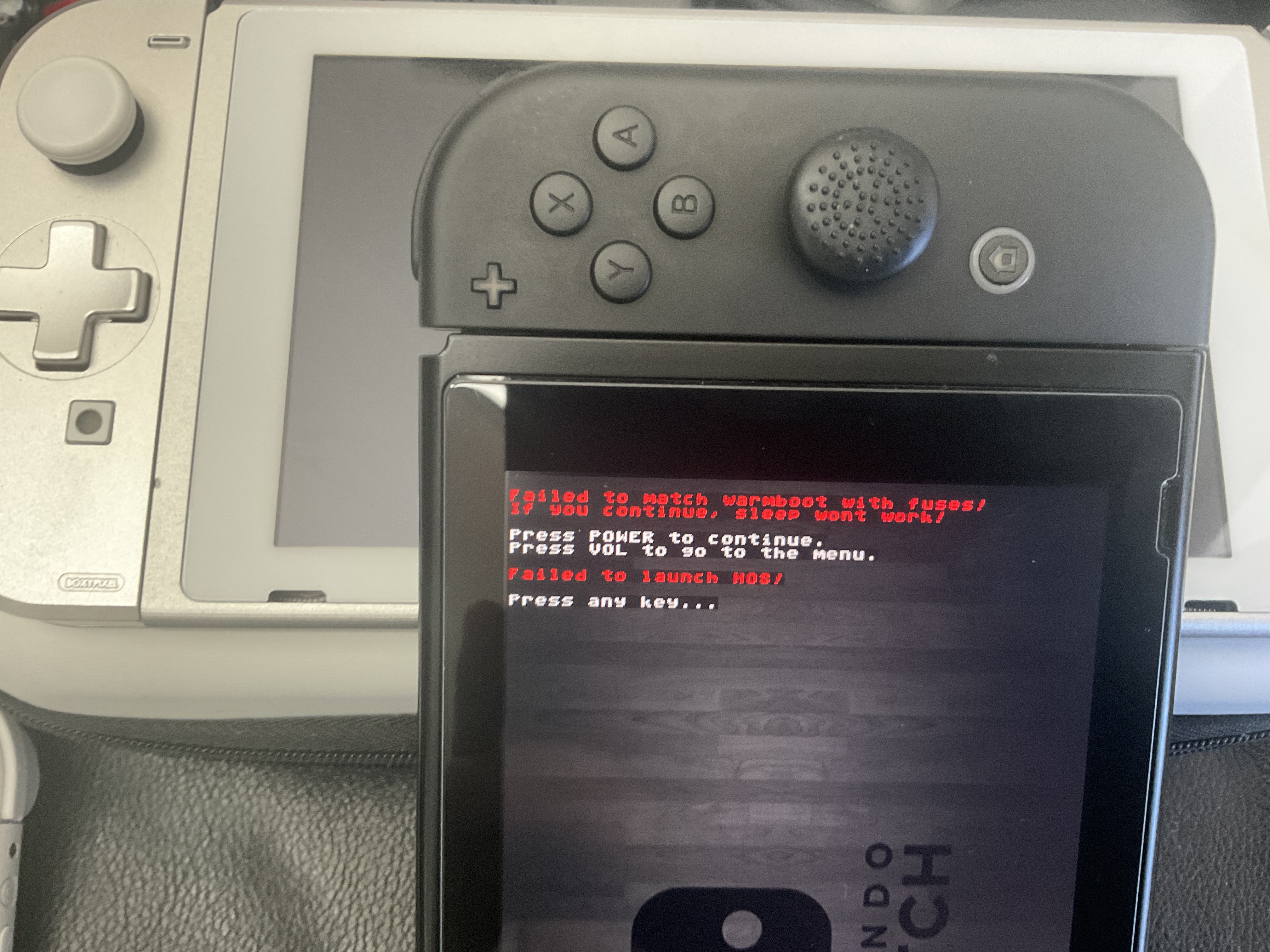

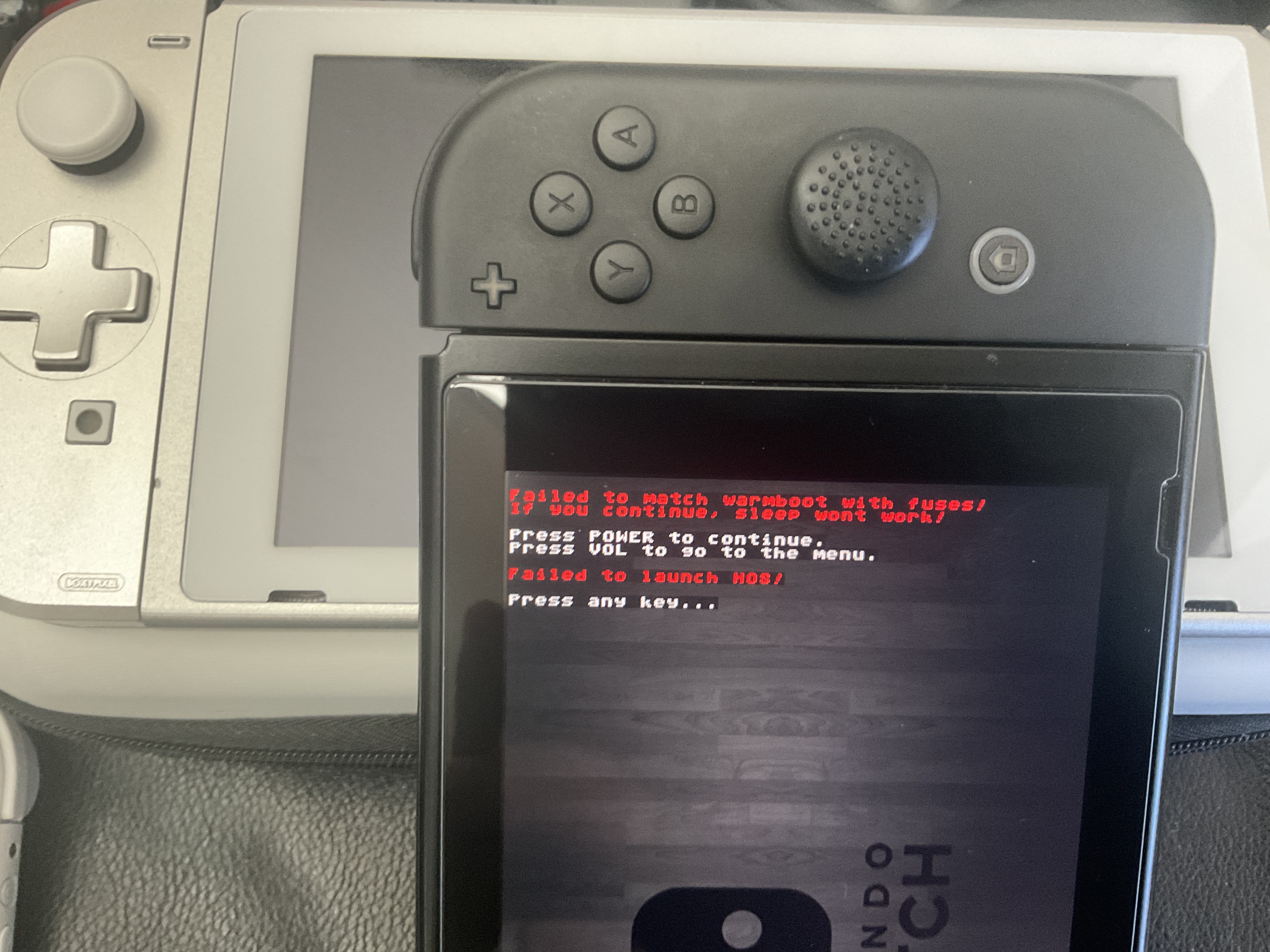

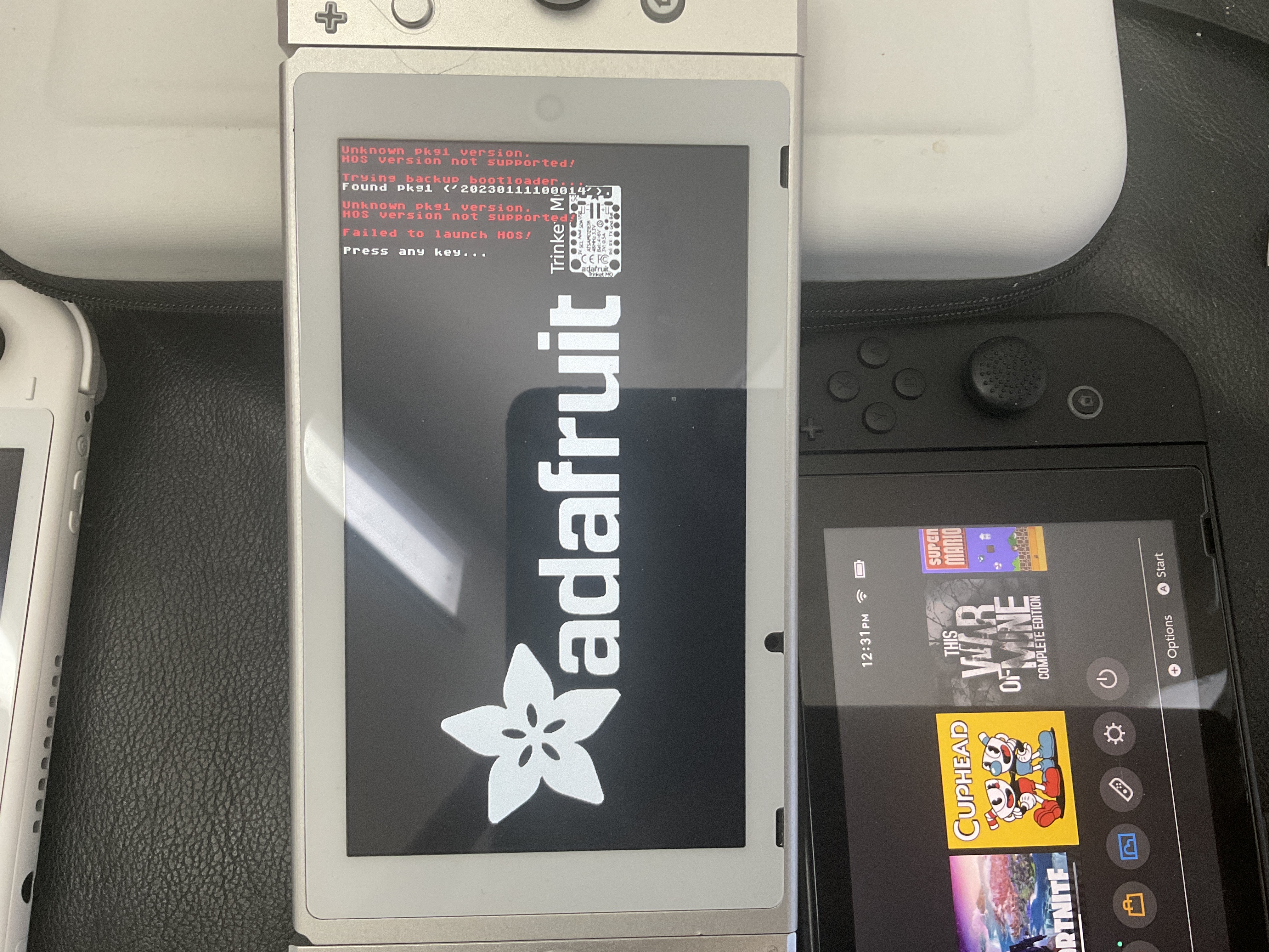

OK, I upgraded my V2 and after a short bout of my glitch taking a reaaaaallly long time to do it's thing (HWFLY V5)
This is what I got while booting with the payload=/bootloader/payloads/fusee.bin option:
hitting power to reboot ends with me having to hold the power button for 12 seconds to reboot. :-(

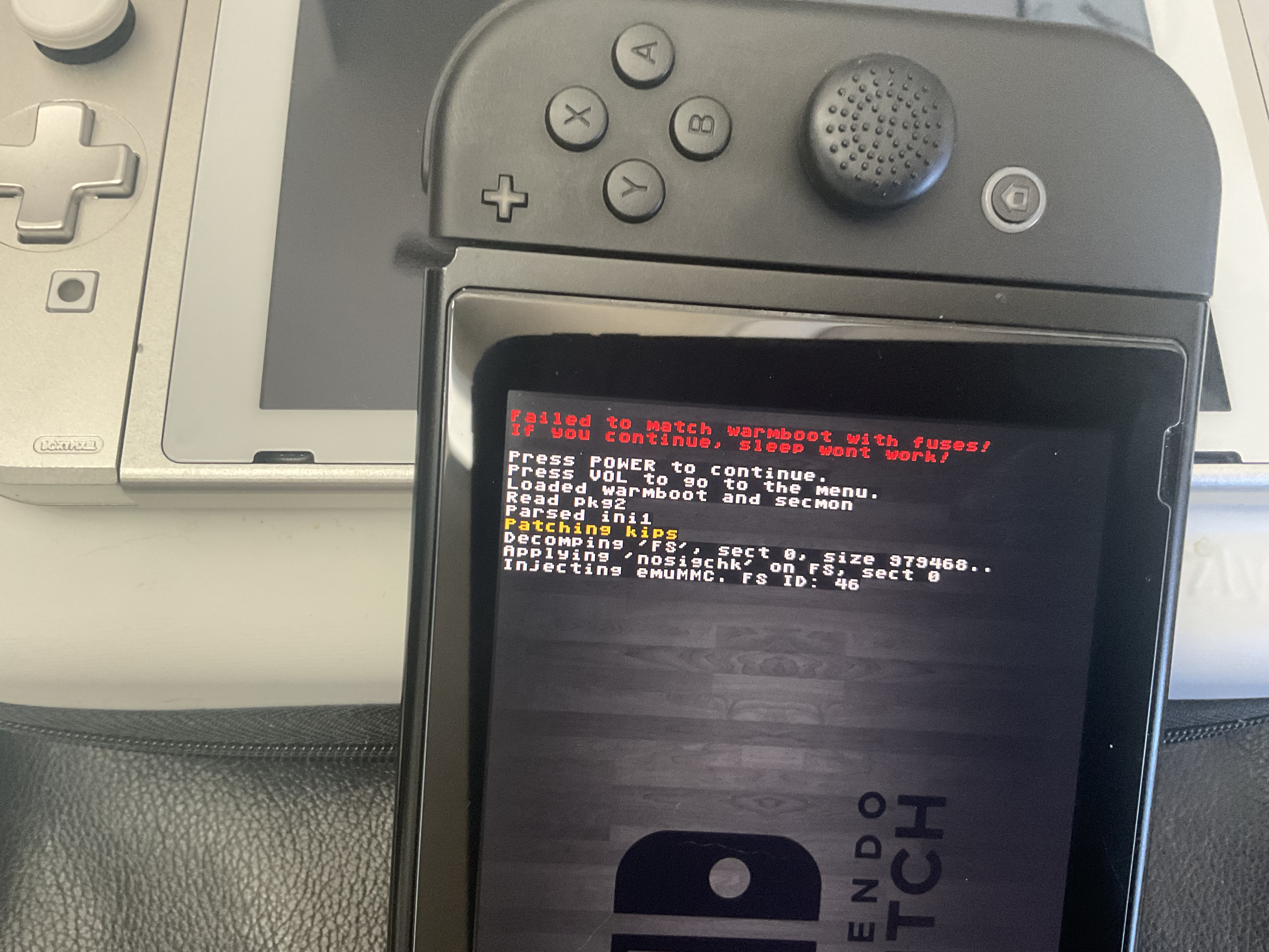

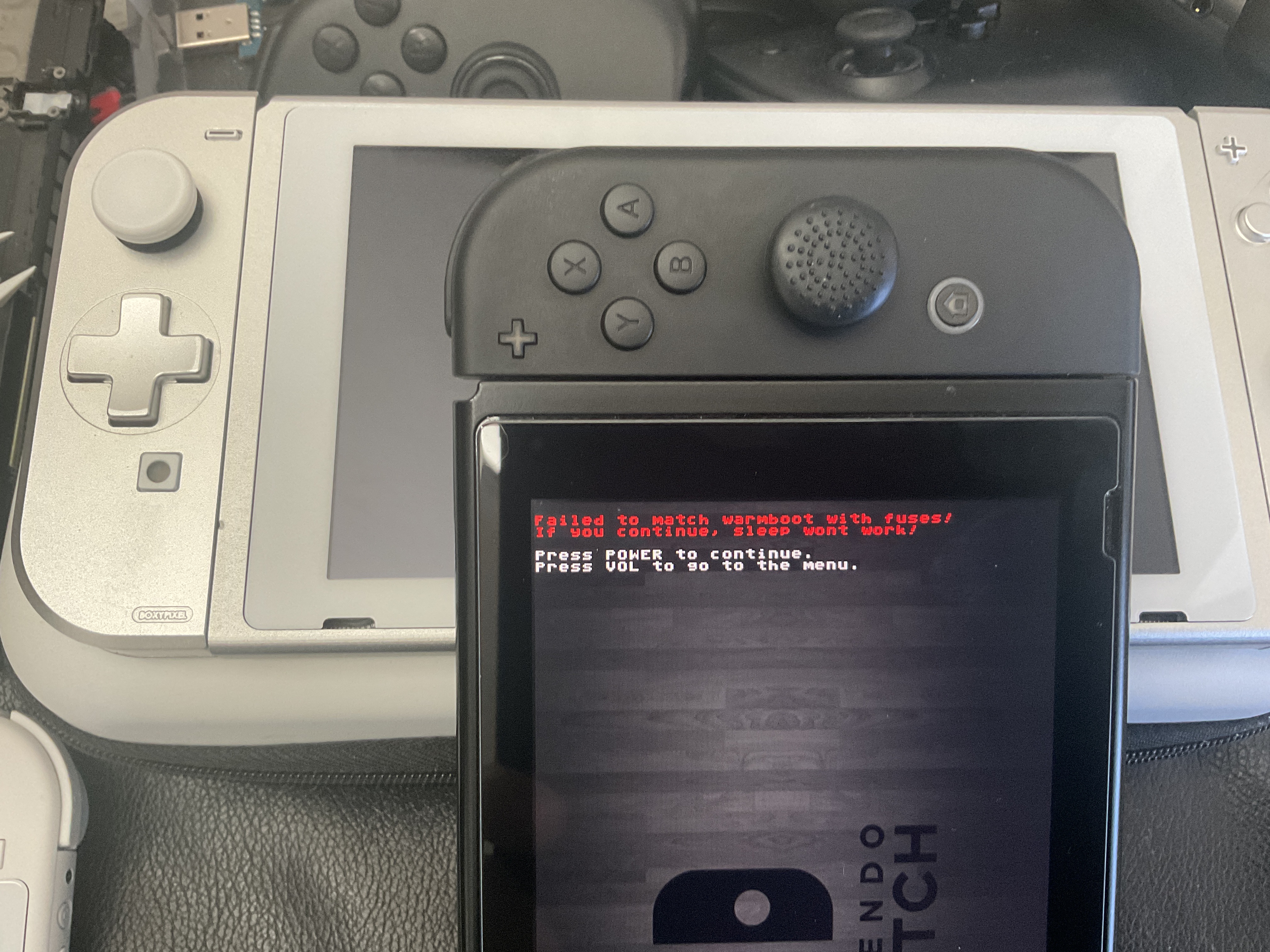

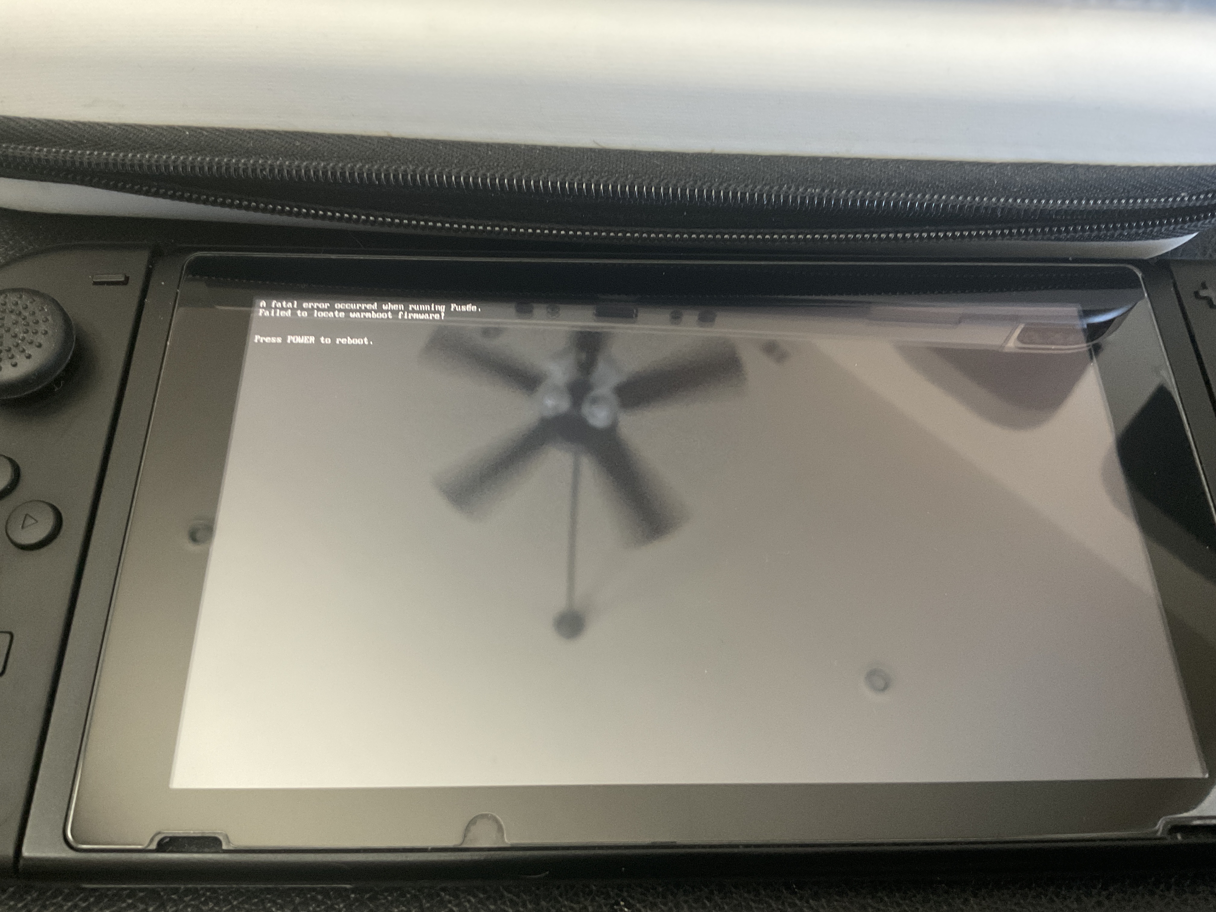

So we’re done here, huh? Not so fast!
This is what I got while booting with the fss0=/atmosphere/package3 option:
hitting VOL just gives me this:
that‘s no good…
but
let’s try the power button to continue next time…

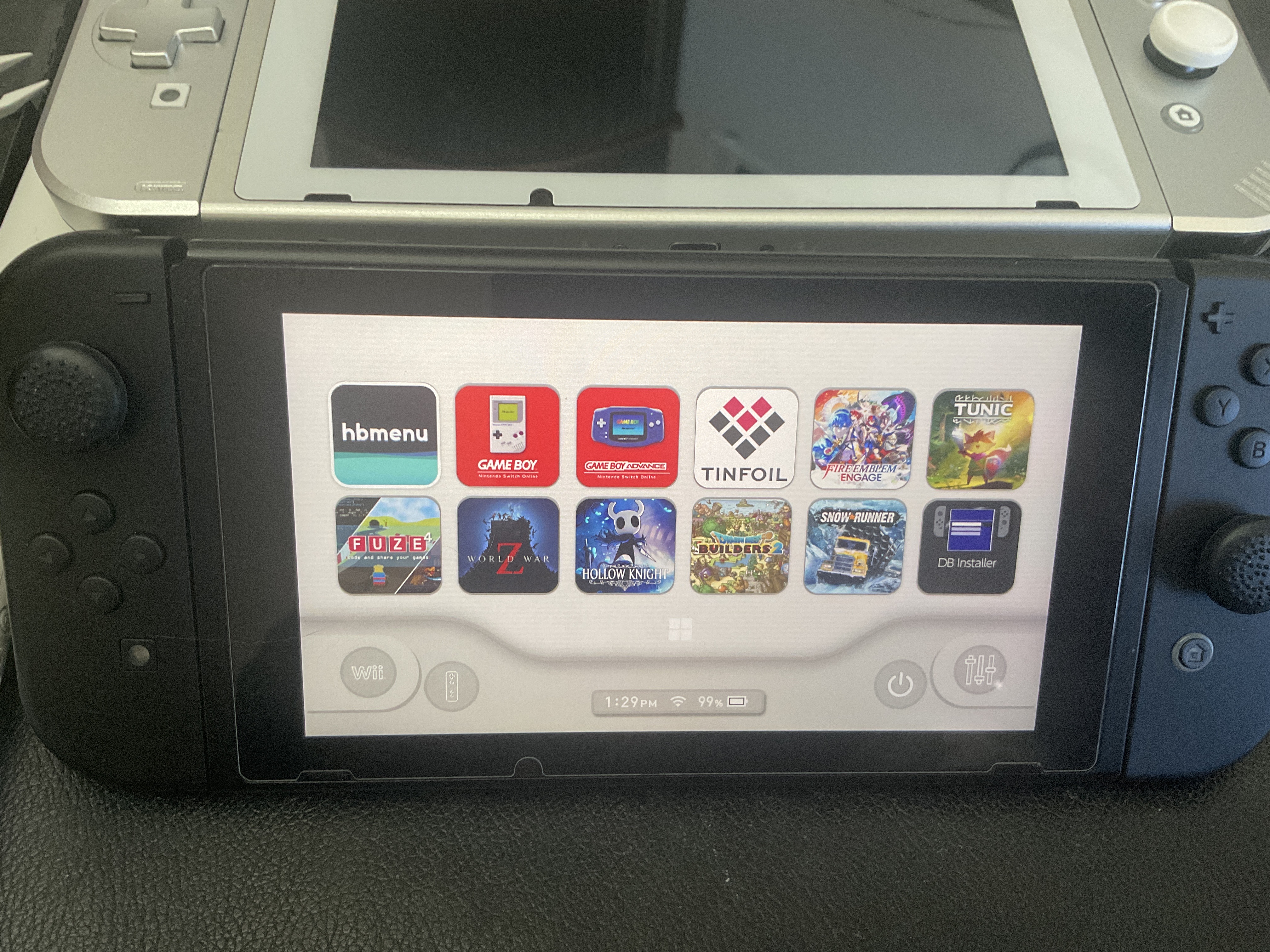

oh? What’s this?
Wahoooo!
so that’s the workaround, folks…

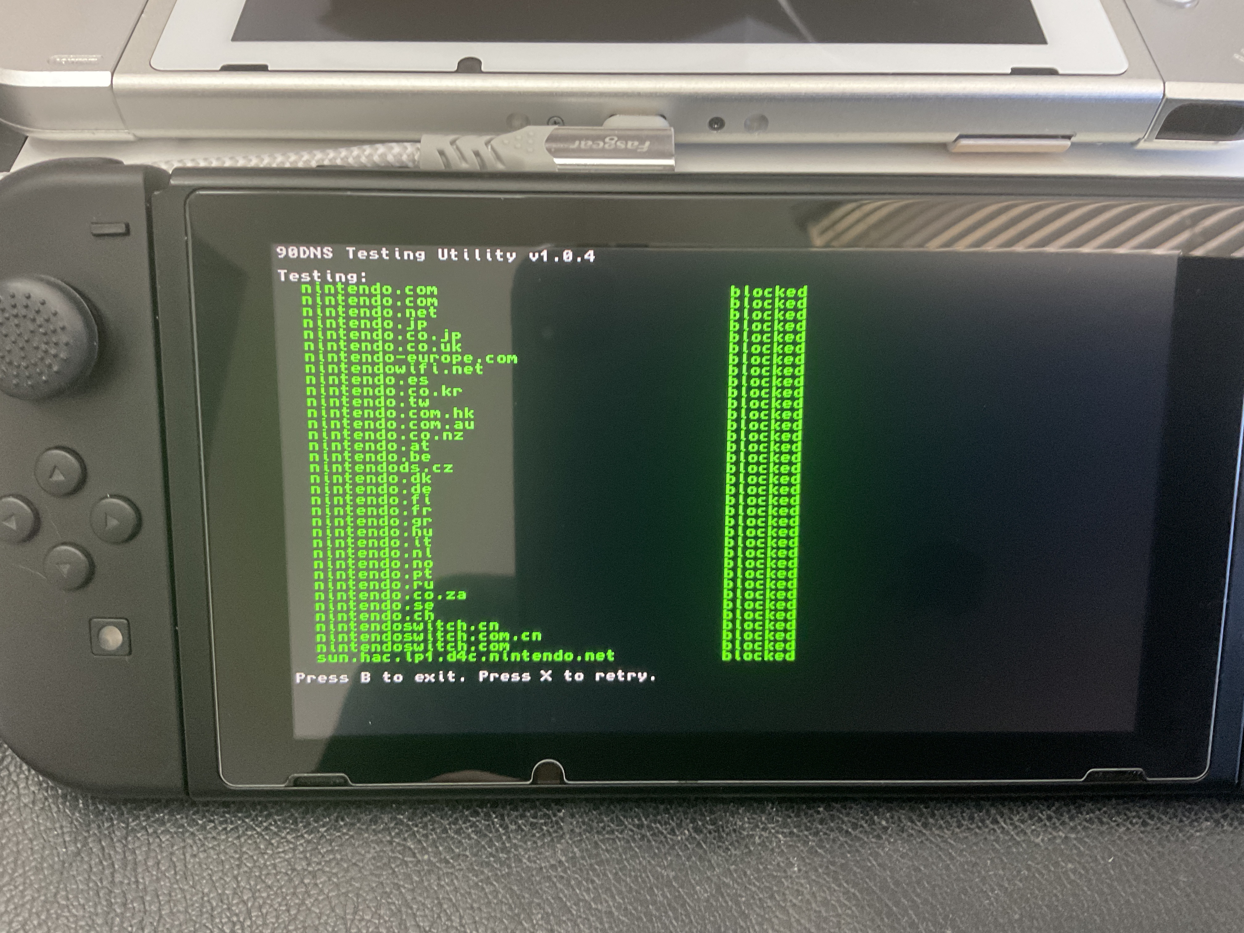

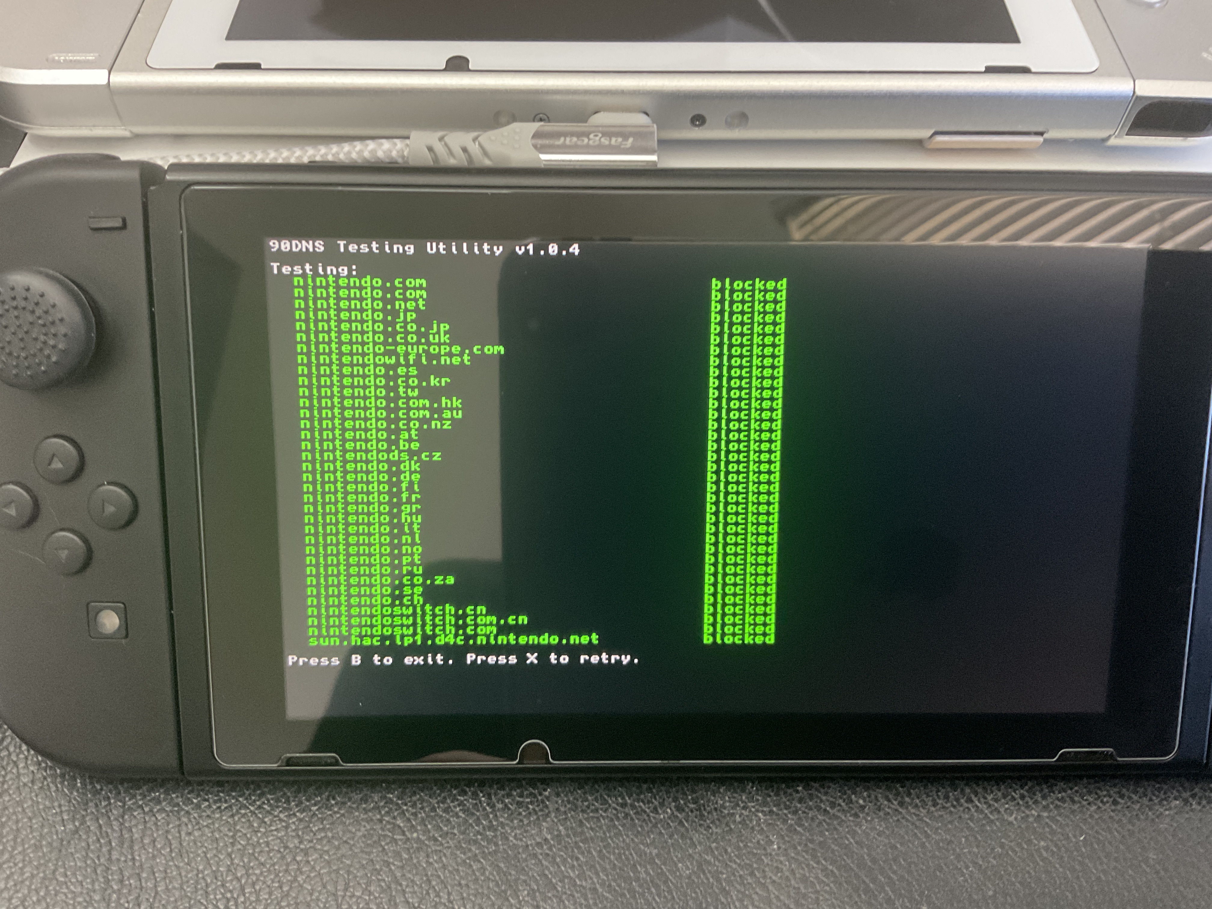

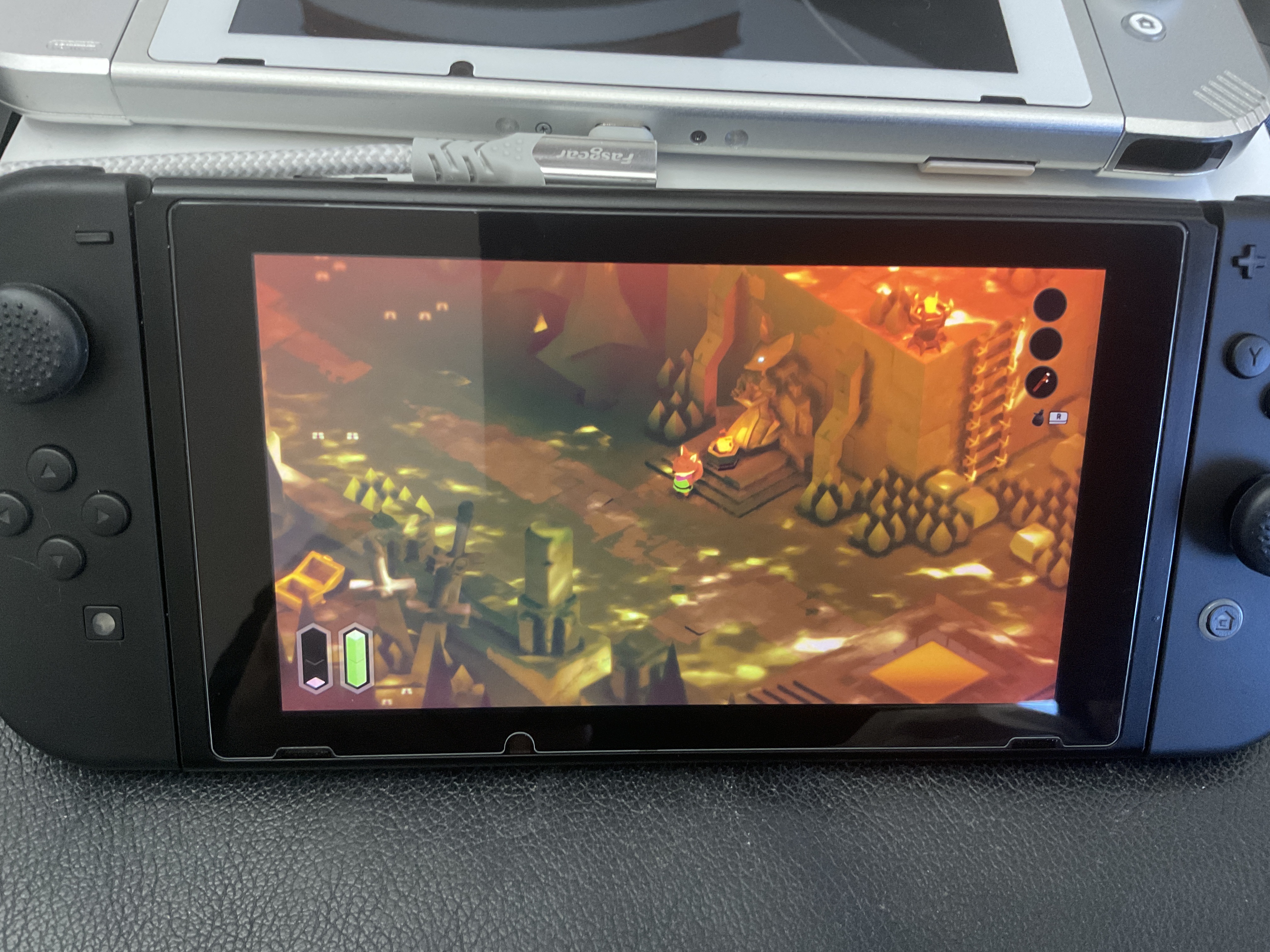

check my dns:mitm:
shields are up!

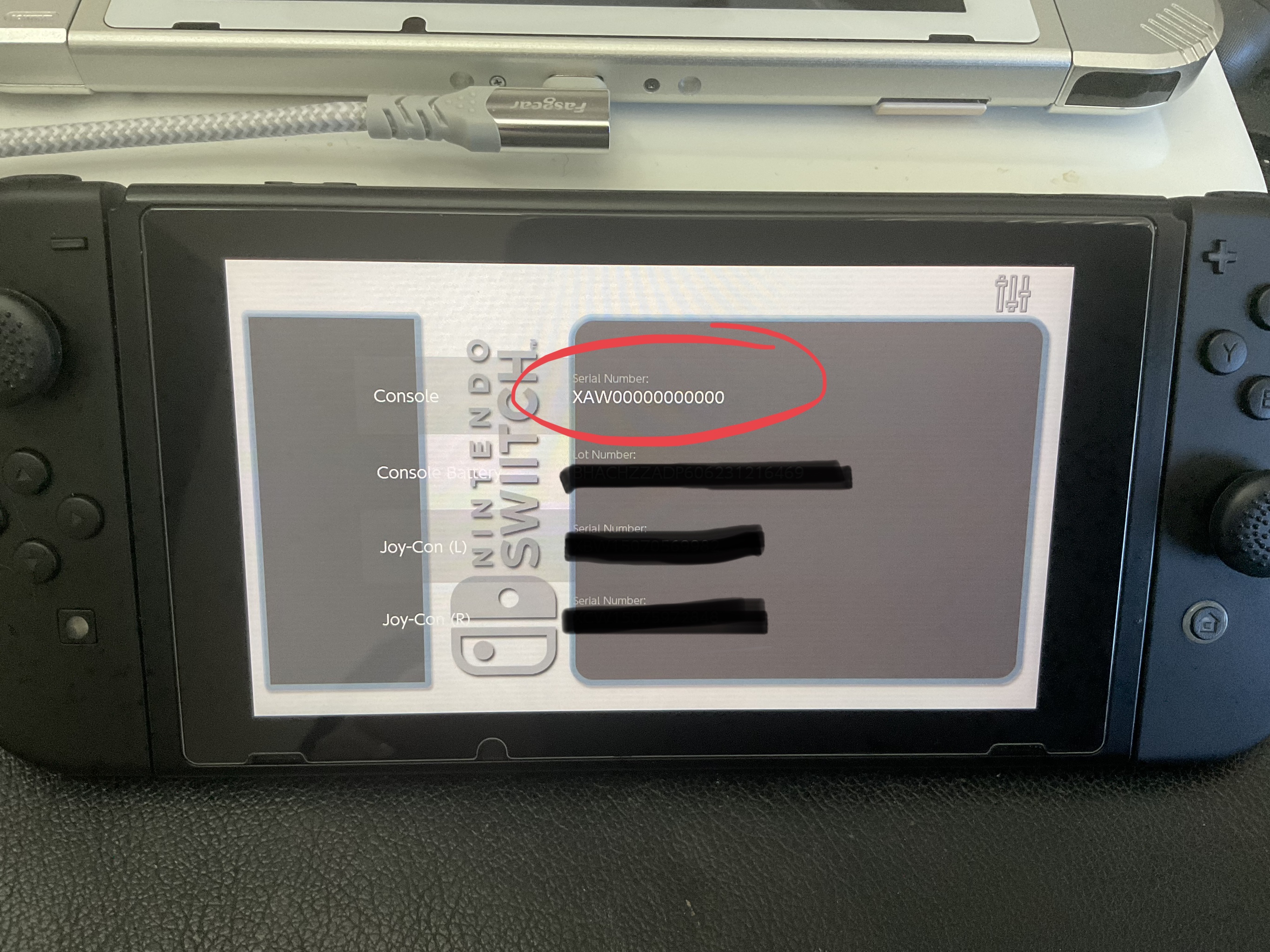

How about serial number blanking with exosphere.ini?
looking good!

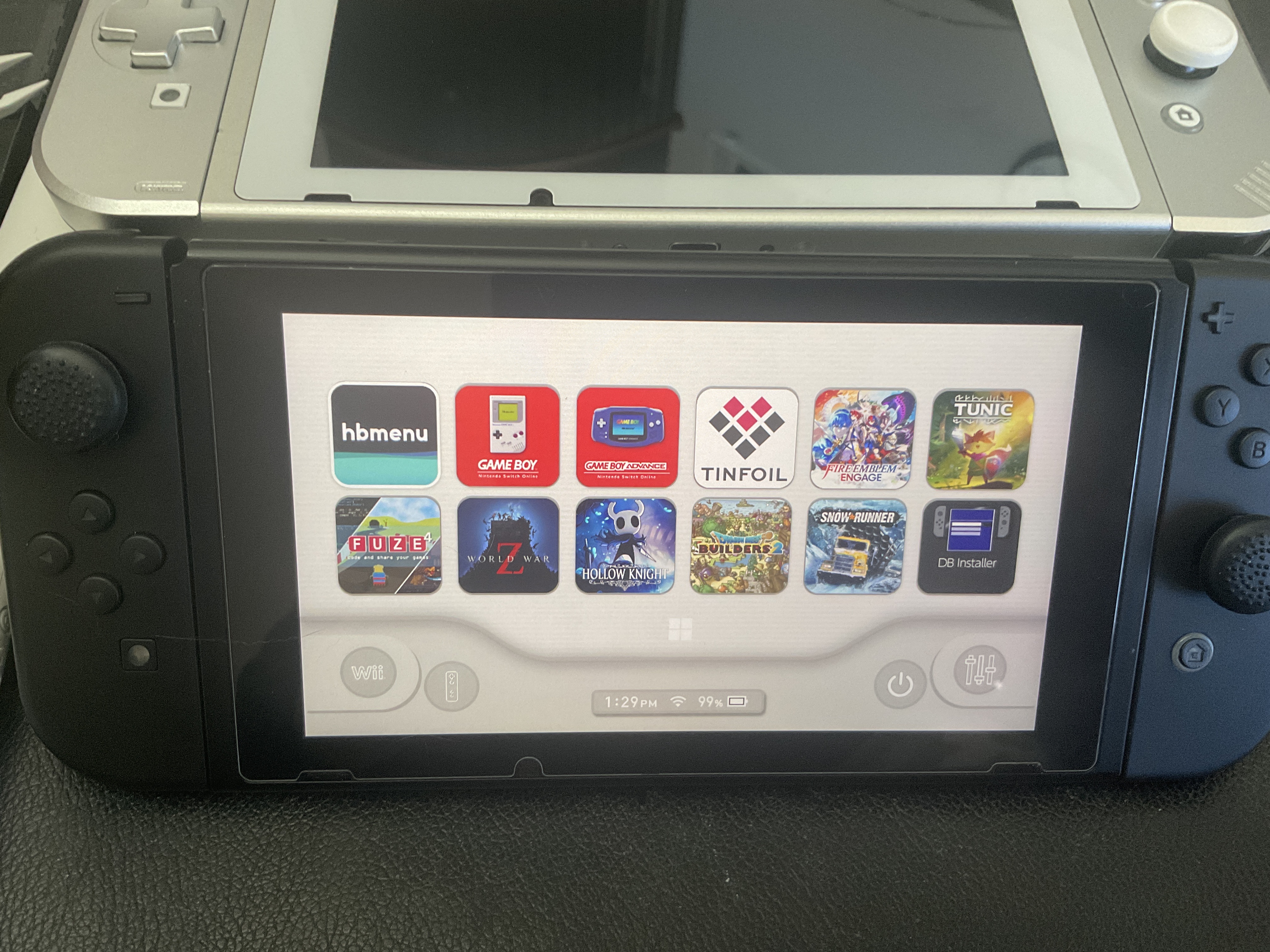

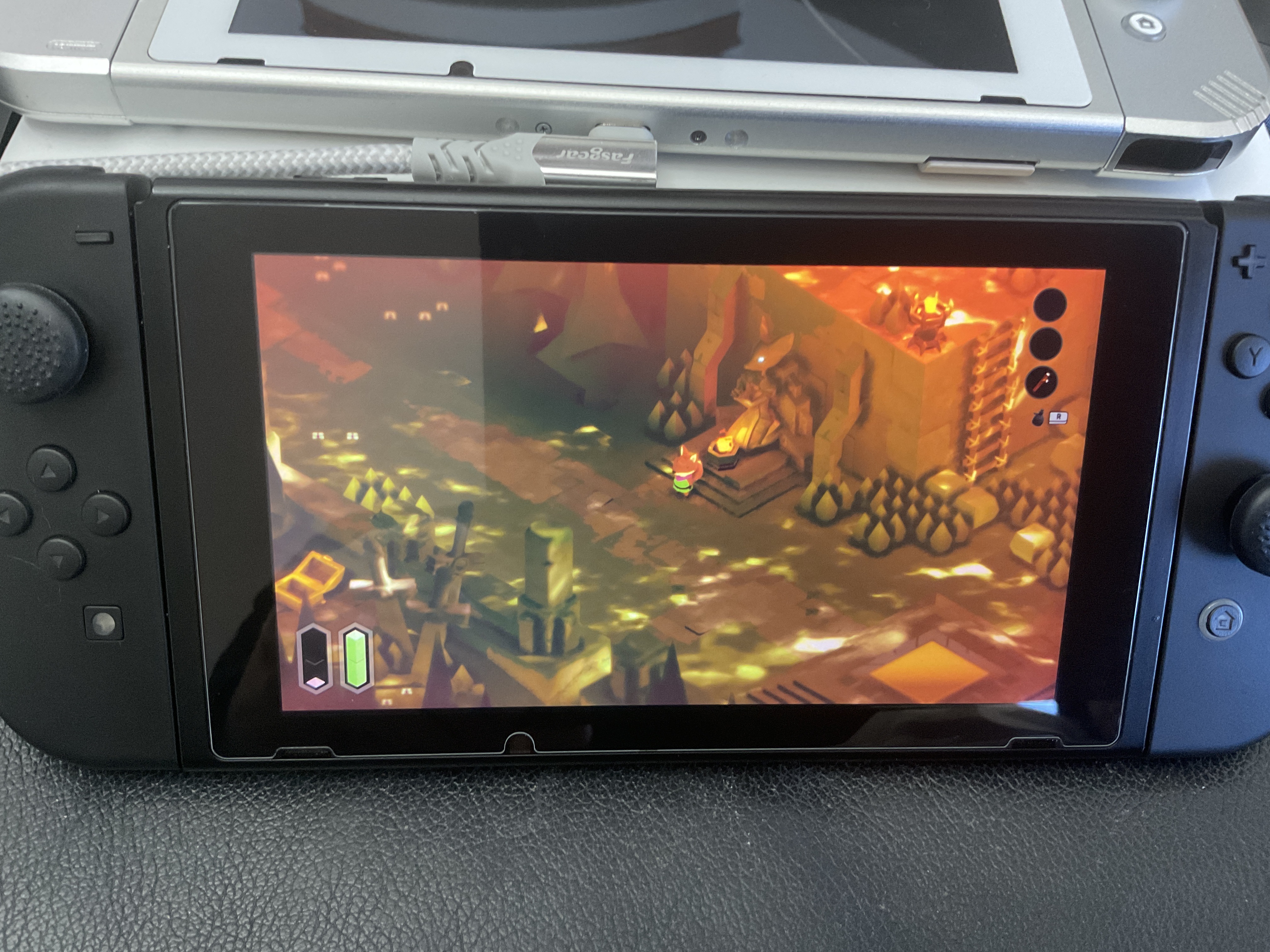

games still boot up and are playable…
I feel like a winner!
The only issue I’ve found thus far is that when it goes to sleep…it doesn’t wake back up properly and you have to hold the power button for 12 seconds to hard reset. :-(
Here’s the stanza in my V2’s /bootloader/hekate_ipl.ini file that worked for me:
[Atmosphere fss0]
fss0=atmosphere/package3
emummcforce=1
kip1=atmosphere/kips/loader.kip
kip1patch=nosigchk
kip1=atmosphere/kip_patches/*
icon=bootloader/res/icon_switch.bmp
note: if you get an error about kips make sure you have the latest Sigpatches installed:
https://gbatemp.net/threads/sigpatches-for-atmosphere-hekate-fss0-fusee-package3.571543/
(thanks @wikisa for this fix)
