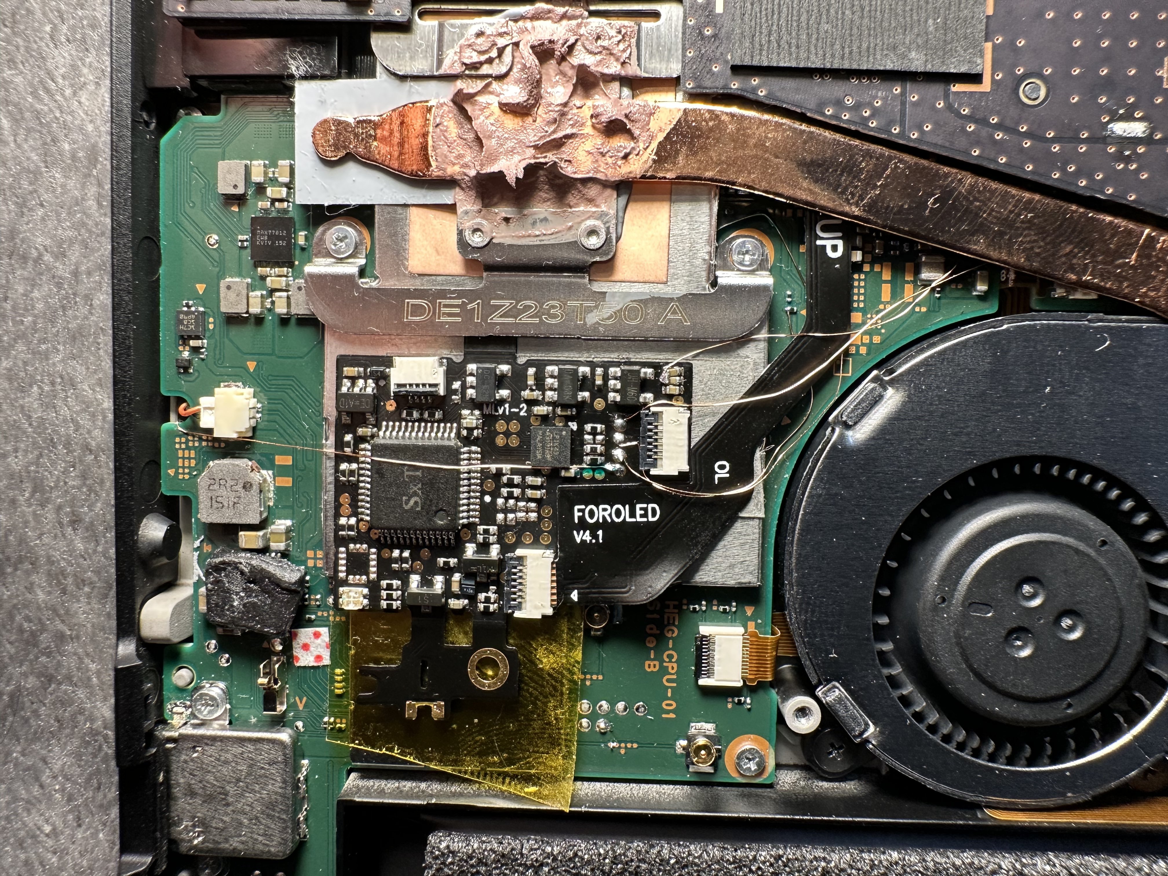

here is a pic. i hope its good enough.

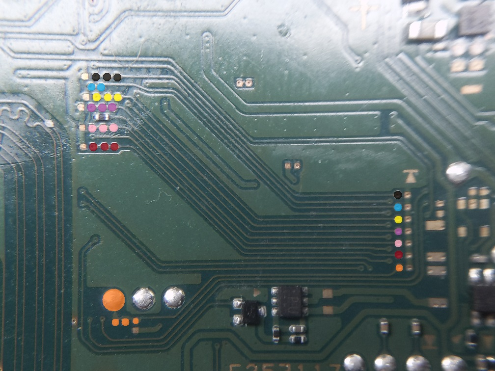

Base on the photo it looks like someone did solder a wire for you in the past, you might need someone to resolder a wire on that connector, purple pin in the photo, CMD point
Alternate soldering point are on the back of the board, if the front soldering point doesn't work
Reactions: BigOnYa
i cant solder. oh and that was Mattytrog he installed a Trinket M0 for me
i send a pic but it doesnt show as a preview only file
I seen the photo, in your case, you need to find someone who can solder, because whoever solder it, solder a wire from the purple color point to the sd flex connector, bring it to phone repair place they can do the soldering.

Yeah so basically I’ve got a couple vids of it still doing the same thing unfortunately don’t have the screwdrivers needed to take it apart so hopefully you can just about see it in the videos I’ve taken, it seems to flash purple about 10 times and then flashed green really fast and boots into ofw.
View attachment 348810 View attachment 348809
So I’ve managed to get a video and a photo of the chip anyone got any ideas why it keeps booting into ofw and not into hekate?
You can try this, post #15 in the thread.
Unfortunately I tried that yesterday and just again now tried looking everywhere before posting, IM guessing it might be the dat0 adaptor maybe like someone was saying in that post? if it is ill have to send it back off to the guy to look at
