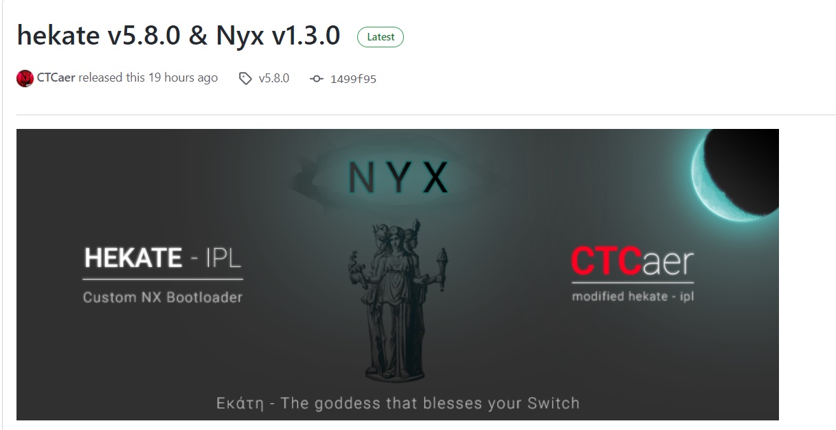

hi let try latest hekate and nyx, this latest update make hwfly unflashable more stable
