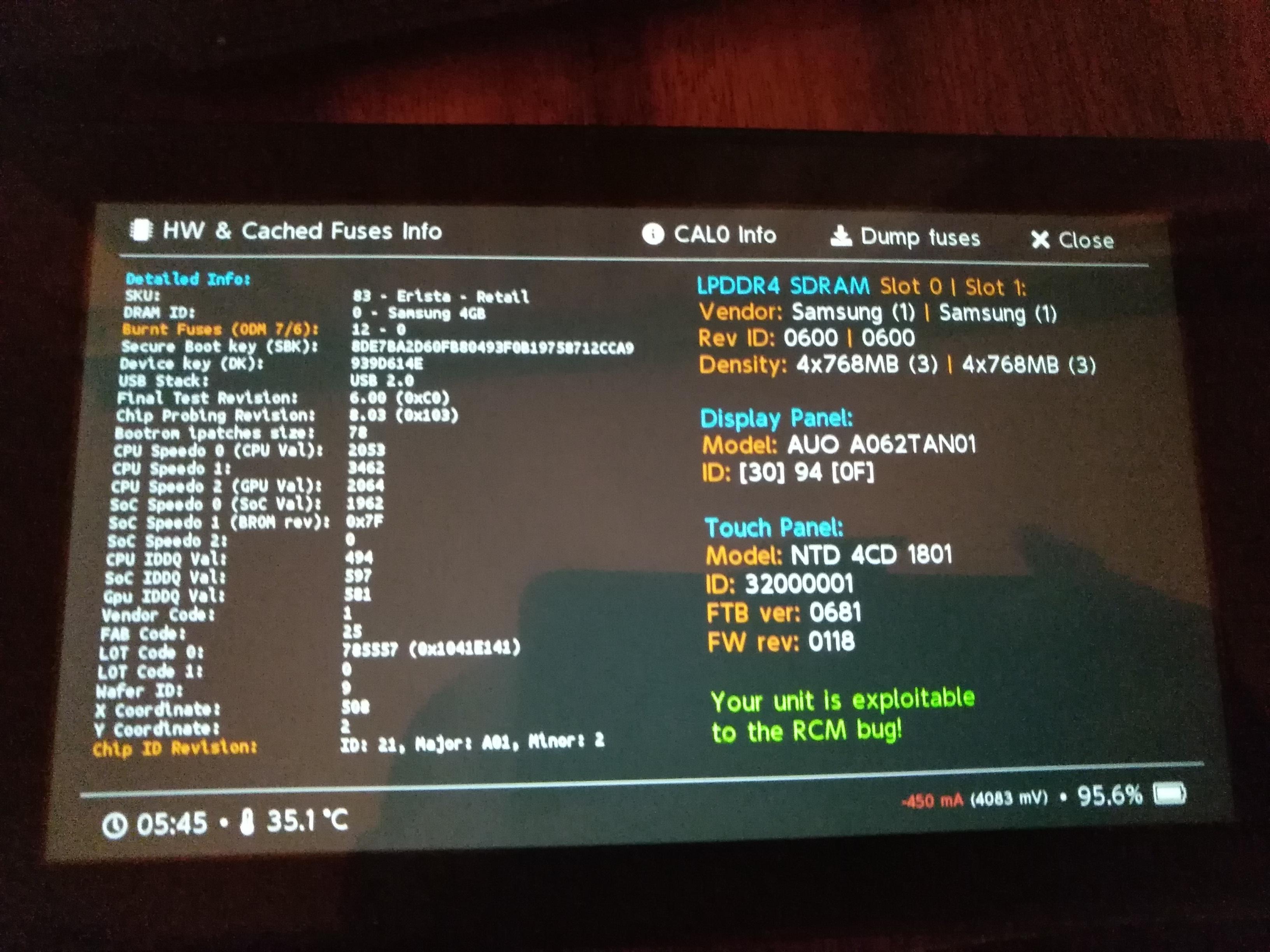

I did it. Replaced 2GB ram chip with 3 GB. Tried to rebuild atmosphere 0.15 forced to 6GB but no luck.
It's all down to the memory controller. I don't really know how custom the SoC is on the Switch (probably not at all considering it's Nvidia we're talking about), but the commercial spec sheet of the Tegra X1 (T210) states that it supports up to 4GB of LPDDR4-1600 (I assume in dual channel).
As it happens, the Switch Erista has 2x2GB LPDDR4 1600.
Looking at bit at the Tegra X1 reference manual, it seems the addressable memory has two blocks (2GB and 6GB) for DRAM proper.
I'm guessing you'd need to do something fucky like addressing 6GB of a 8GB chip.
The Mariko on the other hand has a Tegra X1+ (T214) that seems to support 8GB of LPDDR4X out of the box. I can't find an Nvidia spec sheet but I'm guessing it caps at LPDDR4X-2133 in dual channel.
