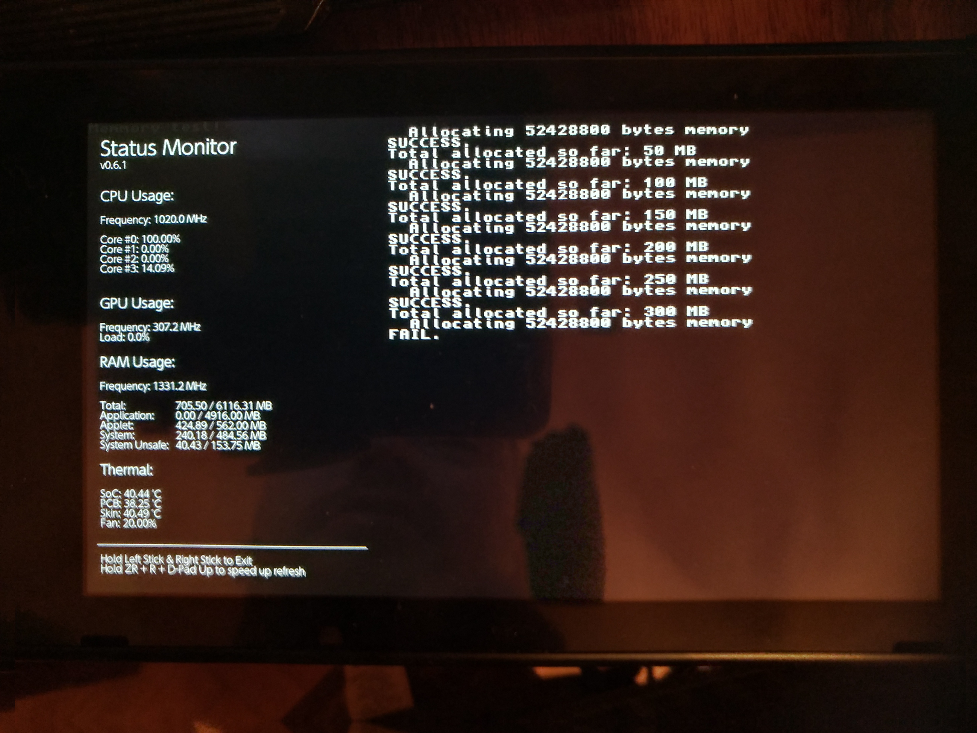

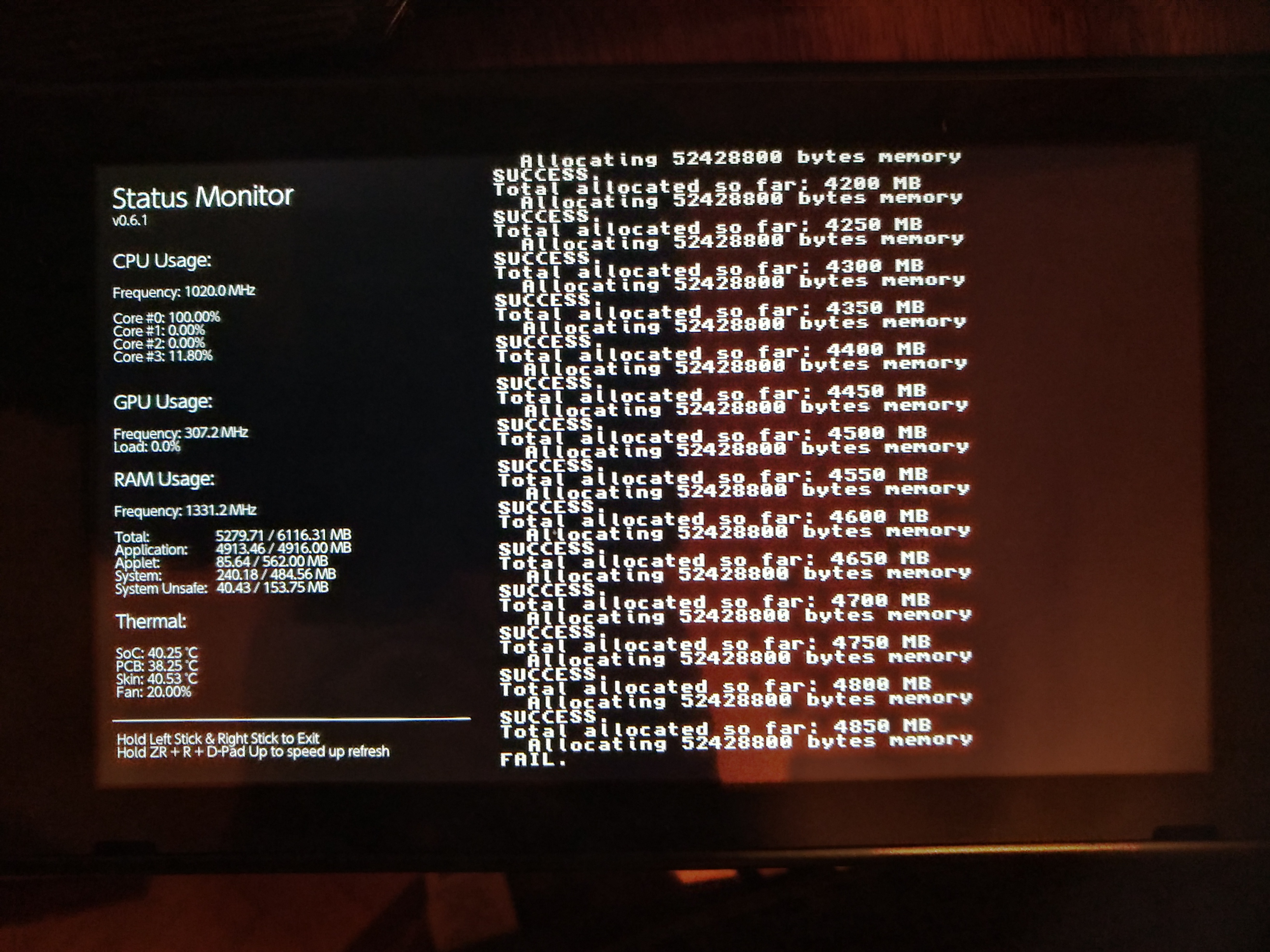

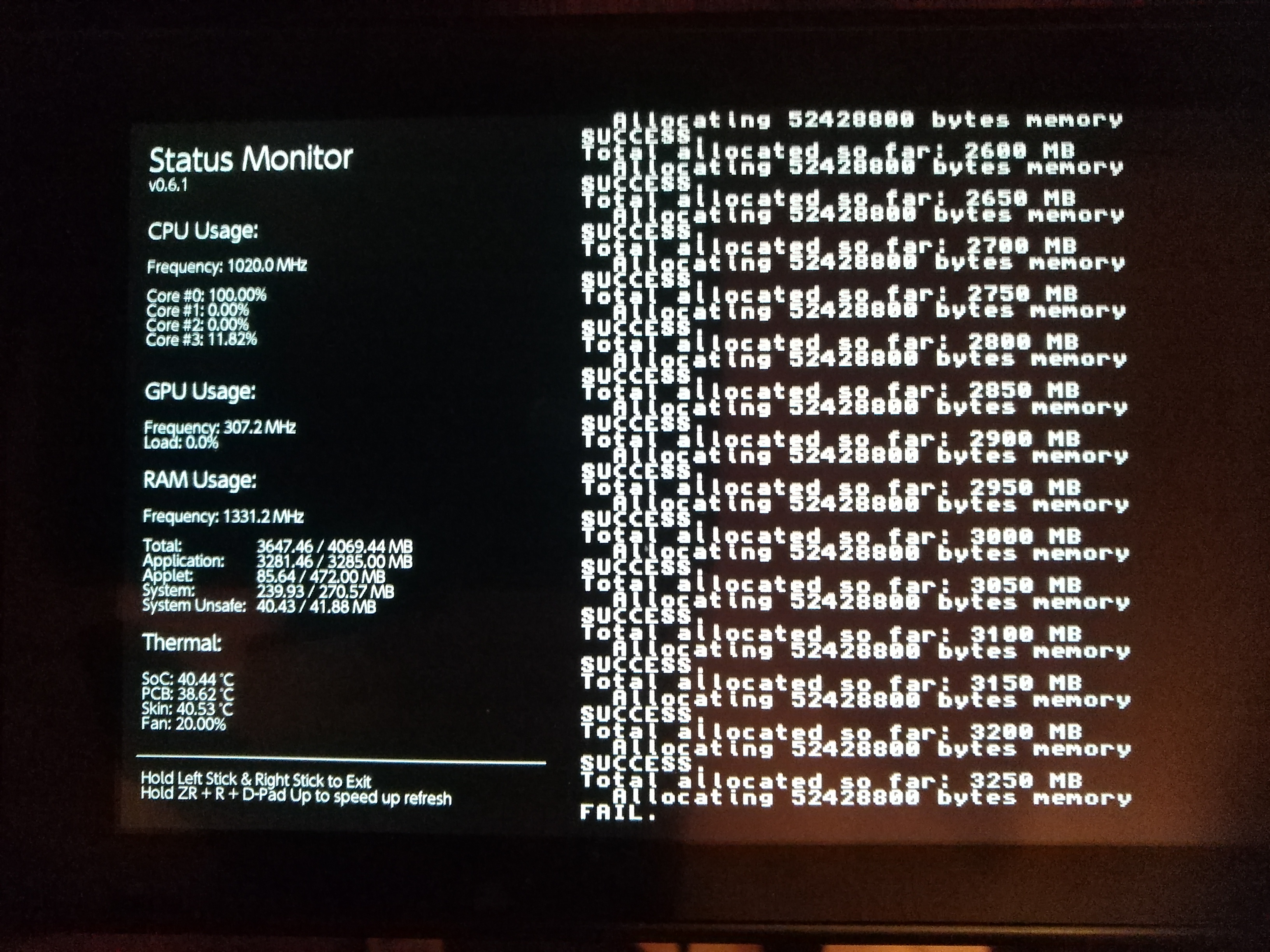

I made simple memory allocation test.
Applet
6GB
4GB
