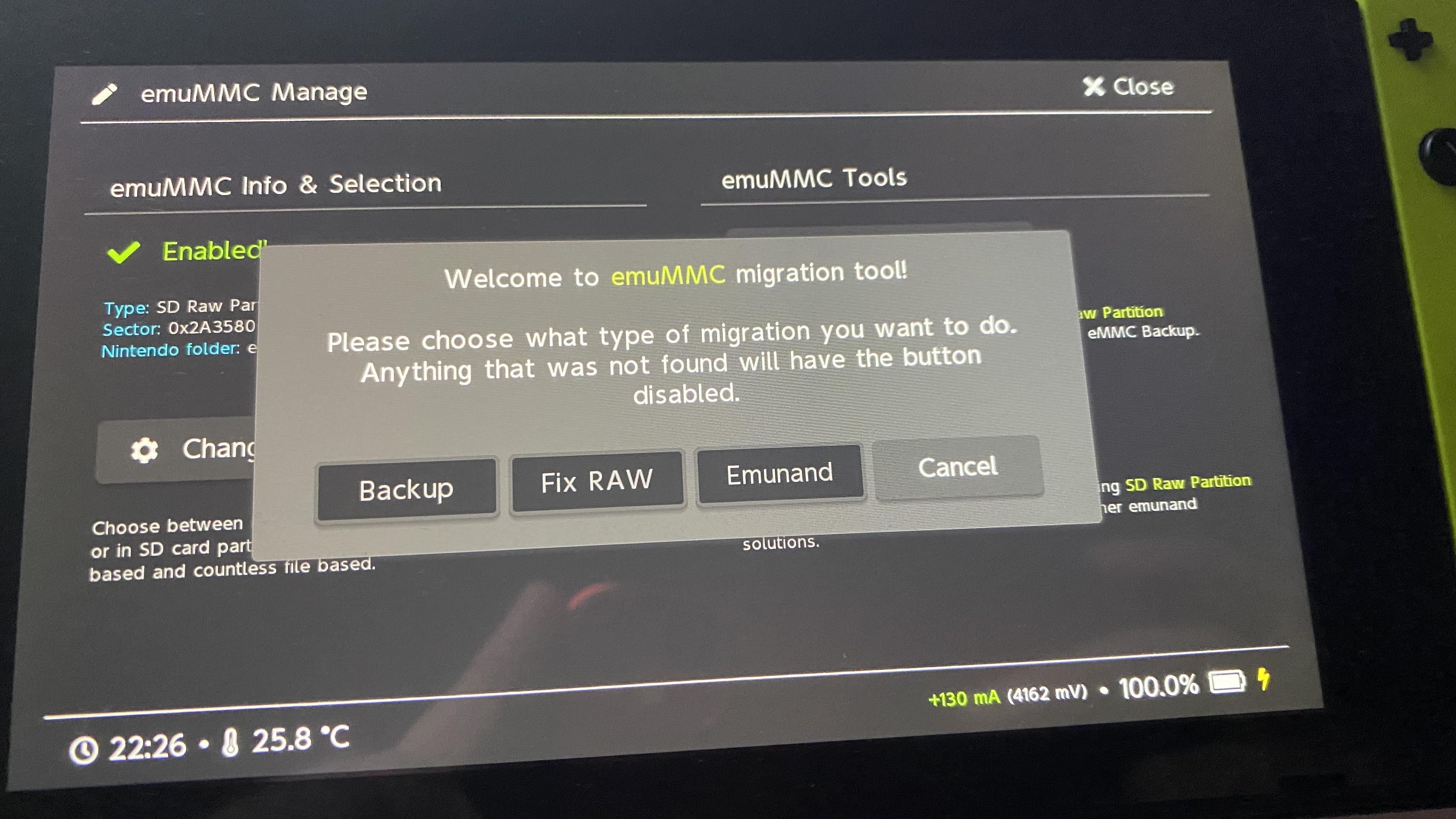

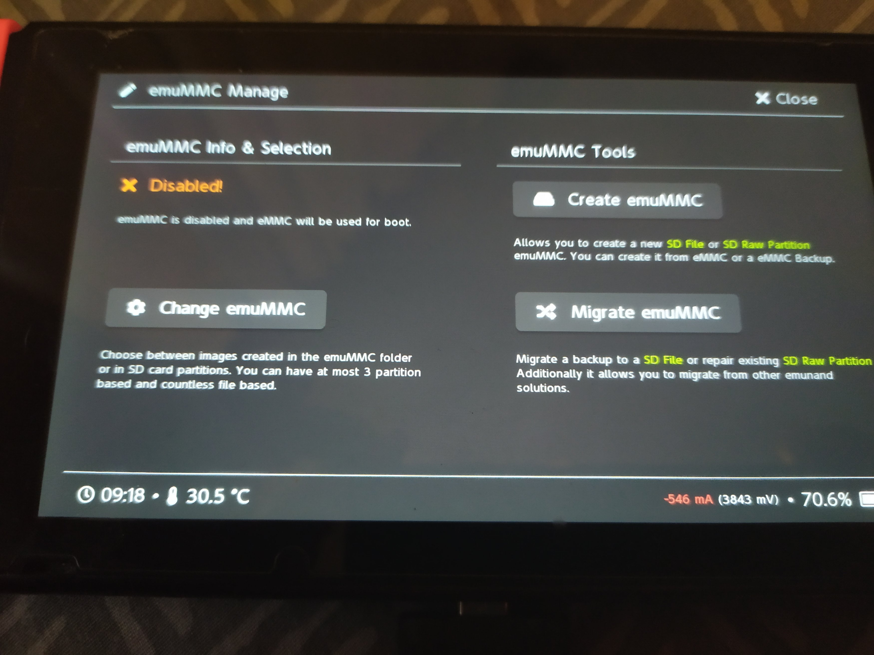

Let’s try this:
  1. On your target card, temporarily move(rename) the /emummc folder to /emummc.bk
  2. Copy the /emummc folder from your good card directly to your new card
  3. Boot into Hekate
  4. Go to emuMMC tile on the right
  5. You should see that your emuMMc Info and Selection section says DISABLED.
  7. Click Migrate emuMMC button on the bottom right.
  8. Select the FIX RAW button
  10. Reboot
