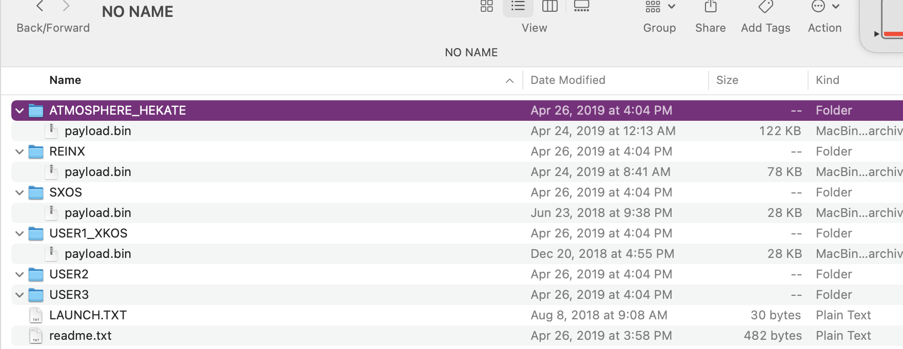

Happy Holidays! I bought a Switched that came with a 512gb microsd, rcmloader, and jig 2 years ago. I haven't used this device since then. I recently ried to turn it on in the CFW mode but have been unable to. Power On + Vol Up nothing happens before my RCM Loader light with turn on for a split second. Now it does not. Did I do something wrong? Will I ever be able to boot into the CFW mode? I don't even know which CFW was being used before since I never set this up.

Have you charged up your RCM loader by connecting it to your PC with a USB-A to Micro-USB cable? It will flash white while charging. 5 mins of charge should give you enough power for a quick test.

Yes I let it charge on usb and an iphone brick for over 1 hour. I have a video I'll try to upload.

Disconnect it from the iPhone brick and plug it in to your PC and see if it opens the built in USB drive.
Also, while it’s disconnected from any power source, press the + button and hold it down for a second or so.
Does it flash to a different color?

1. I can see folders
2. No light turns on when I unplug it from a power source. It only lights when plugged into something via USB-C

In those folders, can you see any "payload.bin" in those?
Which color of LED when you press + button on dongle (when not connect to switch or charger)?

Yes I do see the payload.bin folders
The LED does not change colors when not connected to the switch or charger. The LED changes colors when connected via microUSB to the PC or to the Switch (if powered on).

  1. For best results, download the latest hekate.x.x.x.zip from here and unzip it.
  2. Inside you will find a hekate.x.x.x.bin file.
  3. Copy it to the Atmosphere folder of your RCMLoader and be sure to rename it to payload.bin.
  4. All files that you place in the RCMLoader must be called payload.bin. (You just put them in different directories to differentiate them.)
  5. Once you have a paylod.bin in place, Unplug it and see if a blue LED flashes when you press the button.
Just saw your update...looks like your battery might be dead.

I mean when you press + button on dongle like attached video. Which color of LED is flashing? If not flashing, your inner battery is dead, and have to disassemble it to replace a new one (quite easy).
EDIT1: Agreed with Coach
