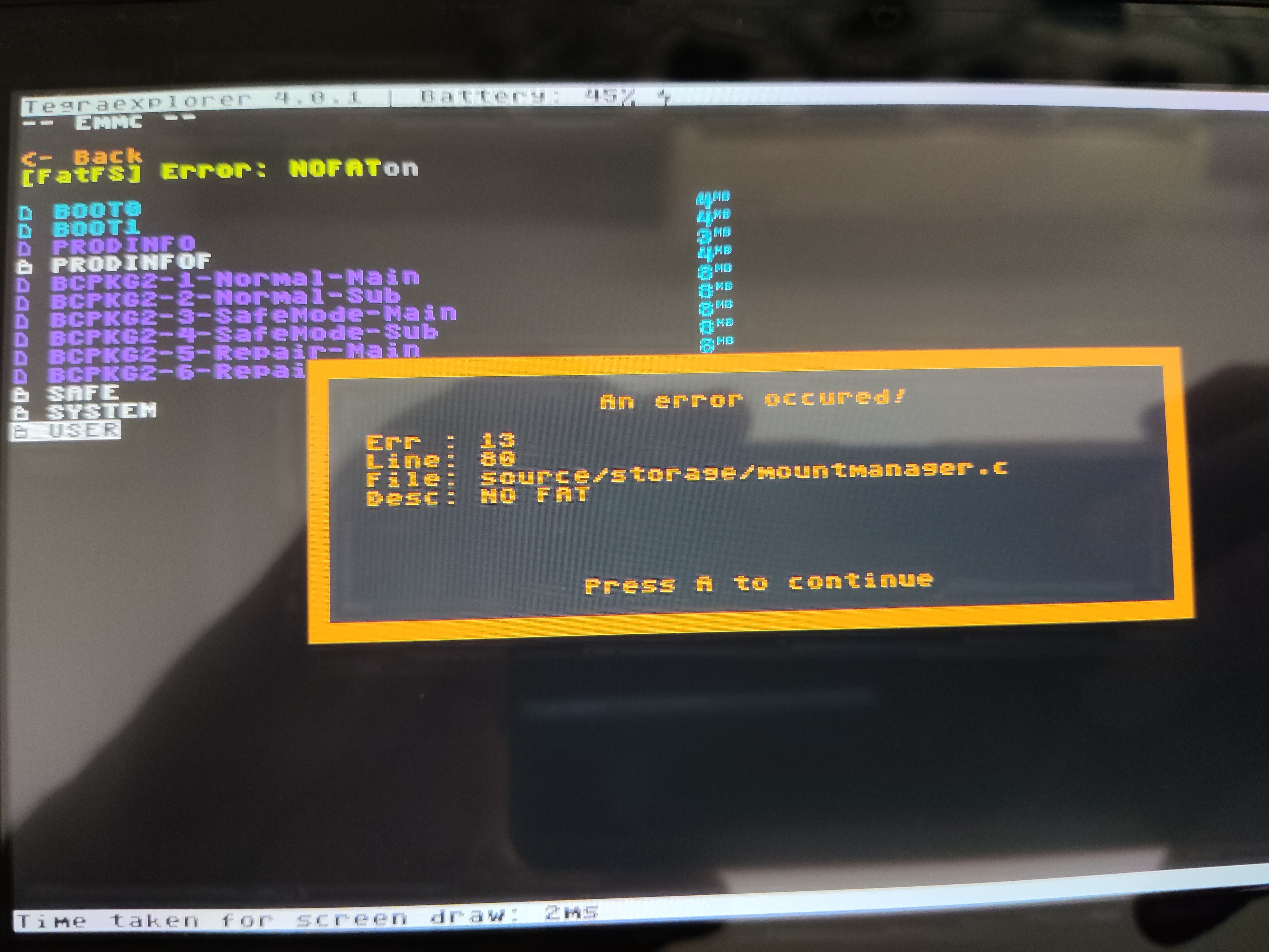

Hello! My Emmc USER folder in both my backup and switch is corrupted/have some errors regarding fat. Is there a solution? I still have both boot0 and boot1 and prod.keys. I can't even do a system wipe because the process crashes when trying to access USER folder.
This is the error im getting when trying to access the folder with tegra.
Got any NAND backup?
I have done an unbrick guide using EmmcHaccGen, but It did nothing. I will try doing it again and see if I can solve it this time
Btw, the guide was from EmmcHaccGen creator, but I can't send the link because im new to the forum. After using EmmcHaccGen, it creates another USER folder, but it was empty, don't know if I did something wrong or not.
Then you might have to rebuild your NAND
Ok so I did it again following EmmcHaccGen creator guide. I used my prod.keys and 12.0.2 fw, the last version that appears as working on EmmcHaccGen github and still the same. I think that it did not fixed the problem because it doesn't do anything to USER folder (atleast on that guide, I had to do nothing with USER folder, only SYSTEM and boot.bis). I tried to access USER folder with Tegra and returns the same error as before.
Also when booting atmosphere, it returns an error (this error was also happening before) : 2002-4686 // program: 010000000000001f
I've been searching for information about this error and everyone seems to have a gamecard missing driver, but I can't even boot up without gamecard and NoGC on, so I have been trying to fix the USER folder problem first.
