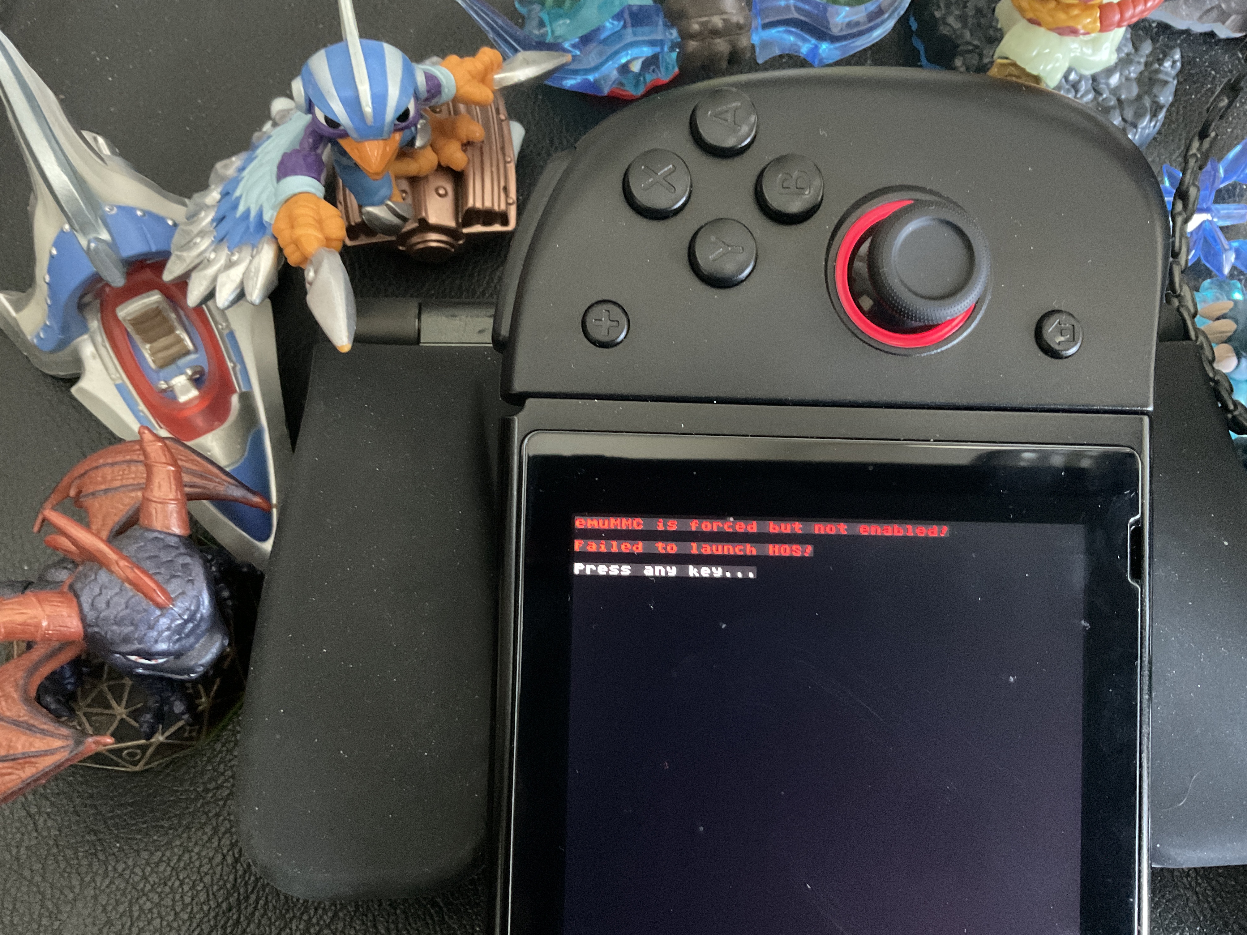

Hello all, I need some help!!
I started with a Switch Lite, chip installed, sxos 3.1.0 and FW 11.0.
All i wanted to do was migrate to Atmosphere and have gotten something screwed up.
Now all i can do is boot into Hekate. I can not even boot into OFW. I have a backup
file that was made before installing sxos. It consists of (boot0.bin boot1.bin full.00.bin-full.07.bin)
What do I need to do to be able to restore my sysnand? Can Hekate restore a sxos File?
1) breathe. Your Sysnand is probably just fine. Besides, you have backups. You’re better off than most.
2) what guide did you use?
3) post your /bootloader/hekate_ipl.ini file

unsure on the /bootloader/hekate_ipl.ini file I formatted my sd card and used STHETIX HATS pack
so now it shows
[config]
autoboot=0
autoboot_list=0
bootwait=0
verification=1
backlight=100
autohosoff=2
autonogc=0
updater2p=1
{--- Custom Firmware ---}
[CFW (SYSNAND)]
fss0=atmosphere/package3
kip1patch=nosigchk
emummc_force_disable=1
icon=bootloader/res/sysnand.bmp
[CFW (EMUMMC)]
kip1patch=nosigchk
emummcforce=1
icon=bootloader/res/emummc.bmp

I’ve not used HATS yet…going to download it and see what all it does.
Can you see the package3 file under the /atmosphere/ directory?
both but go with the HATS (not the combo)
I have only used STHETIX videos for anything ive done
I like sthetix. He’s a good guy and gives a lot to the community.

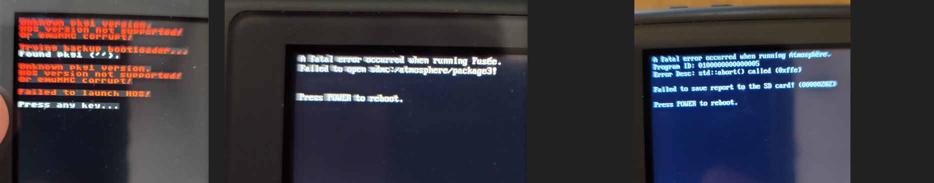

Are you getting an error like this after selecting a Launch option in Hekate?
E: I’m creating a new partition based Emunand using the emuMMC tool in Hekate right now but figured this might be something that could trip someone up.
here are some of the errors i get. but when i try to boot into OFW i just get a black screen.
Well heck…I just dropped it on mine and…it just works. The build is good. It’s gotta be on your end… :-(
I think we need to test your sd card to make sure it’s not failing using h2testw
Then format it FAT32 using rufus
Then download HATS again (just to be sure) and try again…

i will try as soon as i get off work. could I have deleted OFW some how? i tried putting sxos boot back on and i cant even get sxos to come back.
