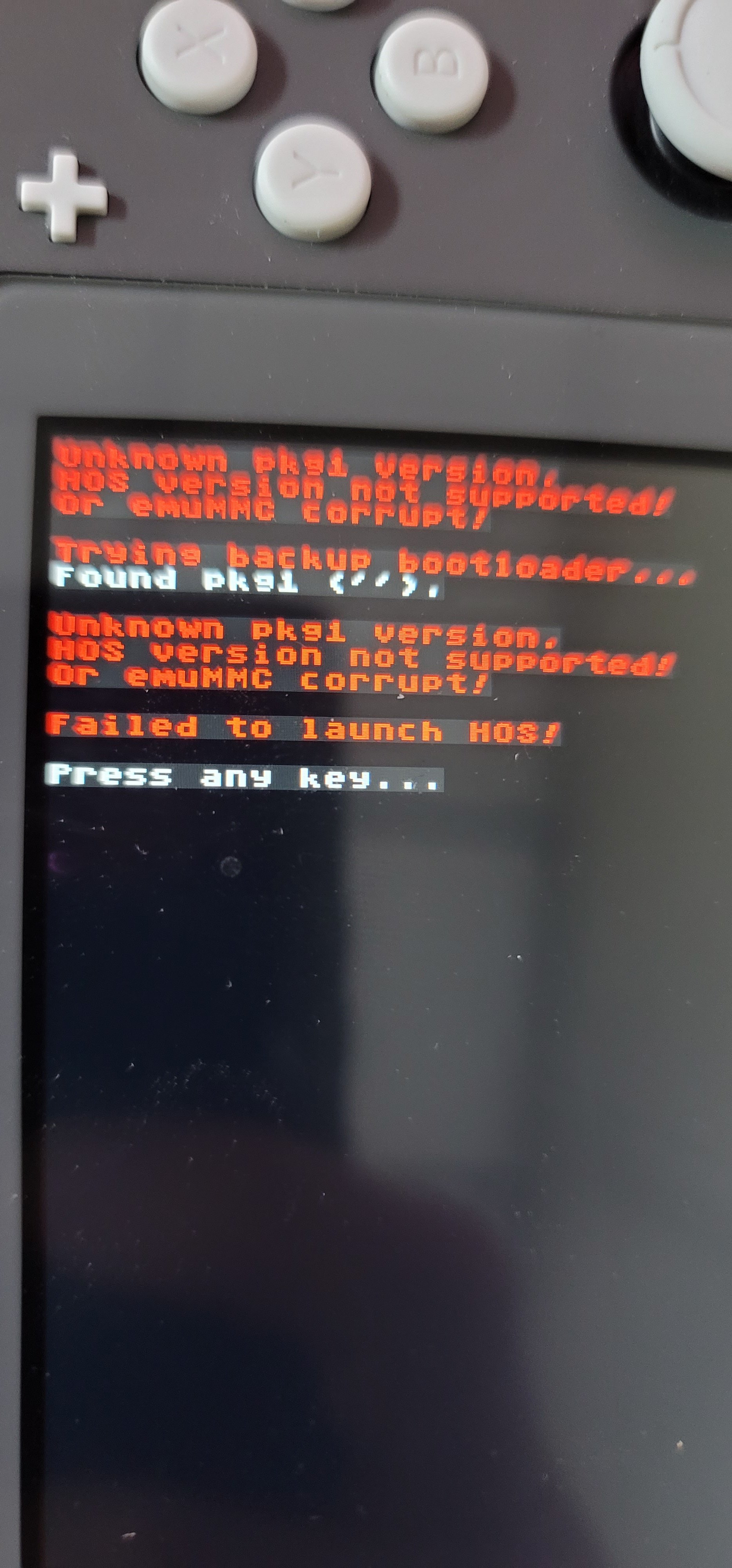

everything went fine when i tried to launch cfw i get this:
edit:
Before we do the steps below let’s take a look at this guide: https://rentry.org/mys8q
We can skip past the fetching of software and just go to the config part.
Specifically this:
Move the following file to the /bootloader/payloads/ folder:
  • fusee.bin
Create a file named hekate_ipl.ini inside of your /bootloader/ folder and paste one of these configurations within the file:
Mariko devices:
[config]
autoboot=0
autoboot_list=0
bootwait=3
backlight=100
autohosoff=0
autonogc=1
updater2p=0
bootprotect=0
[Atmosphere CFW]
payload=bootloader/payloads/fusee.bin
icon=bootloader/res/icon_payload.bmp
[Warmboot Error Fix]
fss0=atmosphere/package3
stock=1
emummc_force_disable=1
icon=bootloader/res/icon_switch.bmp
And rename hekate_ctcaer_x.x.x.bin to payload.bin (this step applies only to SX Core/Lite & SX Pro users).
If this doesn’t work then we’ll move on with the more drastic measures below…
OK…let’s see what we’re dealing with.
Download and inject Lockpick_RCM.bin and dump your keys to your SD card. We will need them for the next step (good to have a secure copy of these anyway.)
Now grab a copy of NxNandManager for your PC, fire up Hekate and mount the emunand we just created. There are instructions for doing this in the README.md.
First and foremost I’d be curious to know what version it reports.
We can to a test restore from your backups to your emunand. Once we get that booting properly we’ll think about next steps for Sysnand.
E: Could also use Emutool to restore your backup to your emunand, but let’s just use NXNandManager for the moment because I want to know the version first.

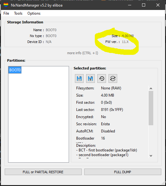

Take a look at your Boot 0 file.
Mine looks like this:
What version is your FW?

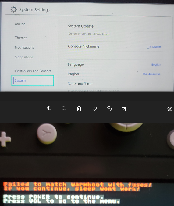

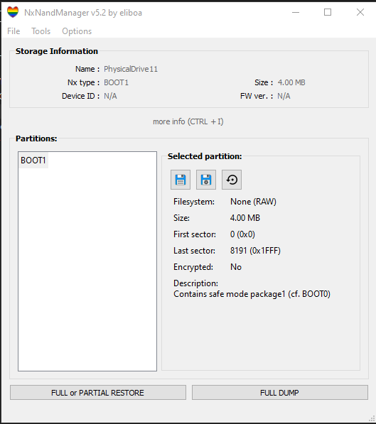

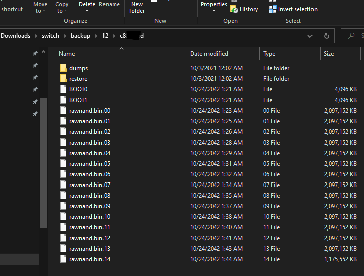

my apologies i got busy at work right before time to go home and was trying to hurry and totally skipped the part about loading the fusee.bin.(also got an error)
then loaded up hekate and connected via usb and if i load the BOOT0 NX showes it as BOOT1 but no matter which one i load up they all say FW ver. :N/A
I also tried:
I want to try booting from fusee.bin directly by replacing the Hekate style boot with this in your hekate_ipl.ini payload=bootloader/payloads/fusee.bin
and no luck!
Well…that ends the gentle part of our adventure.
Lets use NXNandManager to do a full restorefrom your backups to your emunand on your sd card.

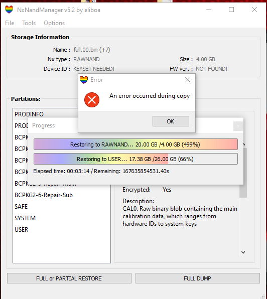

Not sure how to restore the full.00.bin files back to my sd card as emunand and also if i take those files and load them up in nxnandmanager it still says FW ver.: N/A (i am talking about my backup files prehack)
if i put the FULL.00.bin file in NAnandmanager and hit full restore i get this message
That should work. Let me do a recovery real quick on my end.

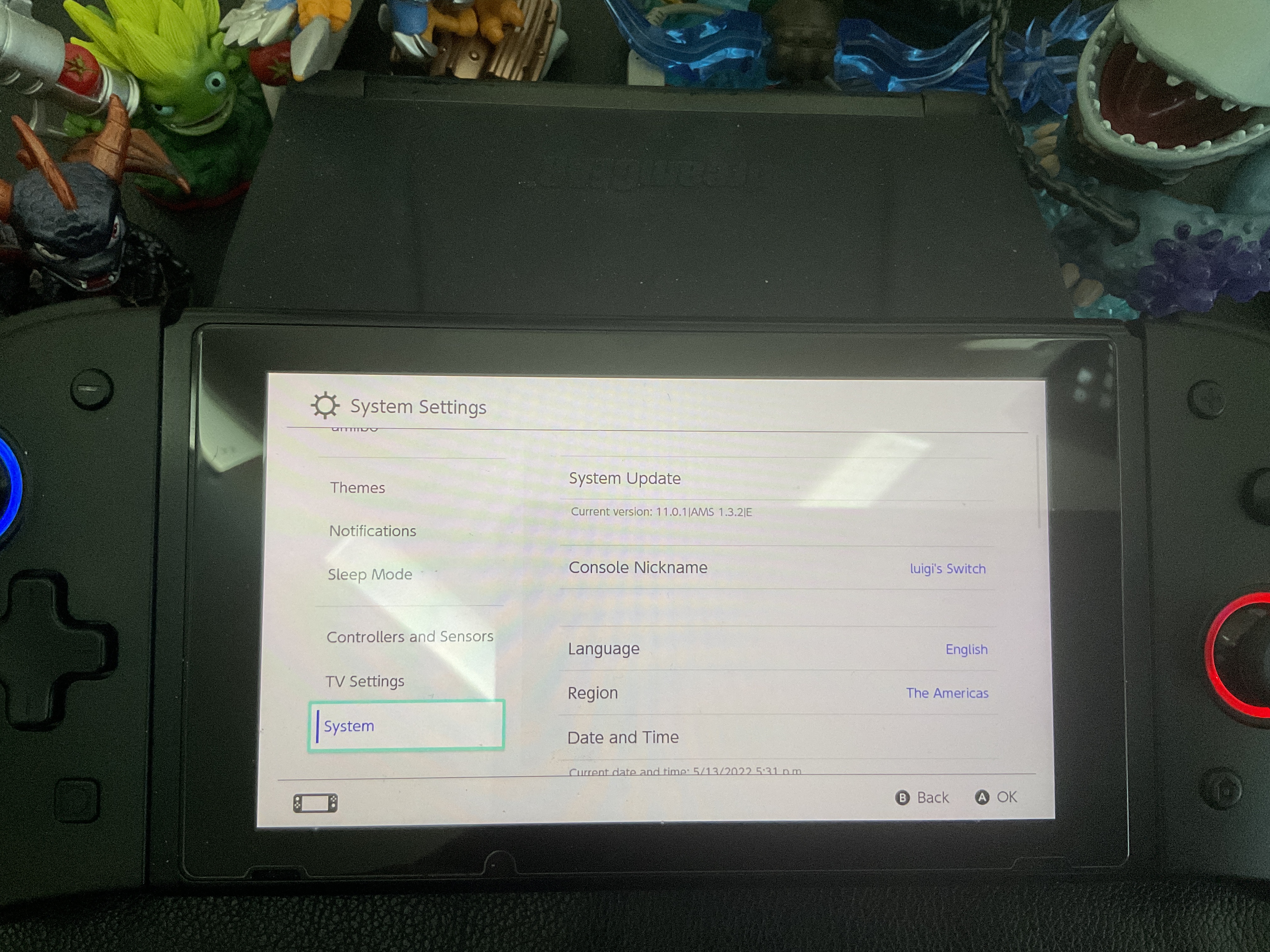

e4: Hekate sees my files based partition I just created from backup. didn’t have to do anything…it just pops right up.
booted right up and shows my ancient 11.0.1 restored emunand running Atmos 1.3.2 (E)munand
@alphajl7 your turn, brotha. Let’s recover an Emunand to sd card. Files or partition…doesn’t matter at the moment. (Actually…you probably have a partition already so you can do a proper partition recovery to sd). We just want something to boot.

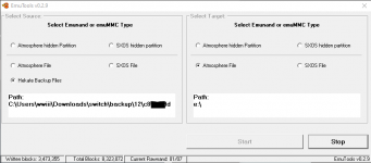

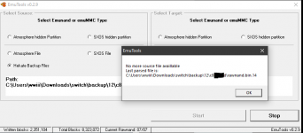

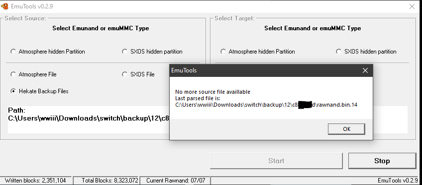

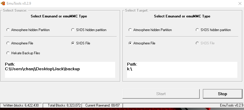

alright running EmuTools now i hope i set it up right and not sure how long it will take giving it doesnt give an ETA
The bottom left gives you a running status of which file it’s on (03/07 for example) and how many blocks it has written. Mine took maybe 15-30 mins (or so?). Based on your time stamp I would guess you should be about done. Fingers crossed over here.

OMG FINALLY still got a error but it has booted into CFW emunand!!!!!!!
binkinator
Garfield’s Fitness Coach
GBAtemp Patron
Mar 29, 2021
6,511
6,155
Nice! we’re almost there. Bad news is you’re probably going to have to restore you Sysnand as well but let’s get you 100% and check everything first!
to fix the warm boot issue you need to add this to the bottom of the /bootloader/helate_ipl.ini file:
stock=1
Boot into it one time and see.
Moving forward use Daybreak rather than Choi to upgrade firmware. Choi can brick your BootX files and we’ll have to recover again.
You‘ll have to search Google for the Darth Sternie Firmware files as we don’t link to files with Ninty IP in them but once you find them and unzip them into a /firmware directory on your sd card, you’ll easily be able to find them with Daybreak.nro and get your firmware up to 14.1.1. You should make another backup of your nand once you get everything upgraded.
anyway…that’s all a bit of work but not really tricky so I’ll leave you to it.
glad you’re sorted.!
