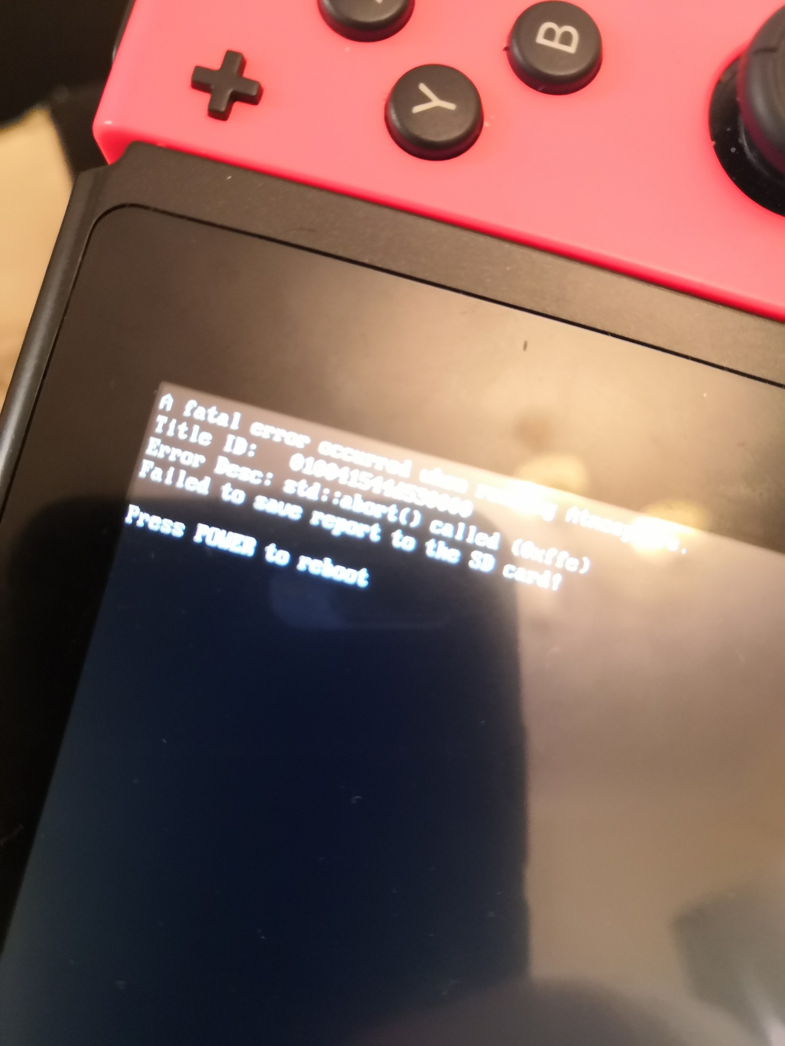

It sounds like you are used to using Hekate to launch Atmosphere directly. Download the latest package that you prefer from SDSetup.
I get this black screen with a message on. Ive replaced the folders with one you linked me up to. How do I fix this error mate? Thanks in advance guys, any help with this will be very much appreciated.
As a matter of troubleshooting, I would follow these steps:
  1. Make sure the SD card is FAT32.
  2. Remove all CFW files/folders from your SD card (that would be folders like /sept/ and /atmosphere/)
  3. Download the latest Atmosphere
  4. Download the latest fusee-primary (next to Atmosphere)
  5. Download these signature patches (for Atmosphere v0.14.1)
  6. Put Atmosphere and the signature patches onto your SD card
  7. Put the SD into your Switch
  8. Enter RCM
  9. Launch Atmosphere using fusee-primary
If you're using an emuMMC, the steps will be different.
