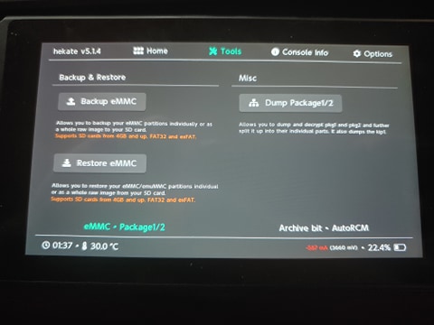

12- To restore my clean 4.1 backup, do I need exFAT sdcard?
I still have my single file dump on exFAT, it's just something I'm wondering if users with split dump can restore it
Do I only need to move partition to restore folder? or everything?
I suppose boot0 and boot1 are also needed, and every other folders?
I'm not sure about file hierarchy to restore from hekate.
Is there a guide to restore?
edit : https://nh-server.github.io/switch-guide/extras/nandrestore/

so I have a first run switch, on latest firmware and still able to use fuse-gelee. anywho following the switch homebrew guide and got to the safety precautions step 5." In Hekate, select ‘eMMC RAW GPP’ " and dont see that option. I performed the backup in the previous step which was only like 4mb each if that matters. can someone help point out what I may be doing wrong?
You mean you're telling me you don't see this screen under Tools -> Backup?

Obviously backup eMMC raw GPP is under backup eMMC...
well thanks for pointing that out, honestly I feel stupid since I followed the path to get the first backup, just missed it when first there and then while being overly cautious and following the guide it just says "In Hekate, select ‘eMMC RAW GPP’ " and I not seeing a path like previous steps thought it was just missing haha.
