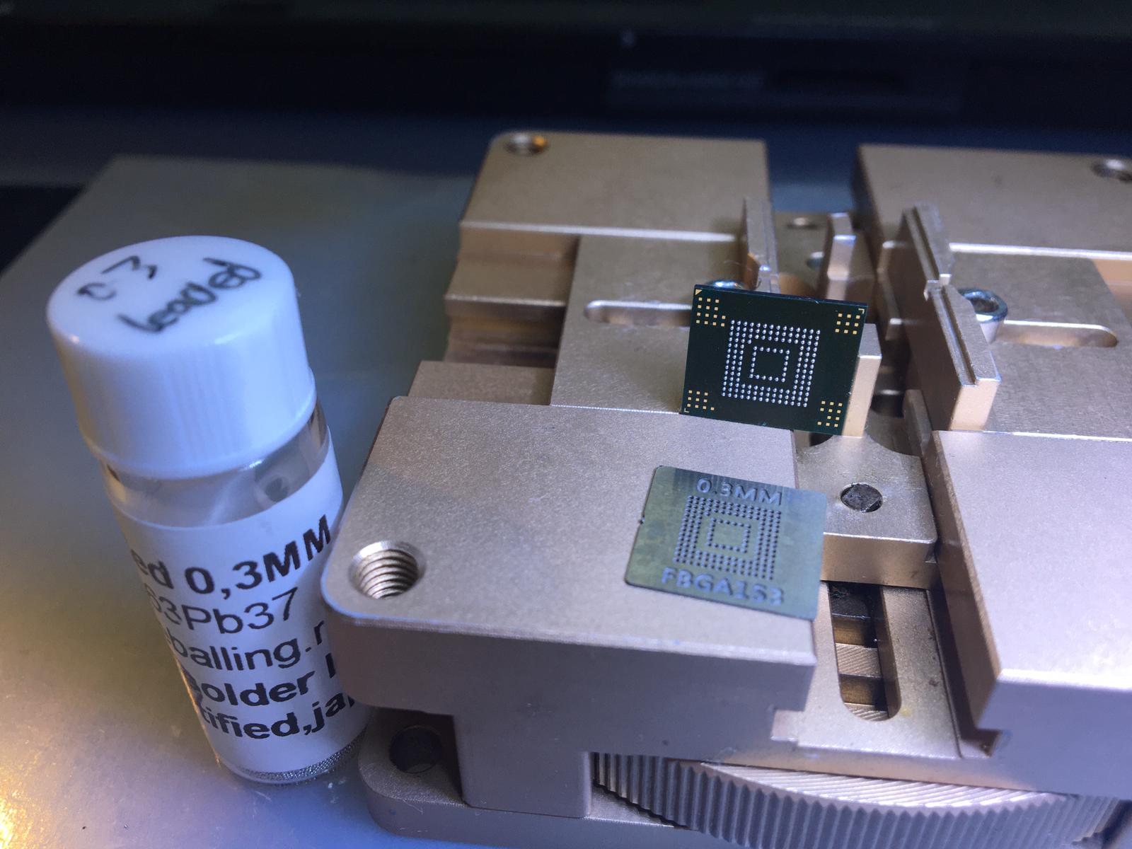

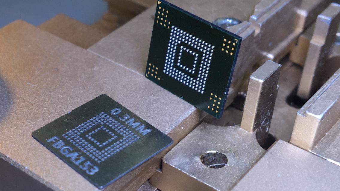

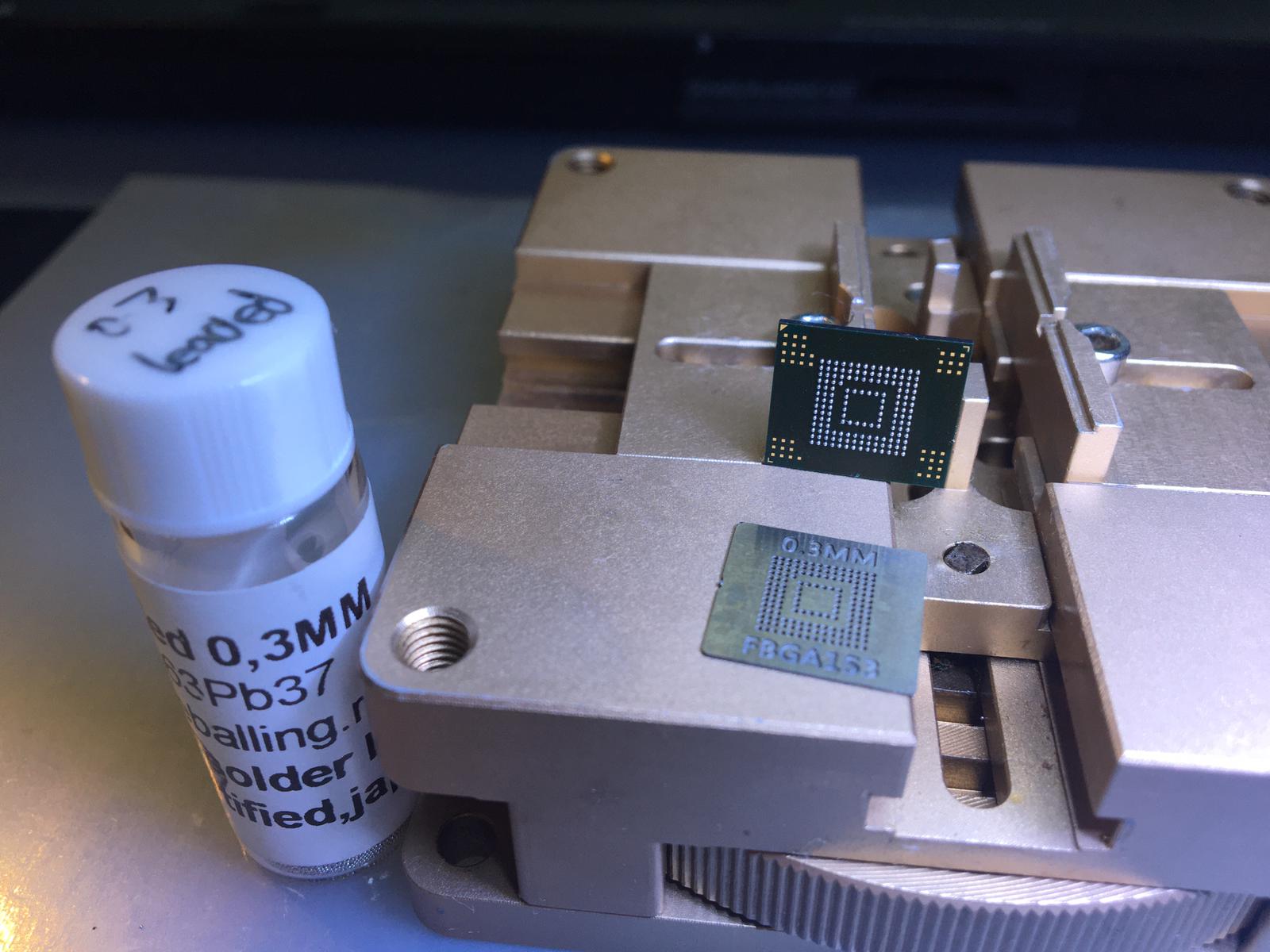

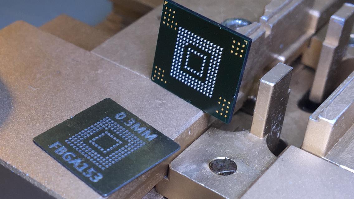

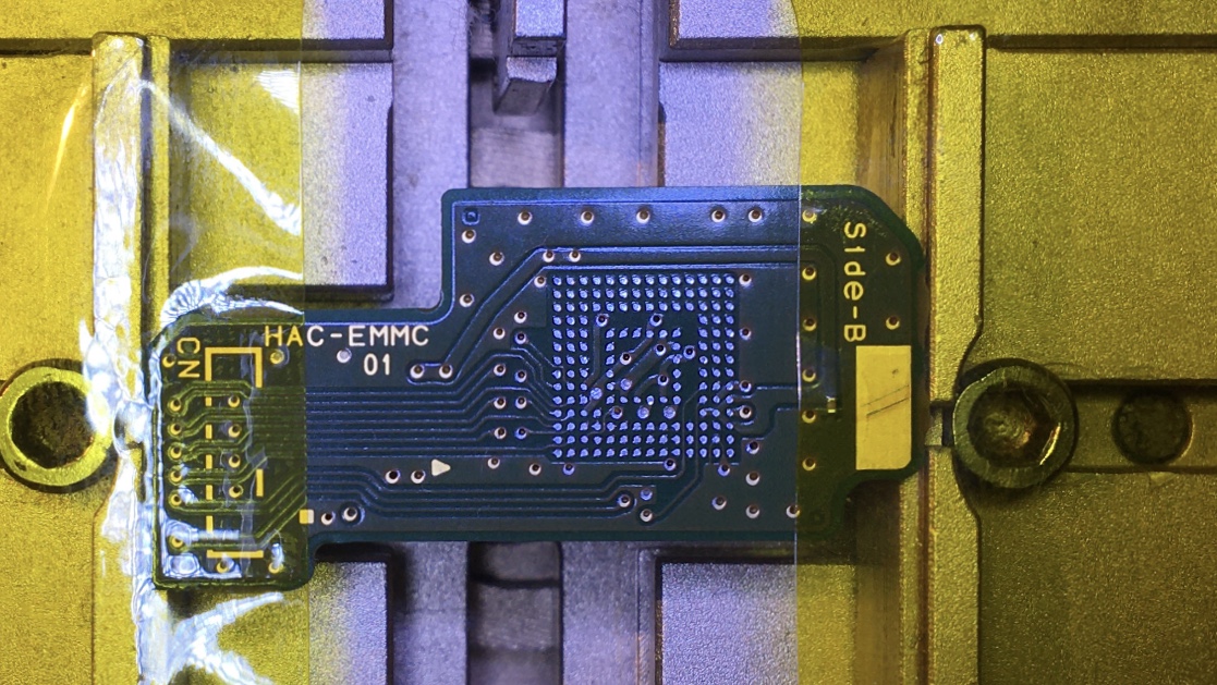

Hi guys
Replaced the 128gb emmc module last week
I'm also ordering 256 modules.

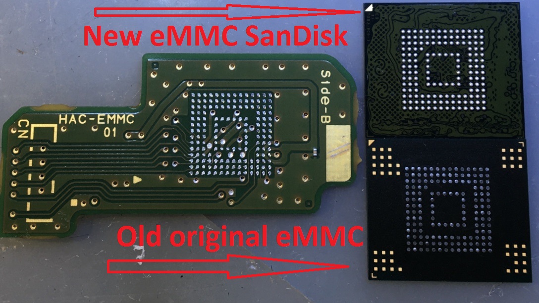

For me being the first time I try a nand upgrade, i first tested with a 32Gb SanDisk eMMC. Now that I have succeeded and everything is ok, i will order 128 GB.

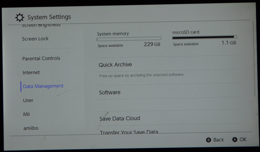

Hi everyone,
Thanks to @pascoej for his guide and @blawar for all his work and Nandpart and to all of the Switch hacking community, I did my nand updgrade today.....
....and it makes me happy :yayswitch:.
