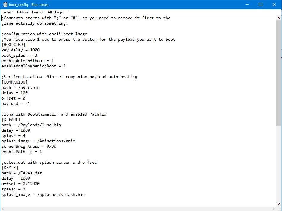

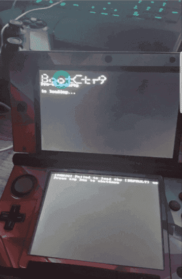

It's the config file that is included in the zip file i didin't touched it (sorry if my english is bad)

Huh what i have to edit in the file ?View attachment 91943
Every entry with [], like [DEFAULT] or [KEY_X] represents one payload you want to load, DEFAULT is the default payload loaded without pressing a key or an undefined key, and KEY_X for defining a payload loaded when key X is pressed.
For every payload you have multiple options you are able to set.
"path" in excample defines the location of your payload, based on the root of you SD-card.
"payload" defines the payload type, while -1 means that it should be automaticly detected.
"splash" defines the type of the play, based on the values defined here.
"splash_image" defines the path of the image or animation file you whant to use before a payload is loaded.
For more informations check out the wiki on github, espacialy this page
Okay but when i config the default correctly it still does the error screen
Was something with the screen buffer parsing, I fixed it but got another problem after that ^^'
