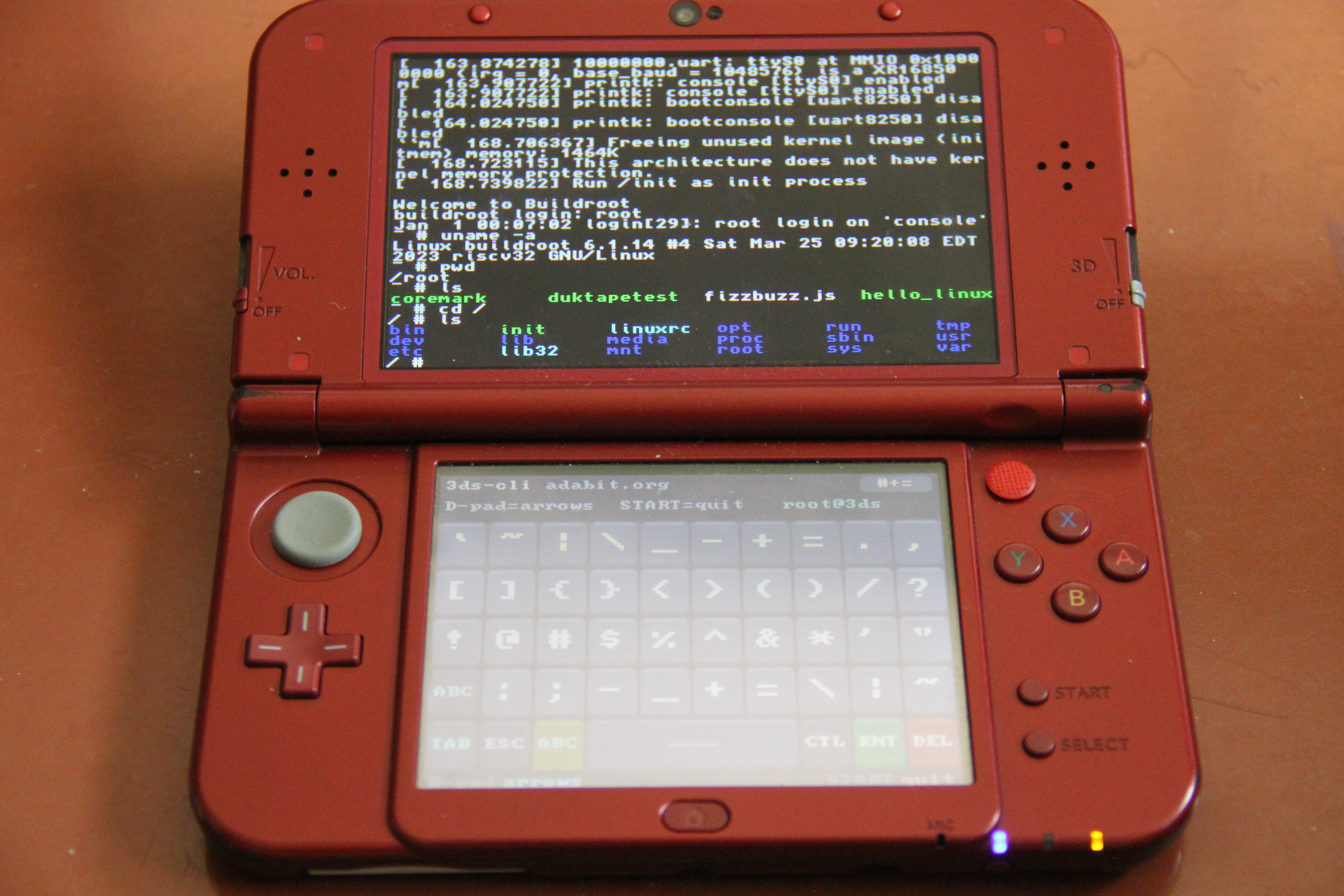

Hi guys!!
I’m releasing 3DS-CLI, a Nintendo 3DS homebrew app that boots a real RISC-V Linux environment inside the normal 3DS Homebrew Launcher. It uses mini-rv32ima by cnlohr as a compact RISC-V CPU emulator, with terminal output on the top screen and a custom touch keyboard on the bottom screen.
Features
  • Boots a RISC-V Linux image on real 3DS hardware through software emulation
  • VT100-style terminal output on the top screen
  • Custom bottom-screen touch keyboard
  • D-pad sends arrow keys
  • Includes a prebuilt Linux image with BusyBox tools, a JavaScript runtime, and CLI Doom
Installation
Universal-Updater:
3DS-CLI can be installed directly from Universal-Updater. Just search for 3DS-CLI and install it from there.
Manual install:
  1. Download 3DS-CLI_Install.zip from the latest GitHub release
  2. Unzip it
  3. Copy 3ds-cli.3dsx and Image into the /3ds/ folder on your SD card
  4. Launch 3DS-CLI from the Homebrew Launcher
  5. Wait for Linux to boot. On my SDXC card and 3ds ll it takes around 172 seconds to reach the login prompt.
  6. Log in as root with a blank password.
Controls
  • Bottom screen: touch keyboard
  • D-pad: arrow keys
  • START: exit back to the Homebrew Launcher
This is mostly a fun technical experiment rather than a fast Linux machine. It is running through software emulation on 3DS hardware, so booting takes a while and performance is limited.

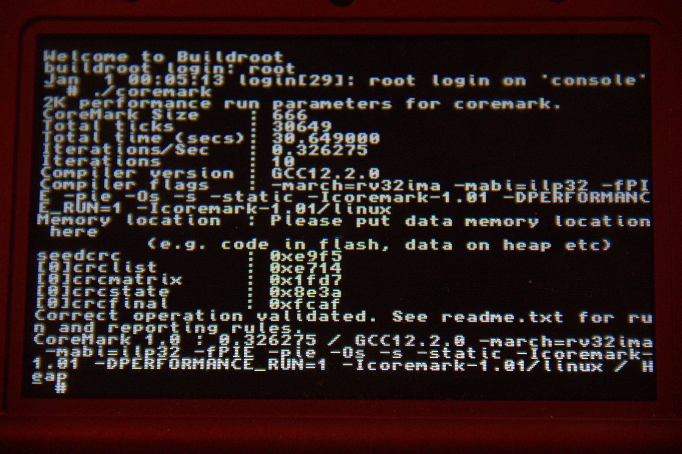

For anyone wondering, here's the coremark results for it haha... actually a bit better than I expected but yeah it sure isn't fast
