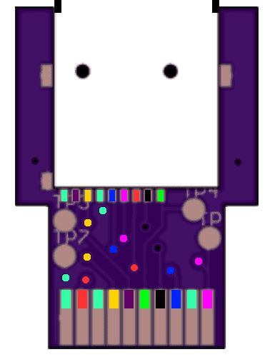

When i install the sd2vita i get nothing, no acces light it apears to be dead. I checked the pins and they have continuity betwen the sd card and the sd2vita. Any help would be apreciated. Thanks.
Ps. Does anyone has the sd2vita pinout?

I have a question about that diagram. Os pin 6 and 9 supposed to be conected? Because a have found other diagrams online that show they are not conected.
