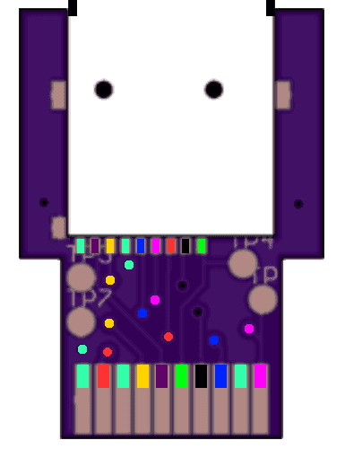

You might want to pad the back of the adapter on the bottom with a piece of electrical tape since it might be making a poor connection. One of my homemade boards is a bit hit and miss and this helps.
I used the picture to check my sd2vita and the last pin on the right wasn't connected. It's a very easy fix I put some more solder it took about 2 minutes. The psvita was stuck on the boot screen and the activity light was flashing continuously. I suppose different things will happen depending on the pin. One piece of advice Its best to check from the connector pad to the pin that makes connection with the sdcard my meter is very pointy so I could do that without problems.
If you mean the last pin on the microSD side then that is a data pin. If it is on the bottom then that is the voltage line.
