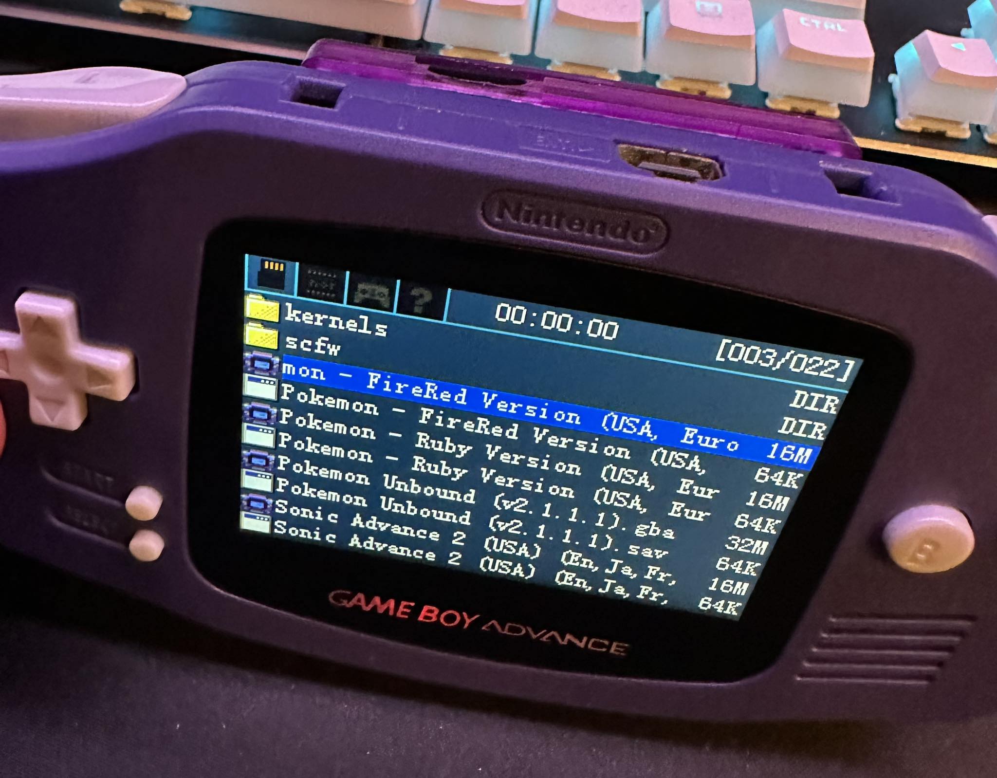

Trying to frankenstein ezflash kernel with scfw code. Progress so far: very slow working fatfs, no roms patching or loading yet.
Looking great! Are the game thumbnails working too? :P
Could you give updating the fatlib SD functions found in this DLDI a try?
https://github.com/ArcheyChen/SuperCard-SDHC-DLDI
Ever since SCFW version 4.2 or so it doesn't work on SuperCard Lite. But that DLDI is able to fat init my SC Lite so I suspect things will work again once some of these custom fw's get around to updating it. ;)
I've love to give this a go on my SC Lite (it's the MicroSD version, not Rumble. ;) )
I have not been able to get any of the custom SCFW repos to compile. I guess because they are using an outdated devkitpro setup for some reason...

I am quite new to gba development. This DLDI requires nds/ndstypes.h, which is not found in my gba environment. Also the CRC code relies on u64. does gba even support that? This code looks like it's meant to work on the NDS.
Edit: after some research, it looks like it was obviously made for the NDS. There are some ASM instructions that are not supported by the gba compiler it seems.
Edit2: I could not get the DLDI to work (I even used some older version that did not include any ASM code and it compiles but still does not run). However, I managed to fix the performance problems that I had with scfw sd driver and it seems to be fast now.

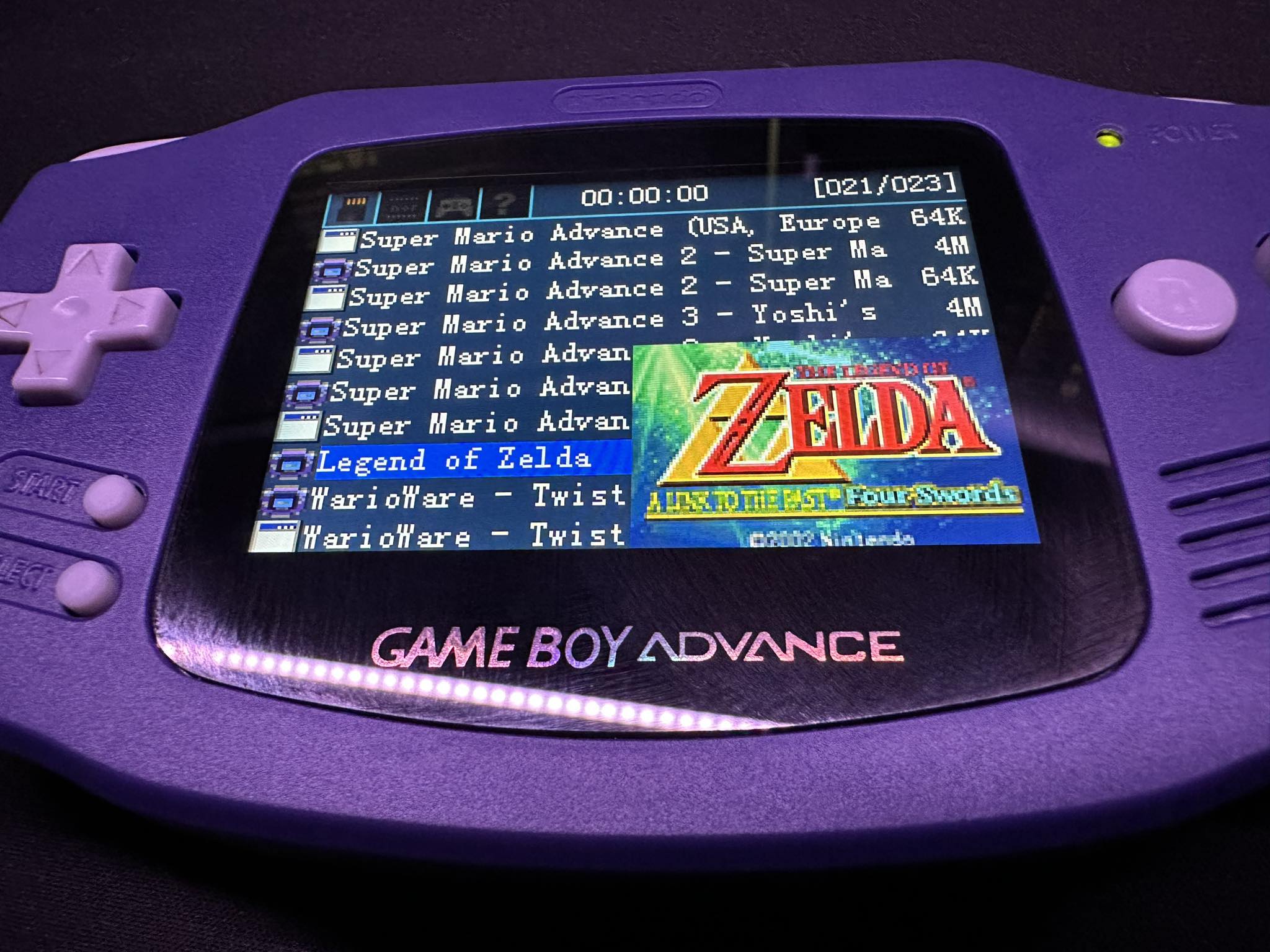

Yes, thumbnails are working as well.
Edit3: I bricked the Supercard SD while flashing new firmware. Unless there's a way to flash the original firmware on it using ch341a or something similar, it's over.

WHAT? That looks SICK
Yeah I hope he gets that up on Github. I'm sure there are others who can help him with the harder stuff like connecting in the SCFW's rom patching/launching stuff to make this all work. Right now i think he's just got the UI working/fatlib sorted out. :D
