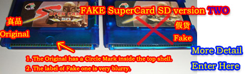

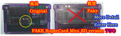

Guess what? There are instances of FAKE and LEGIT versions of the Supercard SD.
https://web.archive.org/web/20070509174322/http://eng.supercard.cn/fake.htm
Here're some snapshots from the archive:
"All Fake SuperCard have common features:
  • The Fake will corrupt your SAVE DATA.
  • The Fake will white screen more often.
  • The Fake is very hard to insert and plug out the Mini SD/SD flash card."
This is incredibly helpful. Never seen anybody mention this, so thanks.
