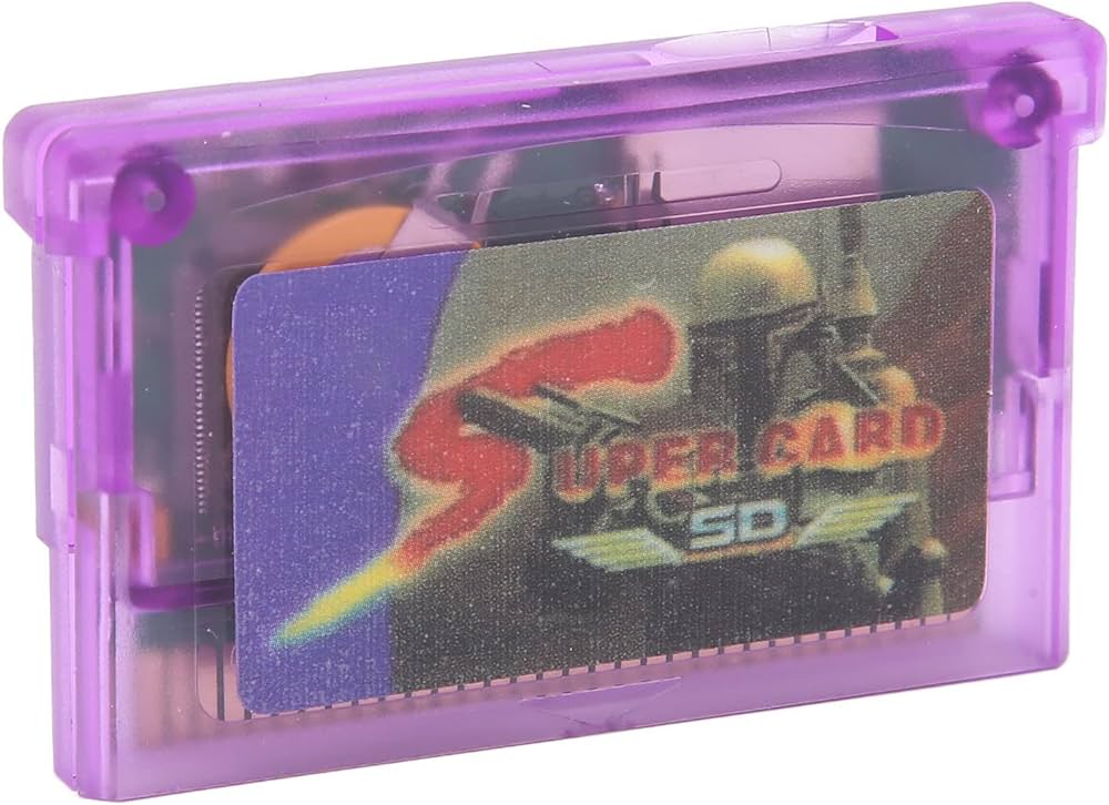

Thank you very much ! Is it possible to have some pictures of the Flash Card this kernel can be used on ?
for example, is this one supported ?
Or this one:
