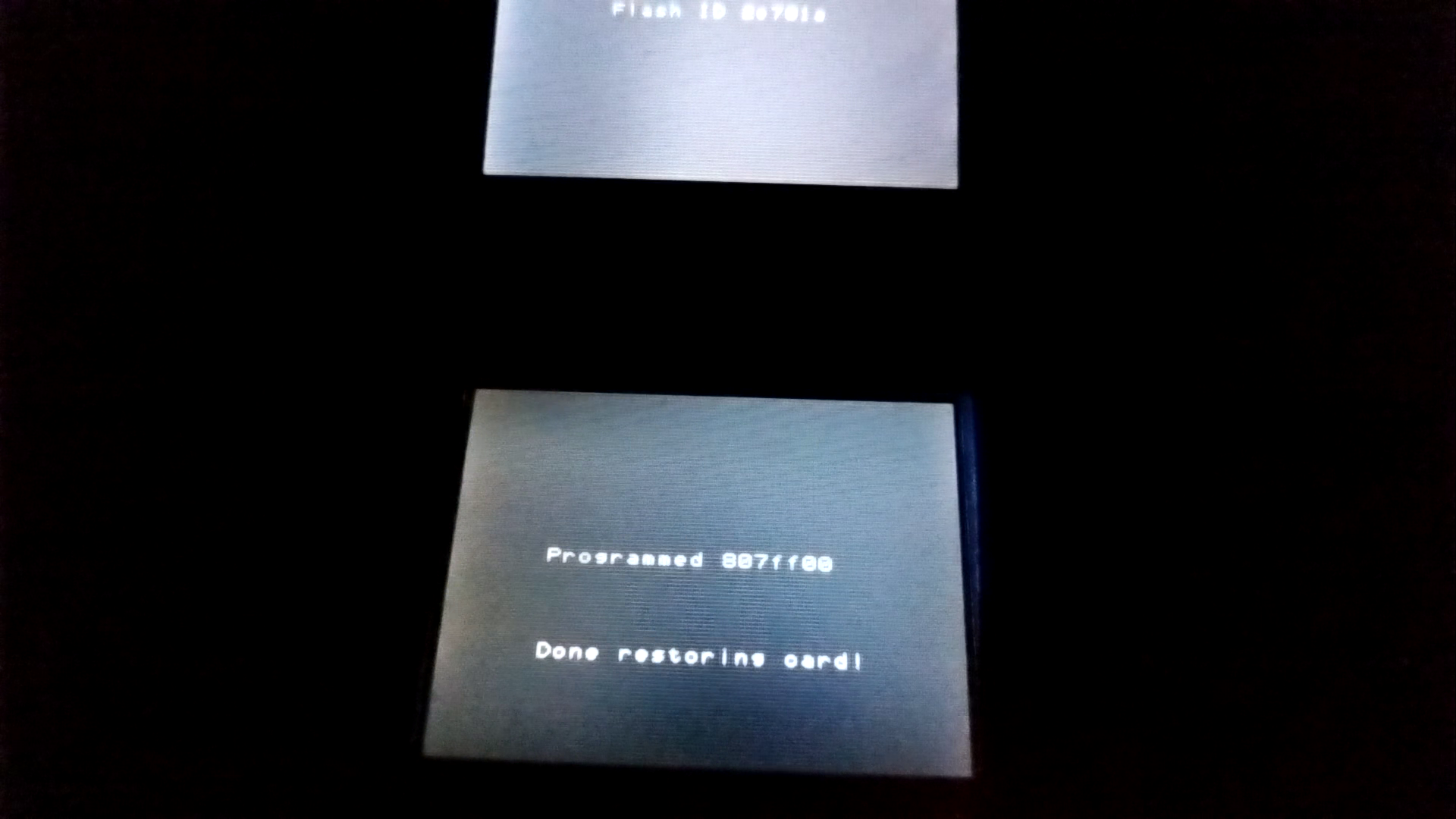

I did try replacing the firmware.frm file with ofw.frm, recompiled the source(from Apache Thunder's version 1.0 from github), and then flashed it afterwards.
Guess what... It WORKED FOR ME! I'm attaching a copy of the modified SCKill ROM that should restore the SuperCard to OFW v1.85. (DO NOT SELECT THE SUPERCARD SDLITE OPTION. That hasn't been tested yet)

I made some modifications on your latest variant of the SCKill and it works for my SuperCard Micro SD variant(non-lite). Haven't tested the lite version as I don't own one :). However, I did try to modify an earlier version from post#282 and that bricked my card. Luckily, moon_rabbit's version of SCKill restored it to SCFW and I'm able to test again :rofl2: (Yes, I like taking risks. I got 4 of these things)
WARNING: Flashing this version of the OFW using the slot-1 method takes about 1 HOUR and 13 minutes. So I do not recommend this method unless you're willing to wait that long.

Yep, I had to flash twice. Twice the charm as they say :lol:.
What I did notice though is that the Flash ID seems to change constantly, but the end-result is achieved at least.
EDIT: Apart from the name of the *.frm file(and replacing the firmware.frm with ofw.frm), I had to modify some of the text prompts to indicate that you're using the SCKill-OFW ROM. Nothing else was changed ;). It should mimic yours similarly where it can try to load the ofw.frm from within ./scfw or from within the root directory. If ofw.frm isn't found in those directories, it should use the ofw.frm I built into it which came from post#191.
First attempt: SUCCESS
Second attempt: SUCCESS

Your assumption is correct, @JORGETECH. That is the same OFW.FRM I used to build the SCKill-OFW ROM on post#303. Just look at my flash sample pics on post#306. I got two cards from different sellers just to verify if it works and they both show different ID's. You can use the ofw.frm file(found on post#191) within the SCFW kernel as that restores stock firmware MUCH FASTER as it takes about 1 to 5 minutes. You only need to use my modified SCKill-OFW.NDS if your flashcart is BRICKED.
