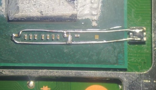

Any one use this solder chip on swich lite? is that work?
since switch lite has a mariko board yes u can do that way or u just solder it like this without the wires.
if u do it the way its in the picture below and u desolder the cap u MUST Isolate the bottom pad with UV Mask
mariko-jpg.360376
