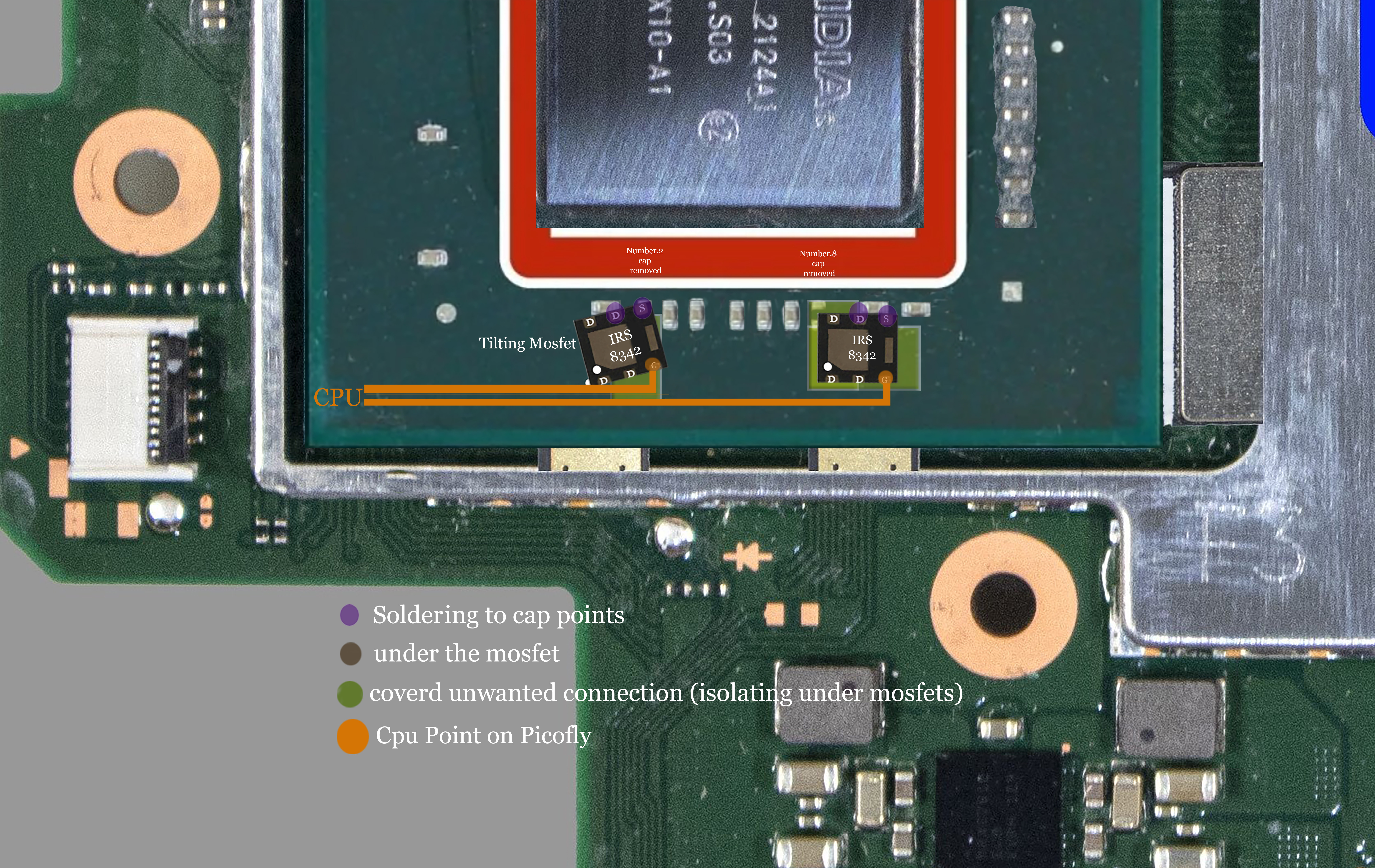

then the picture i created is correct
as the picture bevor yes , just remember when u remove a cap and lay the mosfett on top of a solder pad u need to isolate the pad otherwise some contacts of the mosfet might create a unwanted connection

Using the mosfets, are the capacitors removed because their function is reproduced by the mosfets themselves or for other reasons?

i made this ...i hope helps others
Post picture Edited

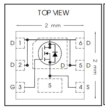

I would say that the gate (G) is the CPU Line. As i understood right, we just shorten the cap to ground. Drain (D) and Source (S) are the pins of the cap. See attachement.
Edit: Also looks like its cap nr.9 that needs to be removed and not 8, at least it looks like it in the picture you send.
i think ur right there was a discussion about it .
well got some help from dear Dee87 and some info this pic that posted before

If you guys don't mind, please remove pictures with wrong wiring.
Reference shoud be the post from rehius / Picofly - a HWFLY switch modchip
with his example on page 78.
