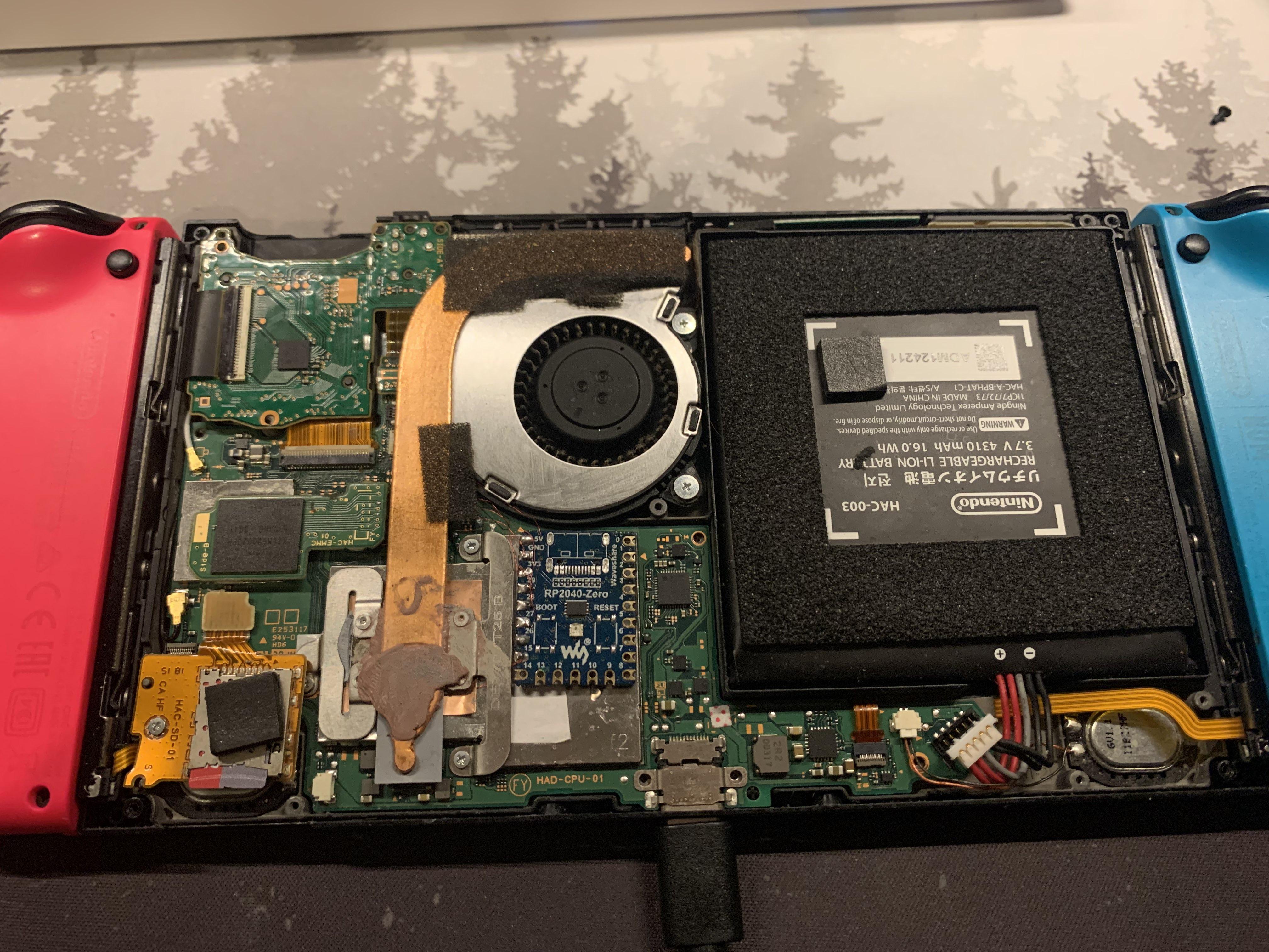

Cleaned up the install today, so far so good. Very impressed.
lookoing good what size resistors did u use?

My guy, change that thermal paste when you have the Switch open. Their thermal paste is terrible..
Oh yeah I definitely will, this is just a random switch i had laying around to experiment with.
50ohm 0201 lol, was a bit too eager to wait for the 47 to arrive but 50ohm seems to work fine.

50ohm, was a bit to eager to wait for the 47 to arrive but 50ohm seems to work fine.
no i mean size like 1206 ,0805
Reactions: Ricky_25
Literally just cause it wouldn't fit otherwise.
I'm not sure I understood correctly.
Are the capacitors removed just for space reasons?
Have I really read and understood this?
Isn't it better to leave them and solder the mosfets with wires leaving the necessary space?
I'd say so too. The caps may not be absolutely needed, but they were put there for a reason.. if you want to keep the connections short, you can put the mosfet a little further down and just use two very short wires to it.
Reactions: Ricky_25 and Dee87
Just removed for space reasons
U can leave them if u want to
