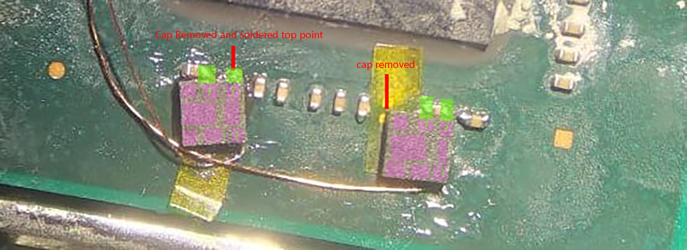

not sure if its the same issue
but i had to install a second mosfet on my mariko because i got the cyan color there where a few other people who had to install one also ,
most of the people us the flat cable from the hwfly thats why they mostly dont expierence this issue there are 2 mosfets on the hwfly cable
double_mos-jpg.360782
Ah I only have 1 mosfet installed, will install a 2nd one and report back, thanks!
Yup, this was the issue. Second mosfet added and it now glitches and boots hekate on power up. Thanks for the advice! appreciate it

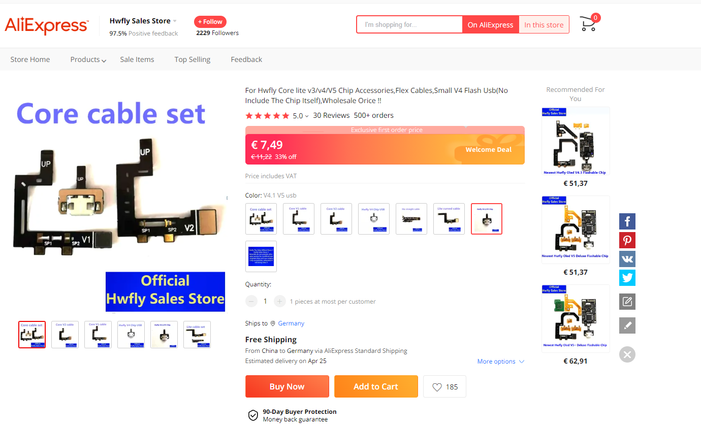

The flex cable seems to be easier to install, or did I understand that wrong?
I think I'd prefer using the cable if that's the case.
Can you maybe tell me where I can find these (or maybe link me one compatible with the OLED and one for the Lite?`)
Only place I know of is aliexpress, so you're looking at 10+ days of wait time.
Reactions: Ricky_25
Well, the Aliexpress pages are too cryptic for me :huh:
They use a lot of buzz words and photos of a product that "may" fit my needs, but I still don't know which I can buy for my Switch Lite and which I can buy for my OLED Switch for sure :S
Could you send me a link to the ones I will need for my to Switches? That'd be awesome!
Also somehow the Guide doesn't really seem to "Guide" me through the process. It for example doesn't show me where to use the 47ohm resistors... Or am I blind?
The resistors are mounted on the rpi2040. Look at the images/solder points bottom image.
Can't send you a link, since I don't use any flex cables myself. But "core" is the v1/v2 models, you want oled and lite.
it shows u where to use them and that is on the rp zero
for lite and oled u need v2 cables and for oled u also need a dat 0 connector but not all of them are reliable should go with the 4 anchor one or reball ur emmc and make a straight connection to ur dat0 point

Can anyone explain exact points that we should solder to double mosfet mode for Oled
mosfet pins
Check my post above......
well i checked but there is no clear understanding what exactly should i solder
you removed 2 cap i understand that much from you're pic
but i dont get mosfet points at all
the purple color in this pic are under mosfet points (my understanding if im wrong tell to fix for others) , greens are points that soldered , qustion marks are what pionts exactly

well i mean it should be self explaining , u solder the caps to the solder point on the mosfet like in the picture
u dont have to remove the cap on the right mosfet if u set the mosfet so it fits
u showed the connection point in purple from the mosfet u connect them to the green point on the caps it shouldnt be that hard picture is self explaining
Reactions: Ricky_25
then the picture i created is correct
