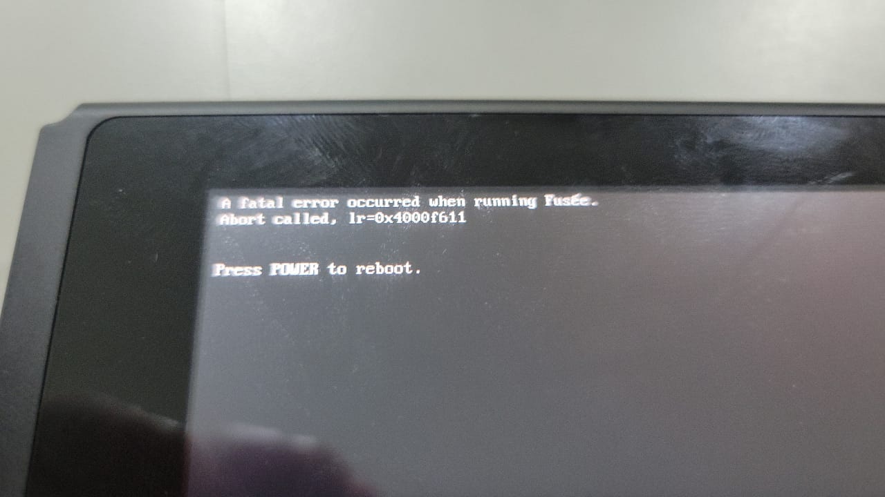

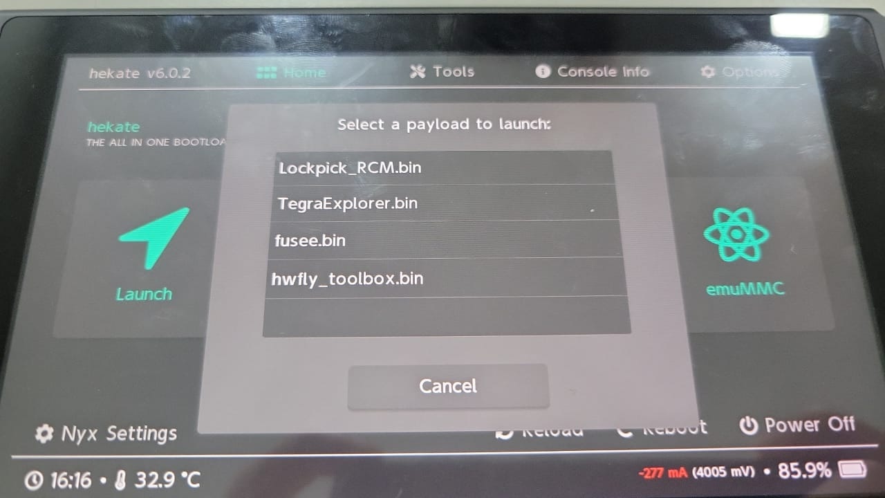

I'm sorry to ask this but I can't find a way to run atmosphere. I'm on 16.0.1 and running hekate v6.0.2 with no problem. I installed HATS 16.0.1 on the microsd but I don't see the fuse.bin in the payloads. I downloaded atmosphere from its developers' page and copied the fuse.bin to the bootloader/payloads folder but when I run it it gives me a error... I really don't know what else to do. Any ideas?
